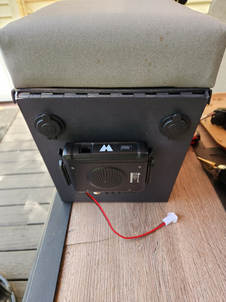

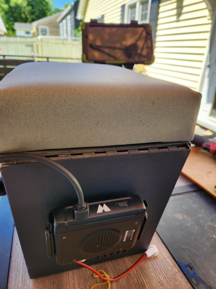

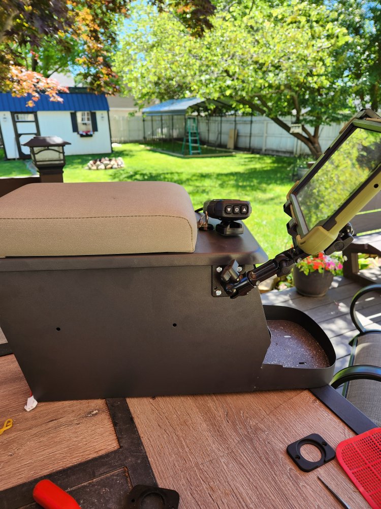

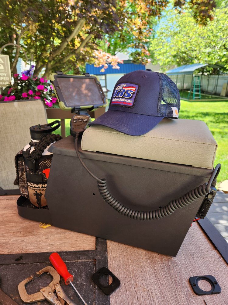

Pulled out the new Smittybilt Ranger console and started moddin it.
Yep... I also made myself a 20th anniversary hat just in time for the 25th anniversary. Better late then never I suppose.
The console is still in WIP...
Red LED lights to illuminate the foot wells and the inside... also two more power ports then wire it up.

Pulled out the new Smitty Built Ranger console and started moddin it.
View attachment 112168View attachment 112169

They're still available. Steel construction. Made for a Jeep Wrangler/CJ/XJ I believe.
I'm gonna throw in a disclaimer... well two of them.
First... I haven't actually fit this one into position. Because I haven't modified my 60/40 seat yet. Measurements say it gonna fit... but a pretty tight fit between the seats. The armrest pad on this console also sits about one inch lower then the factory fold down armrest. I may end up shimming it up a little with some one inch square tube. The 1st and 2nd Gen truck cab are a little narrower and I don't think this console will fit. 3rd Gen forward will fit but tight.
Second thing... I bought a Tuffy security console for my Bronco II. The quality and workmanship is far better on the Tuffy then the Smittybilt unit. However the Tuffy is about $300. I bought my Smittybilt on Amazon as a returned unit for just less then $100.

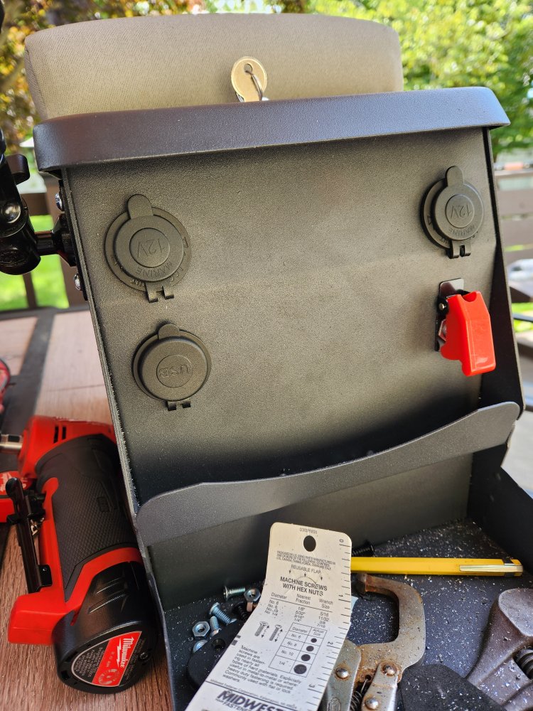

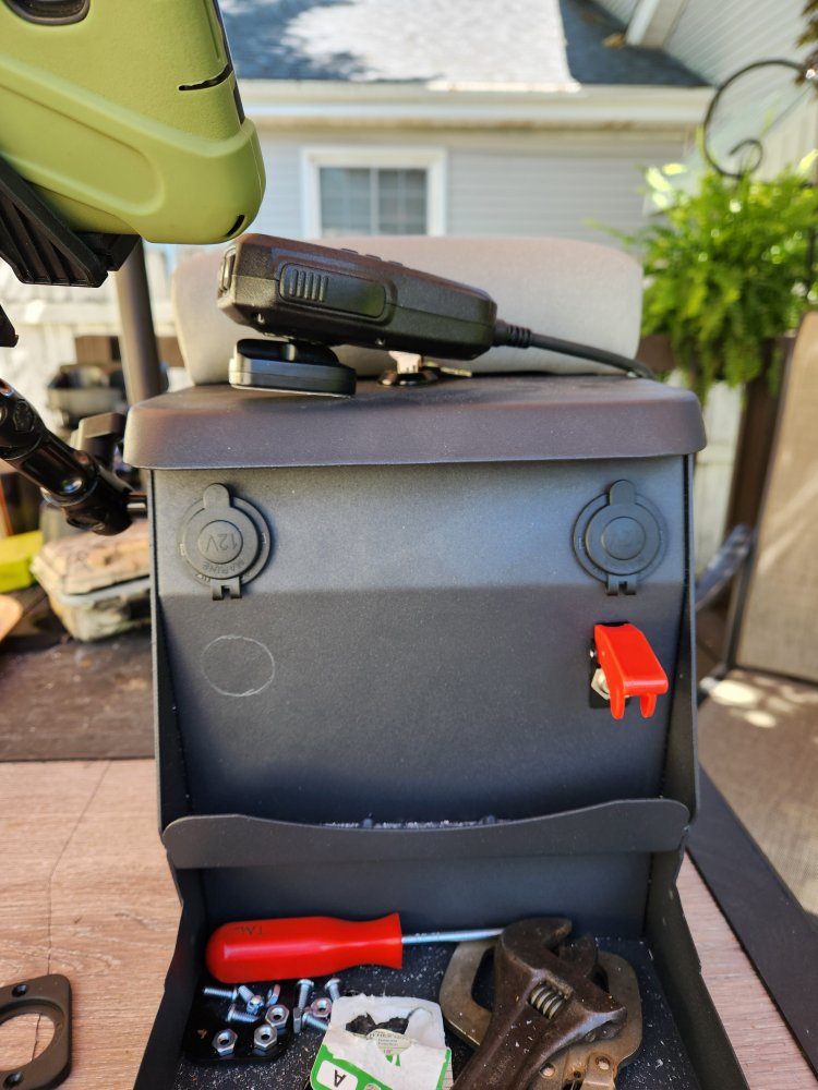

So... I ended up adding two more 12v outlets... and a USB port.
I have four red LED lights somewhere. I sure can't find them though. I give up and ordered 4 more...
But yeah... that's a lot of outlets. With the factory three outlets that came on the truck... I now have 9. WTH do I need 9 outlets for... sheesh. To damn many gadgets these days.
I sure hate the "web" of tangled up gadget cords hanging from the dash outlets. Hoping this will help with that mess... but I have my doubts.

No sir...
One single fused 20amp circuit on a switch. With switch off... no power to the console.
