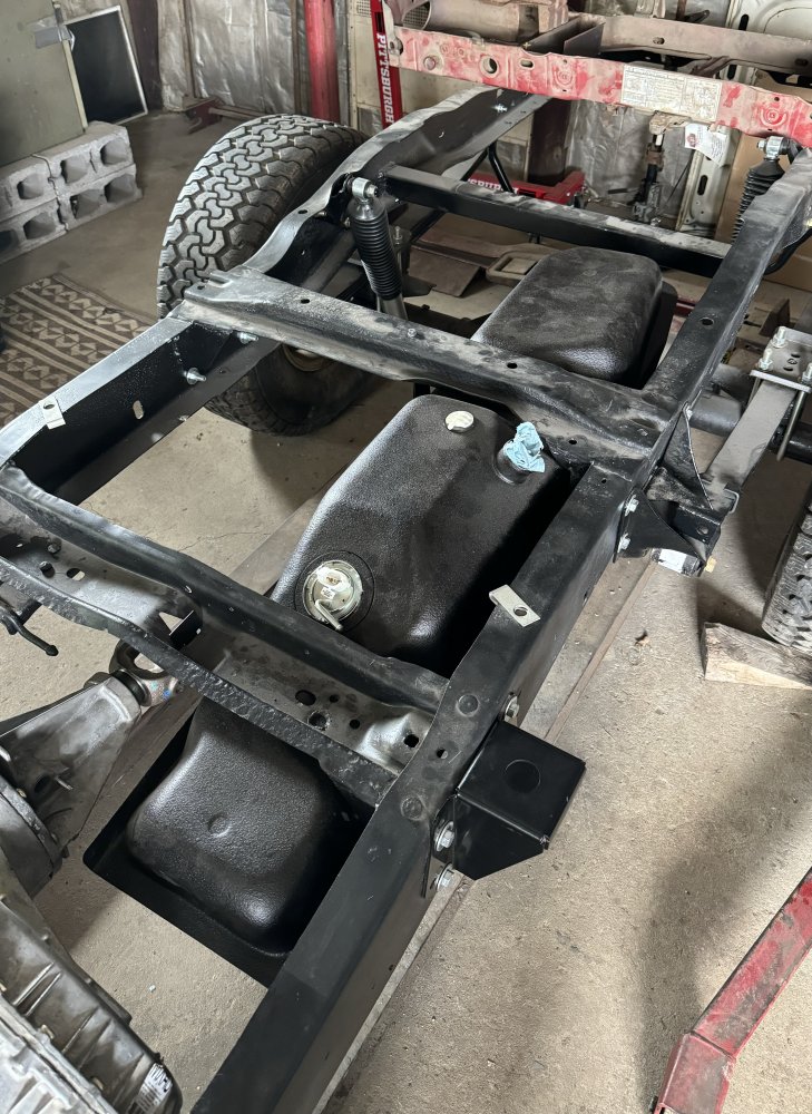

Thank you! 3 coats of por15 (1 being the UV top coat) - still considering undercoating the whole truck with fluid film in the final assembly but weary of the tacky consistency since it doesn't set up or harden. Anybody have experience with fluid film?
