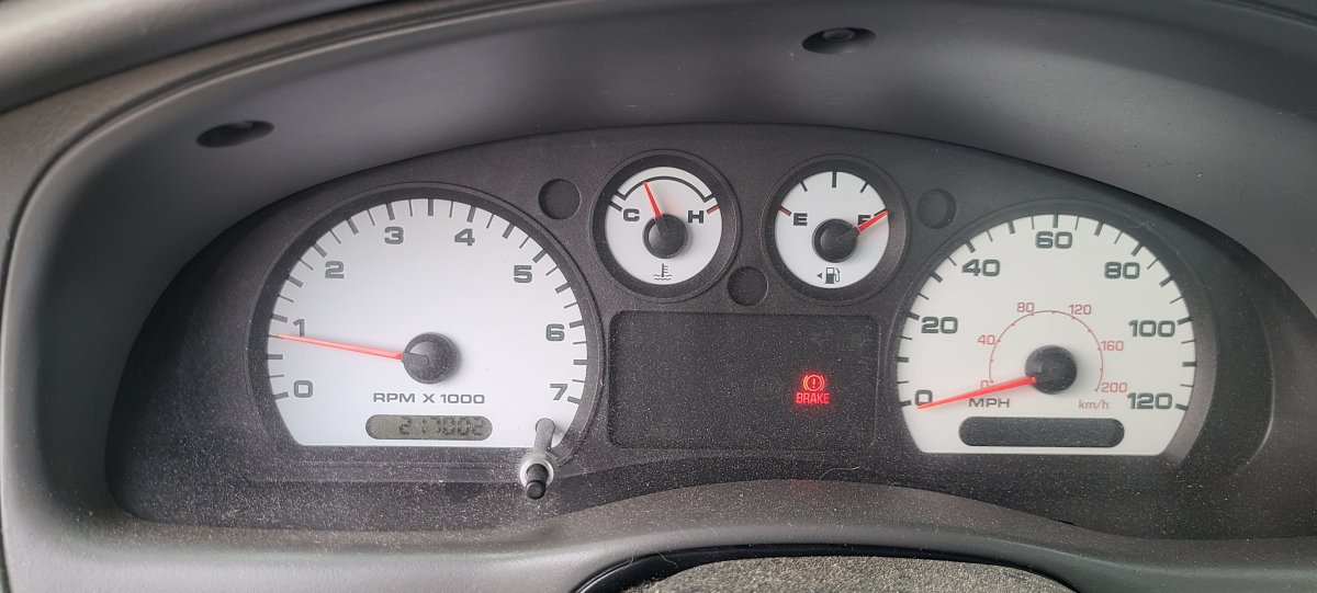

Drove some more
New brake pads on the drivers side to match the passenger side. Still going to the left when braking but not as bad

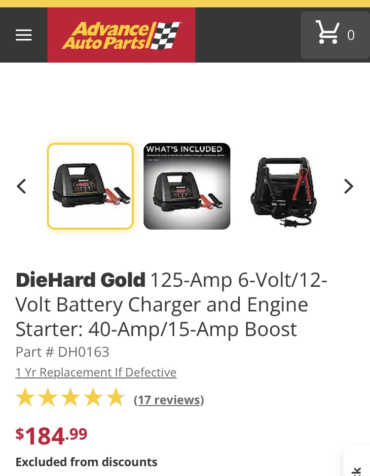

I initially assumed it was my cheap Chinese trickle charger, but then I tried a Battery Changer Jr., and most recently I had it on a very good diehard smart charger/maintainer;
Same result, it will drop to about 65% over a week or two.
