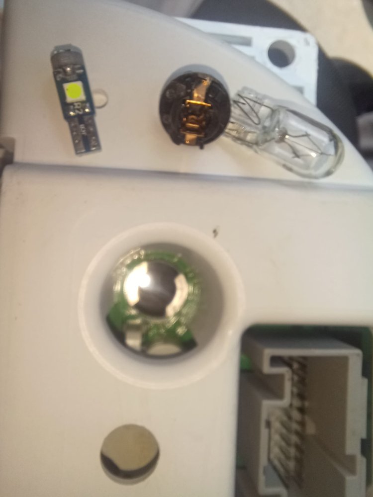

Pulled apart some of the dash in order to get the instrument panel out with plans to change the cluster lights. Some time ago I changed the bulbs for LEDs and regretted it ever since. LEDs are too bright and turning them to dimmest setting caused radio to go dark. Ordered 194 bulbs as that's what I was told I needed. Won't fit sockets. So, what bulbs do I need? What did you do to your Ranger today? (Part Deux!)What did you do to your Ranger today? (Part Deux!)

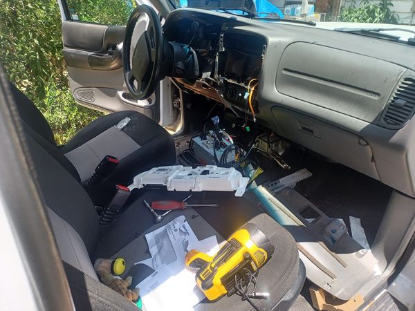

Pulled apart some of the dash in order to get the instrument panel out with plans to change the cluster lights. Some time ago I changed the bulbs for LEDs and regretted it ever since. LEDs are too bright and turning them to dimmest setting caused radio to go dark. Ordered 194 bulbs as that's what I was told I needed. Won't fit sockets. So, what bulbs do I need?View attachment 110936View attachment 110937
I went through the same exercise on my 97. I used the LEDs, and hated the way they looked, and then I replaced them back with the old fashioned incandescent bulbs.
When I got the truck, it had 305,000 miles on it, and I think they must’ve been the original bulbs, because there was only one in the cluster that lit up, the rest of the cluster was dark, the heating and air control was dark, etc. when I got them all to light up, it was like driving a new truck!
My bulbs were T8 for the warning lights, and T10 for the back lighting. I think the 2011 is the same, but just Google it. They’re the glass bubble bulb without a brass base, with the two folded up wires for contacts on the flat end.
I bought a couple of boxes of 10 each on eBay, now considered old obsolete stock, and I think I paid less than $20 for all four boxes. A lot cheaper than the stores, but you have to wait a week to get them.
You need Toshiba V-2 bulb/socket assemblies, which twist out of the instrument cluster to remove and twist in to make contact when installing. I had the same issue on my 2011 and wrote about it here. Some of these Toshiba assemblies allow the bulb to be replaced separately, but the ones in the truck and the replacements did not. You'll bust the bulb trying to get it out of the twist-in assembly.
Several other vehicles around the same vintage take the Toshiba V-2 bulb/socket assembly. I got 10 off eBay pretty cheaply and replaced all in the cluster at the same time, including the turn signal and high-beam indicators.
Ford changed from 194 bulbs to V-2 assemblies sometime around 2006 or 2007.
