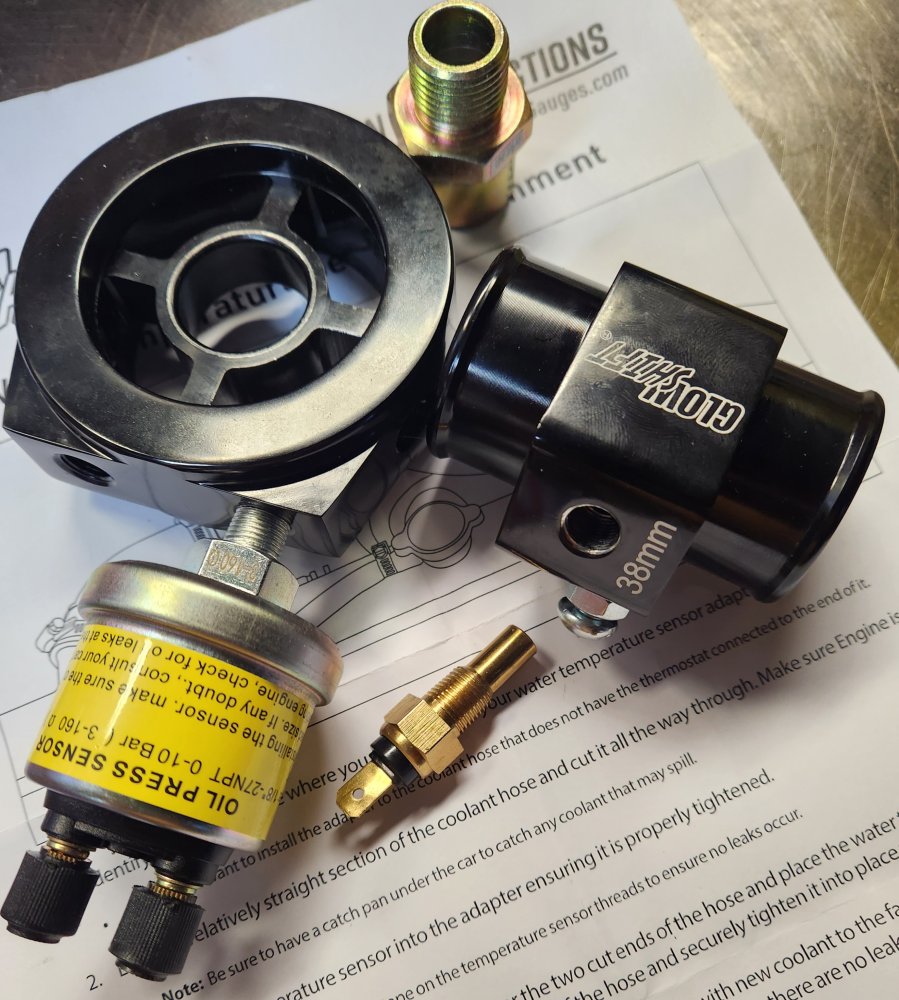

Should I put my aftermarket pressure sender before or after the filter? I have a sandwich plate coming with the gauge, that would allow me to take the pressure reading right off of the pump, before the oil flows through the filter. Of course, filters have some degree of restriction, and thus there is a pressure drop after the filter. Is it enough of a drop to warrant moving the sender after the filter, i.e. where the OEM sensor goes in the main oil galley.
(My thinking is that I want the reading closest to what the bearings, tensioners, etc are seeing, not necessarily the (possinly higher) pressure right off the pump)

One comment on the sandwich adaptor. I use one with a glow shift pressure gauge and sender. If I remember correctly... the sender gets a 12 volt supply and a signal circuit back to the gauge. If your set up requires a ground at the sendet... be sure to run an 1/8 pipe tape in the hole you plan to use to clear out the powder coat from the threads. Also ensure the adaptor center nut has a clean area to tighten the adapter to the oil filter flange. This will ensure your adaptor and sender grounds properly to the engine.
If you end up using their coolant hose adaptor for temp... clean those threads too and then drill and tap the housing for a ground wire.

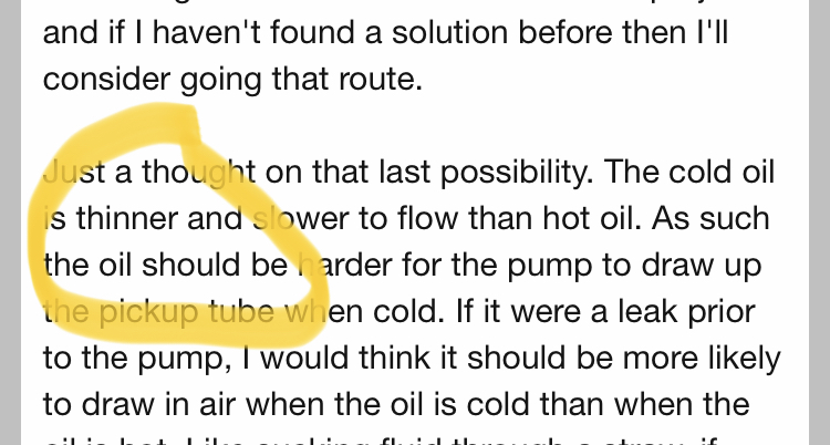

Just a thought on that last possibility. The cold oil is thinner and slower to flow than hot oil. As such the oil should be harder for the pump to draw up the pickup tube when cold. If it were a leak prior to the pump, I would think it should be more likely to draw in air when the oil is cold than when the oil is hot. Like sucking fluid through a straw, if there is a crack above the fluid its likely to pull air in through that crack, the thicker the fluid the more likely it is to draw in air. A better analogy might be the bypass valves they install on cold air intakes in cars, in case they drive through a deep puddle and the filter gets submerged.

First, no criticism, but a lot of what we write here people will refer to in the future. I think you have a typo on “thinner“ versus “thicker.

At one specific point on the thicker versus thinner oil. Fundamentally, we are both correct, but “fluid dynamics” is one of the most complex concepts in engineering. Why? Because a lot of stuff that happens defies basic common sense. Like when the space shuttle exploded, a simple test is worth 1000 engineering calculations and postulations.
Simplified, yes, when the oil is thicker, you are correct it may suck in more air, but then it is pushing that thick oil through the filter and pushing it through the engine. Fluids are incompressible (typically), but gases (air) compress easily. The pump has to be able to pump the thick oil through all the little nooks and crannies and ports in that engine. When it’s cool and thick, if a little air gets in, it’s not inconceivable that that air would get compressed to the point where it would not show up on the gauge. As the oil heats up and gets thinner, whether or not more or less air gets in the system, the oil will flow much more easily, it won’t compress any trapped air to the same degree, and that’s where the flicker in the gauge can come in after the oil is thinner.

I have a tee assembled, yes, but I’m not sure if it will fit or not. There’s not much space between the sender and the back of the compressor, I may need a riser.
I ordered the same sandwich adapter from glowshift, purely because I don’t know if I’ll use the tee yet. If I don’t, I can return the adapter.
I also ordered their coolant temp adapter, and will keep your tips in mind when I install it.
I just figured I’d ask about the location, as the factory sender tee would place it after the filter, and the sandwich plate is before the filter. But honestly, like you said, at the flow rates an oil pump makes, the difference is probably negligible.

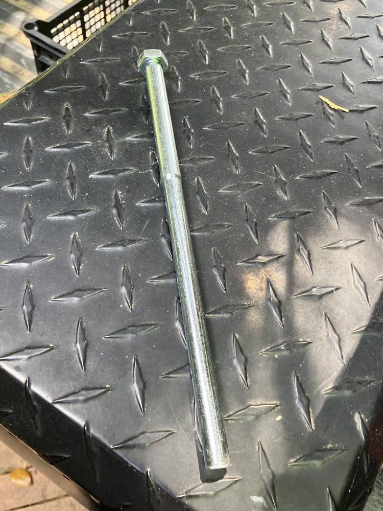

A picture is worth a 1000 words. I got this out of a box of 1/2x10 zinc coated steel bolts at Home Depot.
It’s perfect, except for, oh, wait, look at this, they never threaded the bolt. I actually have a collection of this kind of stuff back from when I worked at the hardware store as a kid. Sockets, round inside, that never had the hex put in, an SK wrench that is round on the box end, a couple nuts with no holes in them, and all kinds of smooth bolts like this.
Never worked the hardware store, but have handled a lot of aircraft grade hardware in my line of work. Seen bunch of this kind of stuff over the years. One of the most annoying things I've encountered was an unthreaded nut. Grabbed the amount I needed off benchstock. The nuts screwed onto fasteners inside a blind hole. A few went on great, then I just couldn't get one started. Tried and tried, but it wouldn't start. I assumed I just wasn't getting it lined up right, not an uncommon problem when working in a spot like that. Turned out there were no threads. I started checking them after that.
