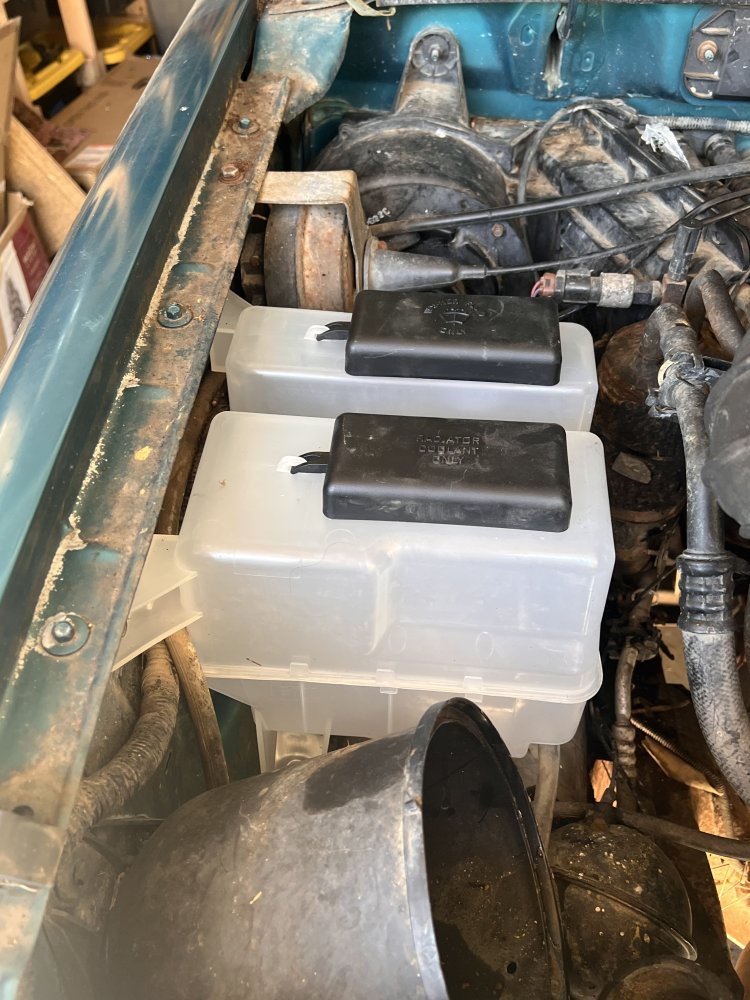

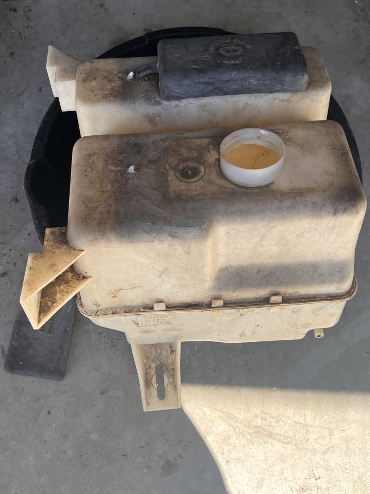

Also switched out the coolant overflow/wiper fluid tank; minor thing but it bothered me so much to have that old dirty one there.
