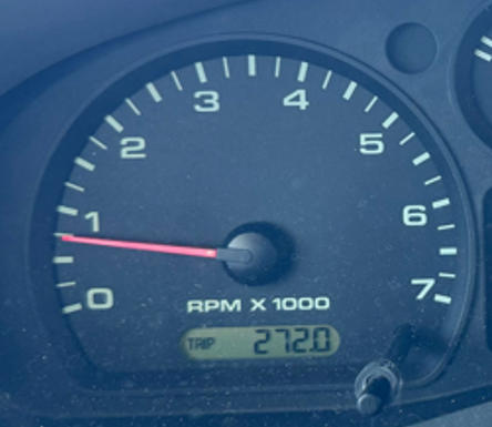

It has been almost a year since I last tried to set a personal gas mileage record, but now that I am almost always on the highway I tried again, this is the absolute most I could get out of my little old ranger :LOL:. 272 miles @ 16.6 MPG.
