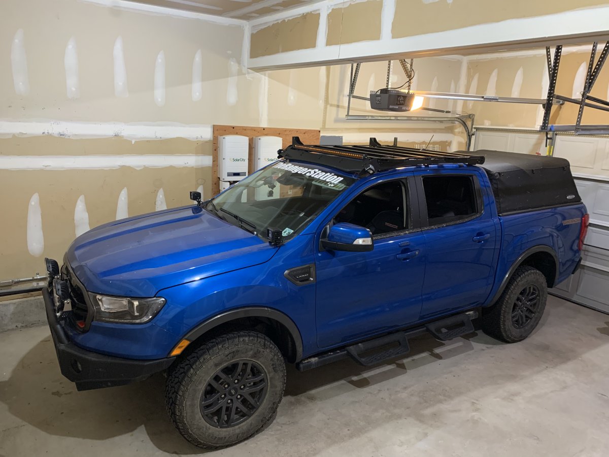

For the first time in her life, she gets to sleep inside:
I’m staying at the new house tonight and I haven’t brought all my crap here yet. I figured that there’s room in the garage, I might as well park in it.

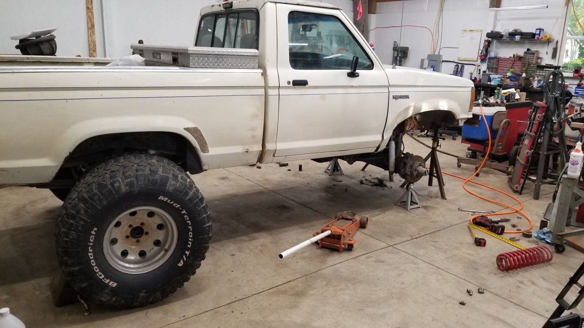

Since the '90 Ranger is in the shop and I went to an auction and found something I actually needed today it helped...
So far I set the new jack stands to the front frame height at ride height, removed the tires, removed the coils, removed the radius arm bolts and set some short jack stands under the lower balljoints at close to the right height and taken several measurements for reference for the new radius arms...
I've also found the following during the measurements:
-passenger side rear axle to front axle is 1" shorter than drivers side
-passenger side beam angle is around 8 degrees while drivers side is like 2 degrees...
that explains A LOT of the characteristics of the suspension on that thing... it likely all stems from hitting a tree that was in the ditch in the snow with the passenger side tire at like 10mph like 8 years ago... I thought I got things straightened out but I guess not...

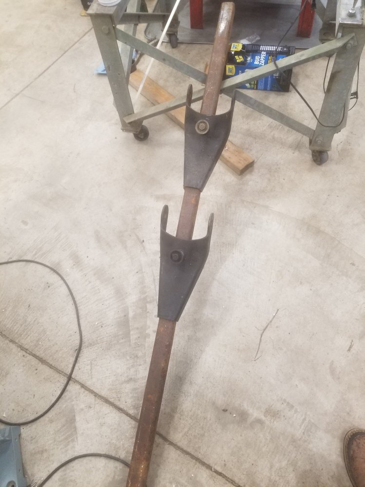

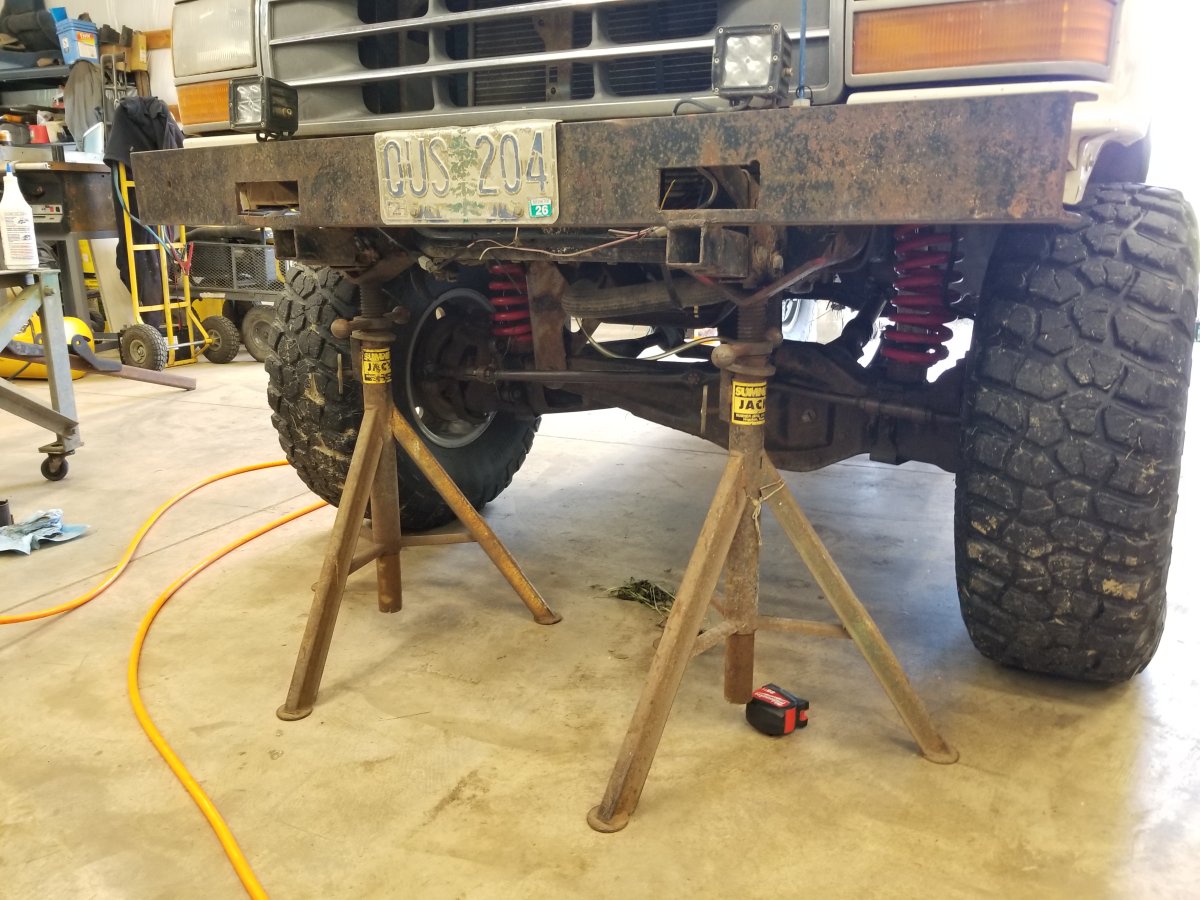

I didn't take a pic of where I ended up for the night but here's the current shenanigan's... First pic is the makings of extended radius arms, next is my new jack stands set to the height of the framerails and last is the Ranger sitting on said jack stands ready for the radius arms to be removed... I ended the night with the radius arm crossmember with radius arms attached along with the drop brackets and everything removed from the Ranger... next step is to jack up the transmission/transfer case and do some measurements side to side and vertical to make sure I don't screw that up for making a new transmission crossmember with radius arm pivots included...
Oh and along with the drivers side outer U joint being rusted and sticky the wheel bearings are loose, have to deal with one to get to the other so not a big deal...
Yep. That'll do it.

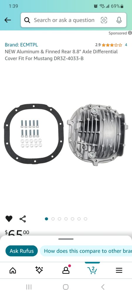

I am waiting to hear back from the junkyard on the fx4 shifter and i ordered this, to look cool from behind. Its cheaper then the motorsport one but still looks cool
