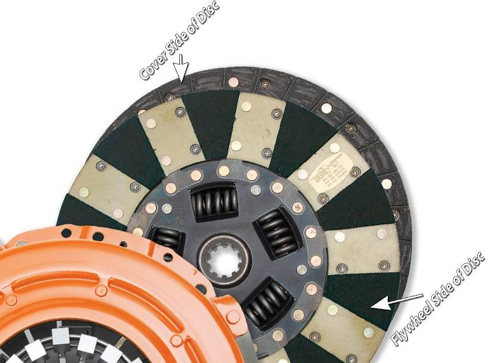

I've had clutch shudder since I installed the new Centerforce clutch with the new engine 5k miles ago. I have no time to pull the tranny and check, so I bit the bullet and took it to my mechanic to have them check it out. I have a feeling in installed the friction disc backwards. Since it is a dual material clutch, there is a right and wrong way. :confused:
Screenshot 2024-01-22 at 08-51-22 Dual Friction ® Clutch Pressure Plate and Disc Set.png
i dont think you can install those backwards.
the weights hang up and vibrate though.
My experience with fancy clutches like that is that they love to chatter.. I had a cerametallic clutch in my old outback and It definitely preffered to be worked 100% different than an organic disc.
