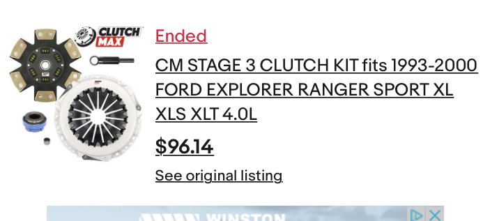

My experience with fancy clutches like that is that they love to chatter.. I had a cerametallic clutch in my old outback and It definitely preffered to be worked 100% different than an organic disc.
I put a stage 3 clutch kit in the Road Ranger 4.0 with matching pressure plate and flywheel. It is infinitely tighter, quicker/higher grabbing then the original clutch or any clutch I’ve ever had any vehicle. I think one TRS member called it a puck clutch. Is that what you have?
Mine does not slip or chatter, it actually grabs more like an “on off”switch as someone commented. It has a very heavy pedal, and it really took some getting used to, but after I did, I love it. When I’ve got that big trailer on it with something on the trailer, it doesn’t slip at all, but still let’s you drive normally.

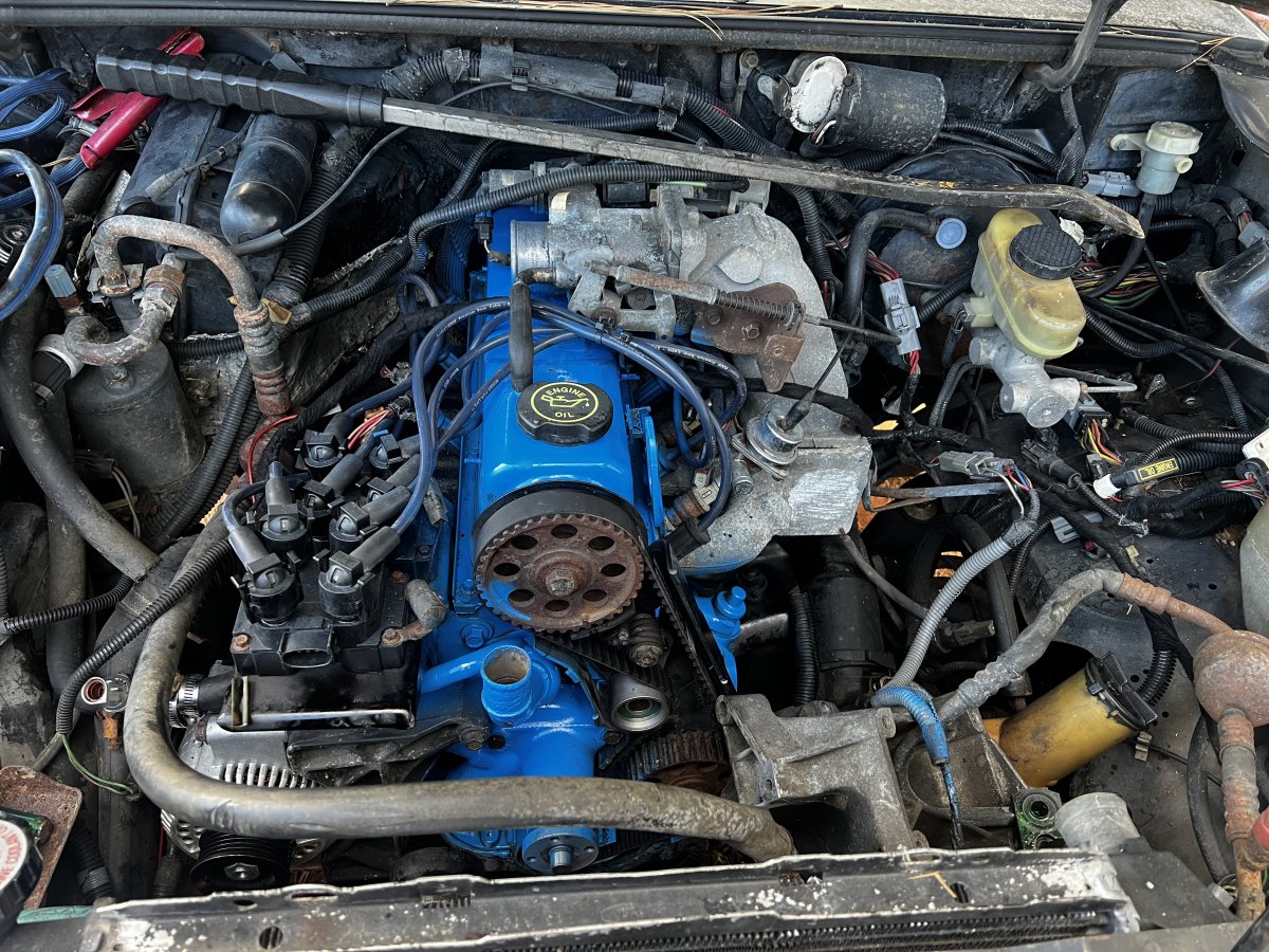

It's not what I did, but what I'd like to do as soon as I get the advice of the fine folks here. '86 2.9 that bucks and jerks with misfires if you try to run out the gears. Basically at about 2k rpm it will start this and the only way to stop it is to let off the throttle. Conversely, if you ease into it and shift normally, it runs smooth with no issues. If you keep it under a bit of a load, it doesn't do it. Is this fuel pressure or something with the ignition system? It's also a B-II, not technically a Ranger.
I would certainly start with fuel pressure. Also ensure the regulator is operating correctly. Because it happen under heavy load... the regulator is suspect.
If all good there... check timing first. Then ensure it doesn't have goofy none OE spark plugs. Then I would go through the secondary ignition components.

Fuel pressure is good (between 30 and 40 psi) and the regulator is working the way it should so I guess it's spark. It did run a bit better yesterday than Saturday which also leads me more towards spark problems. Saturday was rainy and wet, yesterday was clear. More moisture in the air will cause more issues with spark if there are issues to start with. I'll run through the plugs, wires and distibutor maybe this weekend. Here's some pics of the beast.

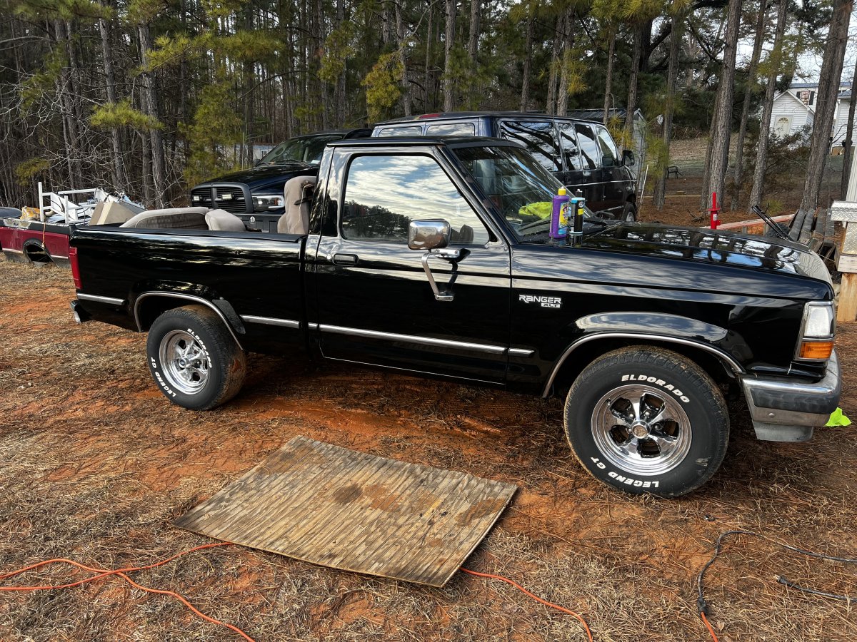

It needs a throw-out bearing and an A/C compressor (probably more A/C stuff) and the driveshaft is making some noise. Are there any good alternatives for the stock CV style shaft that'll work with a 4" lift? There a few other little odds and ends that need attention, but overall it's in pretty good shape for a 38 year old vehicle.

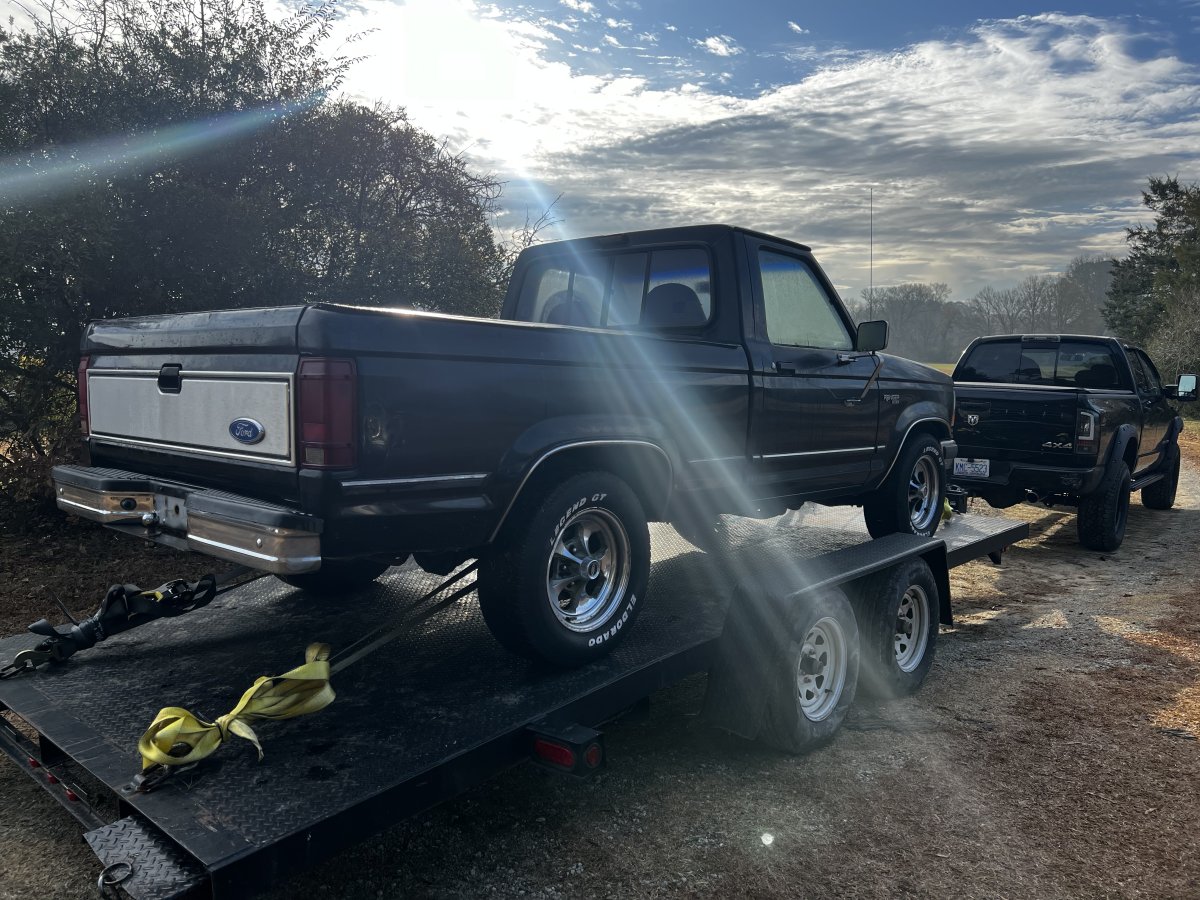

I bought this truck solely as a parts truck. But I got it running and driving. It still needs quite a lot of work for it to be roadworthy. But she is cleaning up nice. Not sure if I have the heart to cut it up. But I really need a lot of the parts it has.

that’s the problem. I need the cab with the title. And the bed. So I’m cutting up a ranger no matter what.
