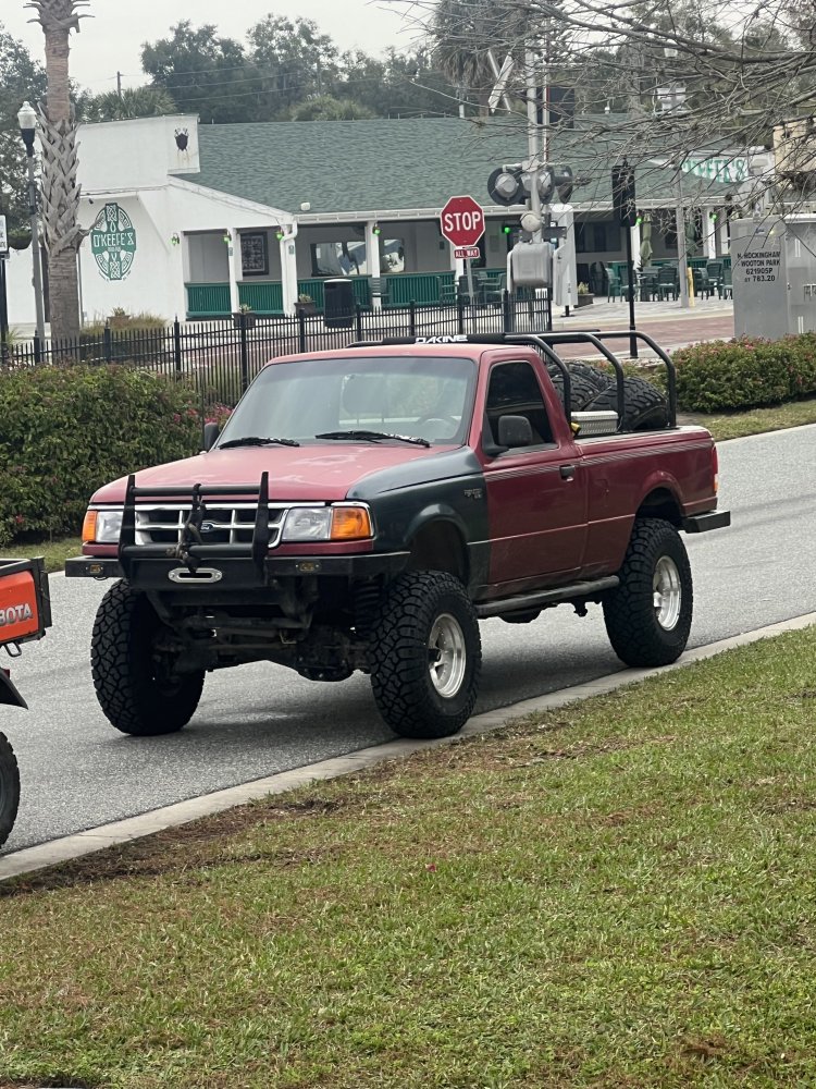

New tires came in and got mounted and balanced. Super happy with how they look and no more spacers.

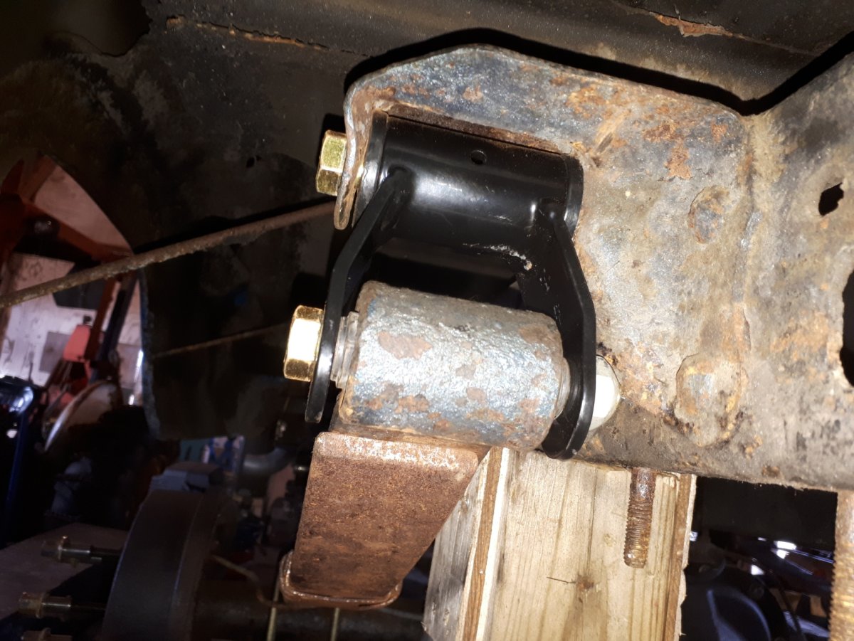

Four hours+ to get the old shackles out but only 15 minutes to install the new 2" dropped versions that should give me that one degree of pinion angle we're looking for. Old shackles were seized solid top and bottom so I suspect that was not helping the suspension work properly. All that's left now is to re-adjust the CalTracs.

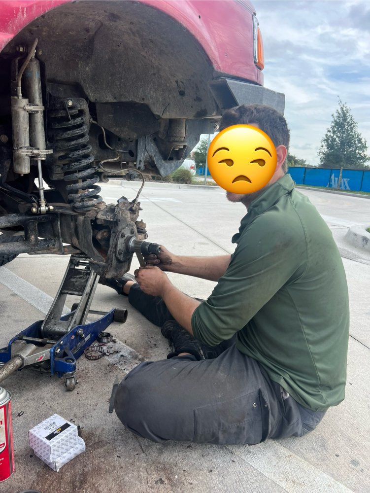

Killed a wheel bearing
Replaced a wheel bearing
Probably hurt with water and sand and mud, both wheel bearings :LOL:
I feel your pain... did that back in September coming home from the Fall Adventure. Roasted the spindle...
