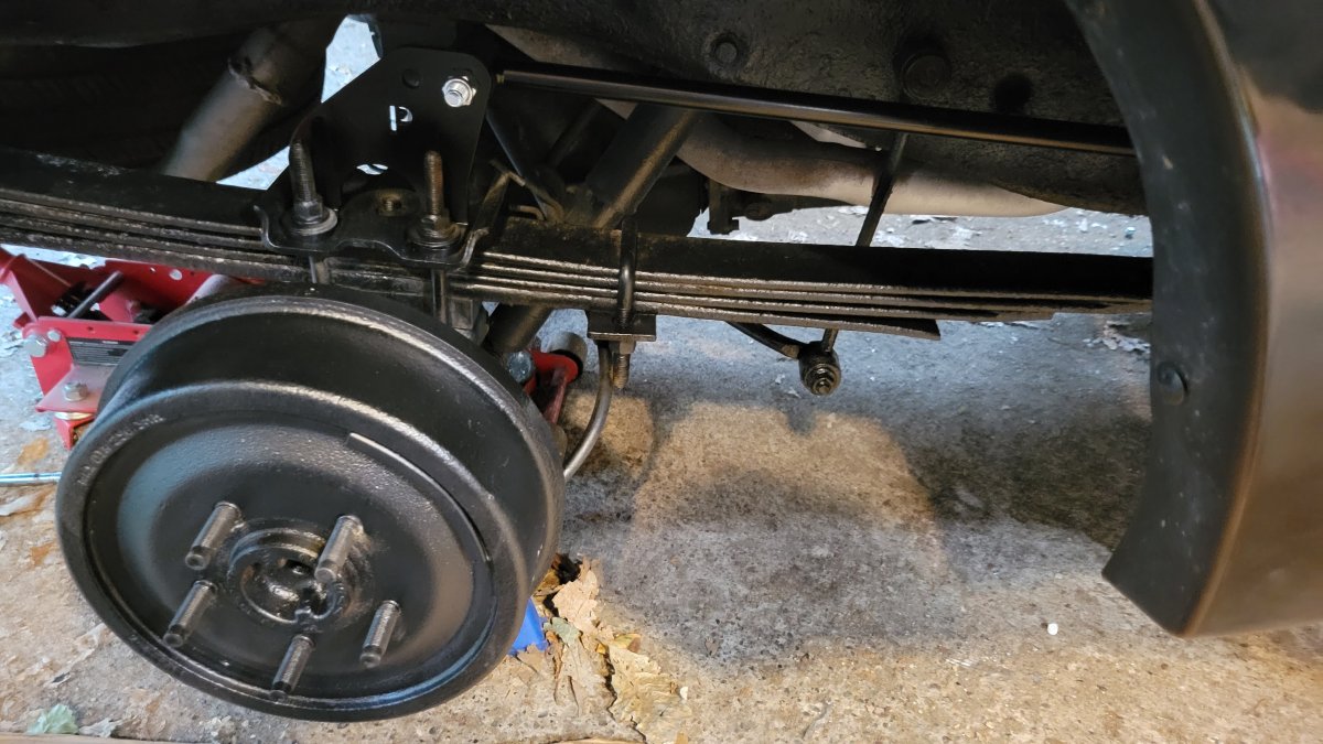

I installed a pair of James Duff traction bars.
I installed a pair of James Duff traction bars.View attachment 94469
I've looked at those. Mine has no sway bar, or anything, to help with axle wrap. I can't believe this burnt up 2.5 with 4r44e can wrap the axle bad enough to break traction on rough roads. New shocks didn't even make a difference. Lower tire pressures don't make a difference either.
There's a cheap fix for that. Take a look at the clamp on the leaf spring pack which is mounted about 6 inches in front of the axle. It will reduce both sway and axle wrap. You can buy leaf spring clamps at most parts stores, about $17.00 for a pair.
Thanks. I didn't think of that. Probably should replace the leaf spring bushings. I noticed the edges were split while I was adjusting my rear brakes.
I'm going purely off recollection here. If axle wrap is you problem, you want the traction bars. Sway bars and lowering tire pressures aren't going to help that. I feel like the lower tire pressure may actually hurt more than help. Sway bars are going to counteract body roll side to side, not rotation of the axle. Traction bars are going to couteract axle rotation, not body roll.
I can;t speak to the leaf spring clamps that Lefty recommends. The only time I've used them was to hold a spring pack together while changing the center pin. Didn't drive with them installed, and feel like it could cause the springs to bind up rather than working as they should. I have no experience with them though.

Leaf spring clamps are an old racing trick. You won't notice the difference except for less sway around corners and less axle wrap. They don't solve these problems, but they certainly help.
