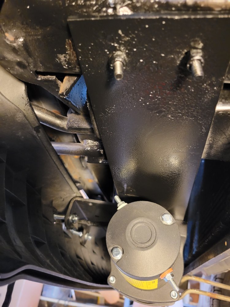

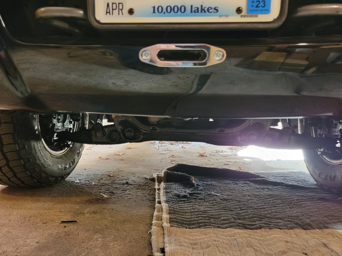

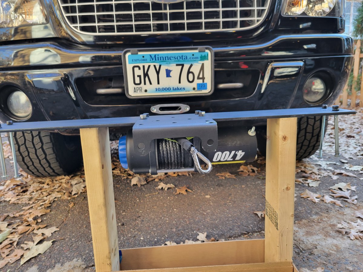

I installed a hidden winch just behind the lower front valance.
I bought a Vevor winch for $109.00. The price was right for 4,700 pounds of pull, plenty for a 3,000 pound regular cab pickup. Cheaper winches are out there, but this particular model came with a remote control and a synthetic cable. Synthetic is safer and never going to rust.
I purchased a piece of 1/4" steel (4"x31") to mount it and bolt it to the frame. It was a tight fit but everything tucked neatly underneath and behind. The mounting plate that came in the box served as a bracket to reinforce the fairlead and firm up the valance.
4700 is low for a 3k vehicle.
The pull on a mired vehicle is equal to 150% of the static weight on a level surface. If it’s a 15° uphill pull, you’d be at about 175% (5250 lbs).
That 4700lb rating is also measured on the lowest row of the drum. Every row above that you lose about 5% of your pulling power.
I usually recommend that the winch be 2x the fully loaded weight of the vehicle.

@Lefty - that little quarter inch plate is going to twist up like a pretzel the first time you go to actually use that winch. If I did the math right, it has about 1/5 of the torsional rigidity it needs to handle 3700 lbs on the cable.
