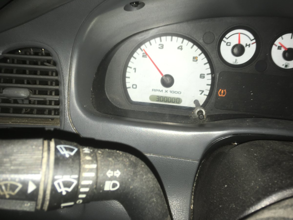

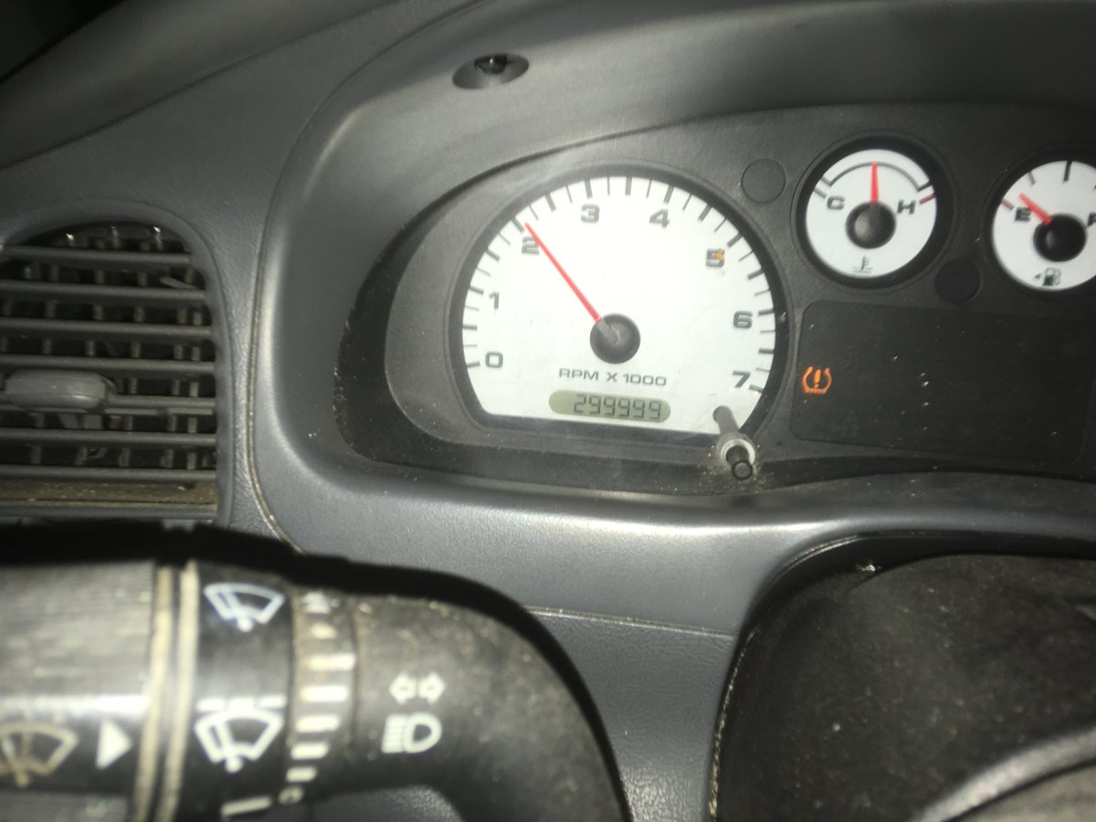

The old girl rolled over 300,000K on the way to work this morning

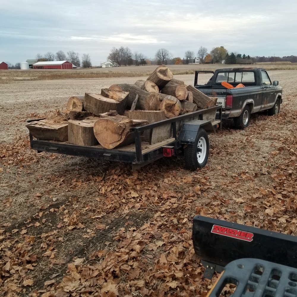

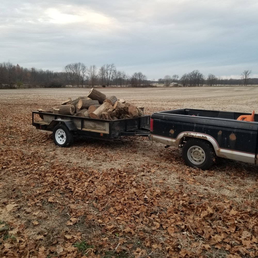

Then we went to work...
Now my back hurts. Those logs were heavy as shit
