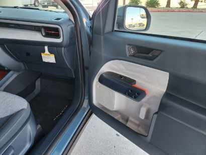

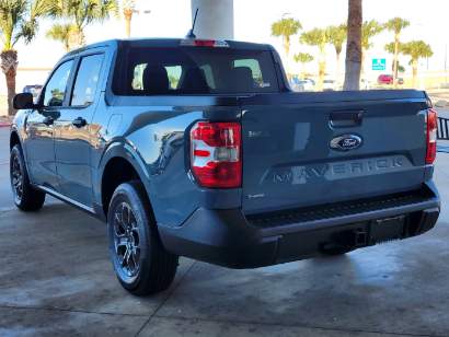

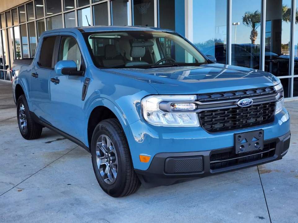

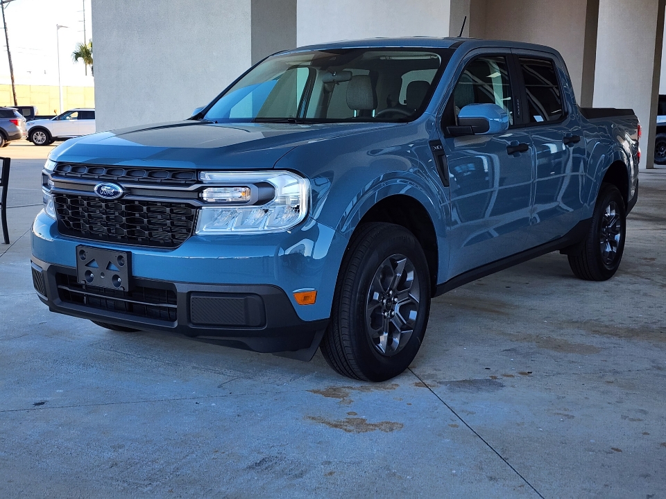

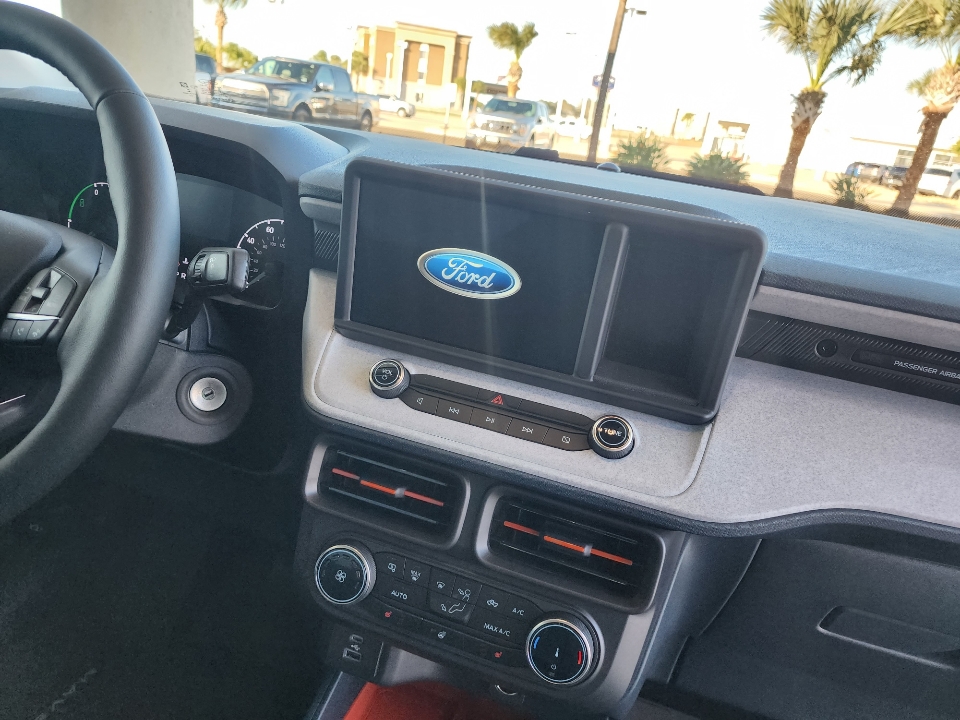

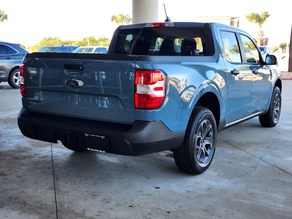

Got a call from a buddy who is the finance guy at one of the local ford dealers. He found a 2022 ford maverick that someone odered and than couldnt get and called me because my 83 year old uncle wanted one. So tomorrow my uncle gets a new truck.
My uncle told me he is just getting it until he cant drive anymore and than i can have it. Thats cool but i told him i would rather he just keep on driving and stay around for a while.
He is already to the age where the guys on my mom's side of the family pass away. 83 has been the age for a few of my uncles and my grandpa. Hopefully he goes a good bit longer because he and my mom are the last ones.
Anyway, here is the truck pics
