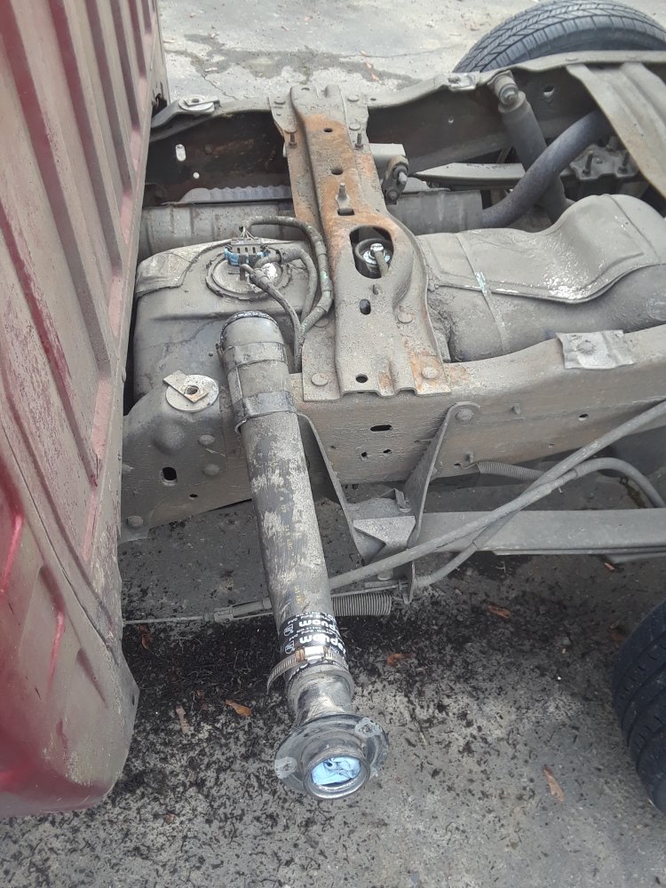

What the hell is the factory wax/tar all over this thing? Any way to clean it off chemically?
If by chemically you mean a flame then yes lol
now that craps flammable so carefully apply some heat, key word there SOME your not wanting to red hot the frame a propane torch will suffice and once it starts flaming and dripping you can blow the flames out with a blower and wipe the surface area with a rag.
or meth and elbow grease whatever floats your boat lol

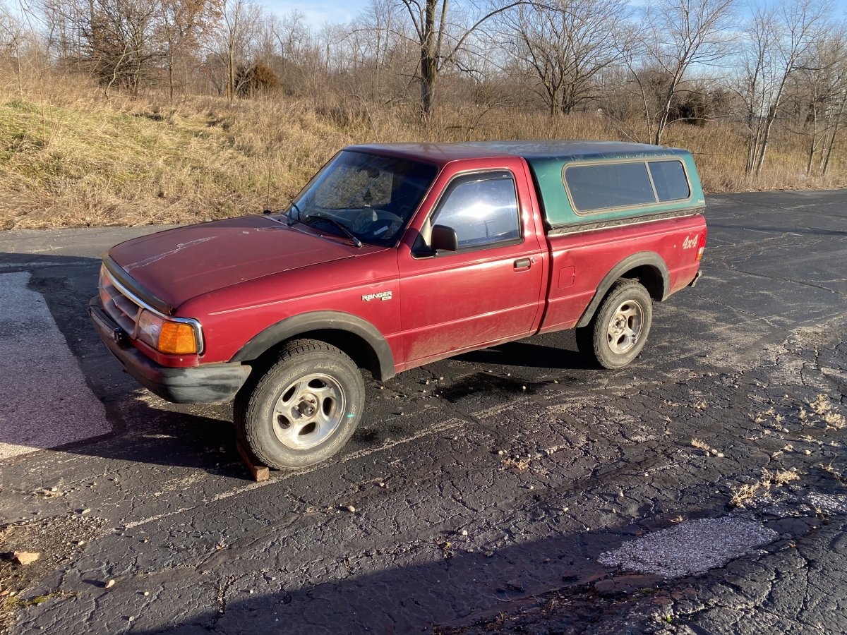

Put a bunch of miles on it today. Went out hunting and exploring. Didn’t find any lions, but I did find a couple problems with the truck. Leaking valve covers, a massive vacuum leak and a busted shock bushing. Fixed them all and it still shudders under acceleration 😭
