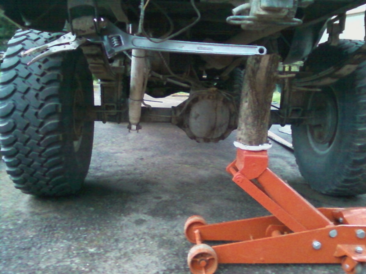

Blame Ford all ya want but my '89 chassis only broke a shackle mount after I rolled it and had to do this to straighten it out, like 3 years later I welded a 7/8" wrench to the top of the frame and the shackle mount in camp, it's still that way...
You should try the half frame replacement sometime :icon_rofl::icon_welder::beer:

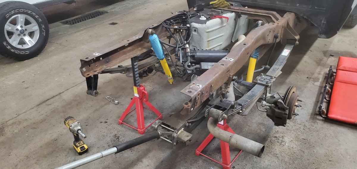

Frame rails are ok. The crossmember above the spare tire was starting to rot, plus a few pinholes around where it attaches to the frame. So, new spring hangers, crossmember and frame repairs, and a coat of chassis saver over everything.
What the hell is the factory wax/tar all over this thing? Any way to clean it off chemically?

My 00 the frame rails looked like Swiss cheese, I kid you not. I did a half frame, but now there’s some holes in the front section. I can patch those though
No idea what that waxy tar stuff is. So far the best way I’ve found is to scrape as much as possible and use solvent. Brake clean, acetone, xylene, that kinda stuff. It kinda melts into a sludge so it’s best to scrape as much as possible first
