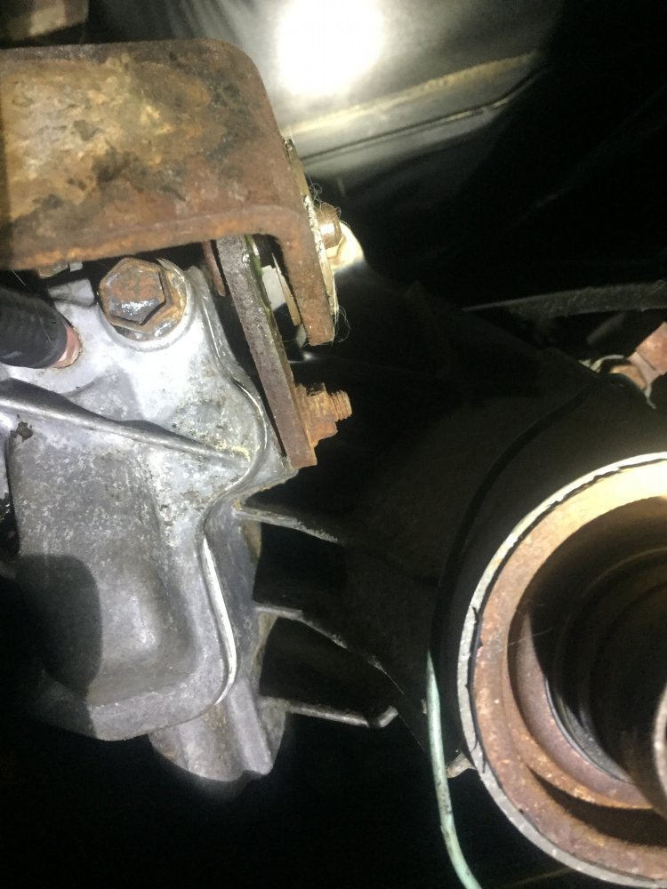

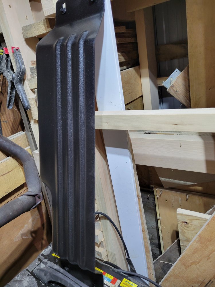

I spent the last 2 days off and on cleaning the transfer case prepping it for paint. Got it painted plus the transfercase skid plate and the engine mounts
Is that skidplate factory? I swear I remember seeing a skidplate under an fx4 once.... I have been checking junkards ever since with no luck.

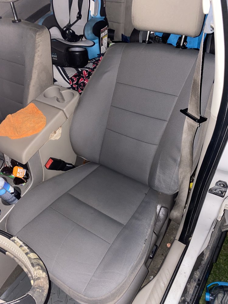

Little display of my upholstery deep cleaning. Not the ranger btw, customer car. Im not done with the vehicle, the seats are literally the first thing i do just in case there is areas that need addressed once they dry.
Before:
After:
Again, im not done with the car lol. First lay down a heafty soaking of dawn dish soap, degreaser concentrate (i like purple power), steam cleaner solution, and stain lifter (i like shout). Scrub it in with a nylon brush on a drill. Let soak. Go over it with a carpet cleaner full of straight water. Repeat until stains are gone. Followed by tuff stuff, brush it in, carpet clean it out. I usually put a little liquid new car smell in the carpet cleaner for the last round. Works every time if you have the patience.
Awesome, this saves the hassle of having to make a thread asking the best way to deep clean seats lol. Thanks!
The skid plate is from an Explorer but there are predrilled holes in the ranger frame for it I have another identical one I got from a b2. I think it was an option rarely equipped on rangers.

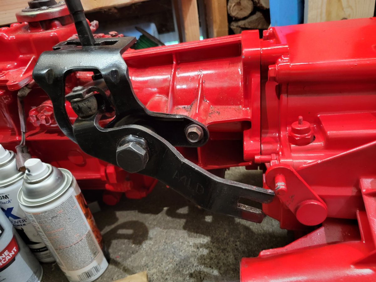

l today I recieved the transfercase shift linkage kindly provided by @tw205. I guess I should have test fit it before I made it look great.
Why am I having such a hard time finding the right shifter, this is closer than the one I had, was there never a 1350 manual shift behind an m50d, is this my issue. No blame on tw205 as far as we knew it should have fit. Does anyone have any idea if the shifter I need exists. Should I just give up and use the 1354 elec.shift
Wow. No way. I’ve got the same transmission and case on my 89 BII
Mine from a 86 Ranger doesn't have the ribs, I wonder when they were added.

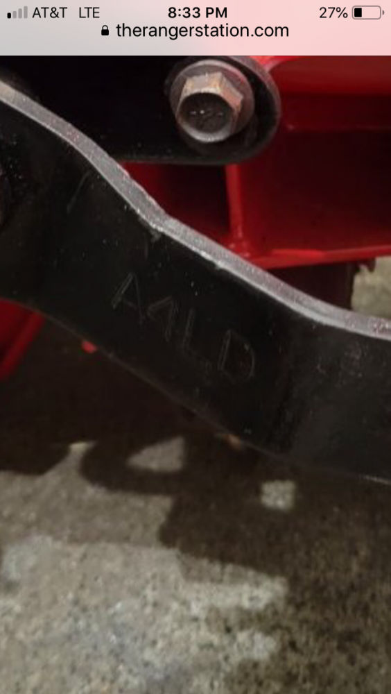

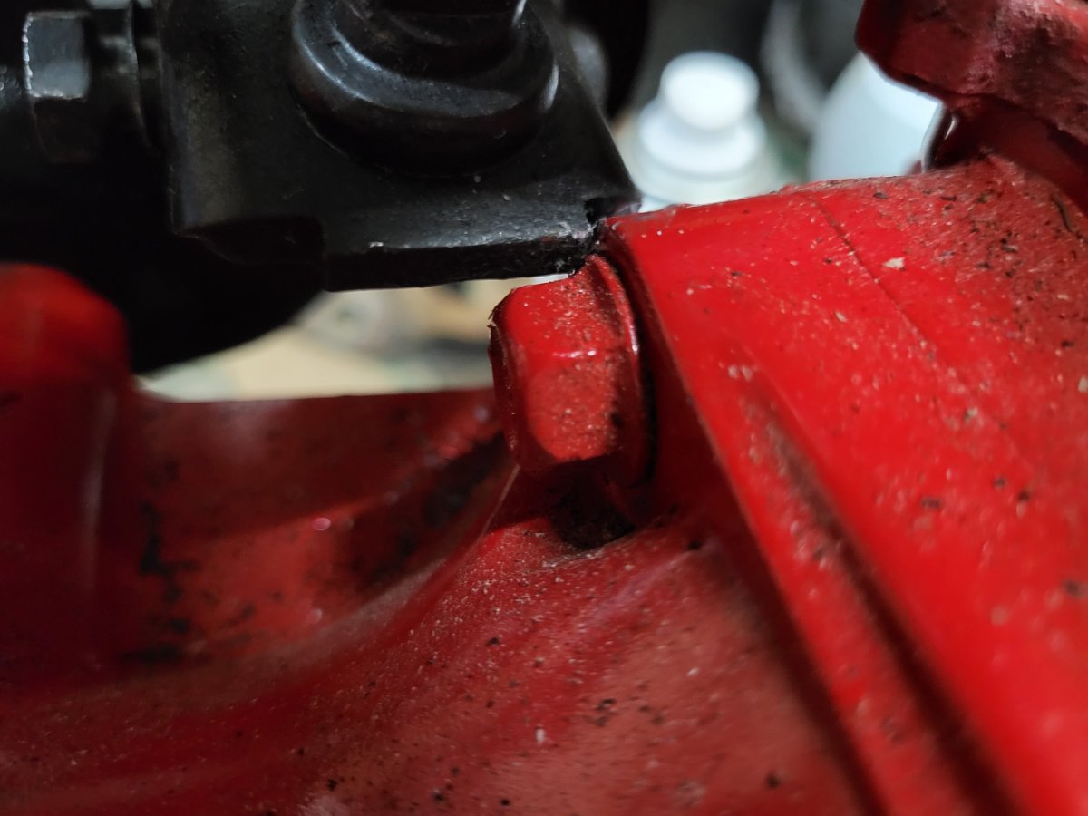

l today I recieved the transfercase shift linkage kindly provided by @tw205. I guess I should have test fit it before I made it look great.View attachment 67648View attachment 67649
The stub shifter on the tcase isn't right and yours isn't removable (some are)
correctly. In other words my parts from 83 arnt interchangeable?
I feel so bad. Even if I didn’t charge you for it. That sucks. 85-Ranger4x4 is right. Here’s a 1350 and it’s lever is removable. I have the M50D with a BW1350 on my other rig I think the M50D is an inch shorter than the FM146 but it’s in the body not the tail shaft your transfer case shifter must have been modified
I was going the other way putting a A4LD prepped 1350 onto a 83-84 C5.
I see it now. The shifter I gave you is for an A4LD. Automatic transmission. The bosses for the shifter are further forward than the manual transmissions? The shaft going to the transfer case is only slightly offset. The manual trans shifter it dog legged. See it? And on the shaft it says A4LD.
I’m going to pull one off an 85 ranger tomorrow, if it’s not raining. It’s a manual/manual rig. We can take some measurements and make some comparisons. If we determine it will work. I’ll send it to you on my dime. I feel bad.
He needs a tcase. The lever you sent is correct for his trans, the lever on his tcase is wrong. A4LD/m50d lever that goes on the tcase is longer and clocked slightly different.
Not to question you but are you sure? I think it’s my fault to a degree. Look at the shifter arm that goes to the transfer case. It say A4LD on the one I gave him. I’ve got 3 in the barn. One automatic and 2 manual. I went out and looked and by god they are different. The manual arm is 90 degree doglegged. The automatic is slightly offset.
