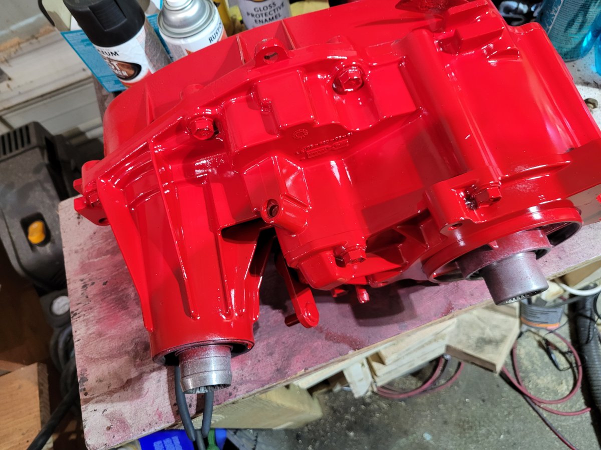

I spent the last 2 days off and on cleaning the transfer case prepping it for paint. Got it painted plus the transfercase skid plate and the engine mounts
So THAT'S what a transfer case looks like. I'm guessing the side that's visible is the front. One of these two shafts mounts to the transmission, the other to the front driveshaft. On the other side, there'd be another shaft that mounts to the rear driveshaft.
Right?
Right?
KY.. that image is showing the bottom from a front angle. The shaft on the right slides onto the transmission output. The one on the left is where the splines of the front driveshaft slide in.

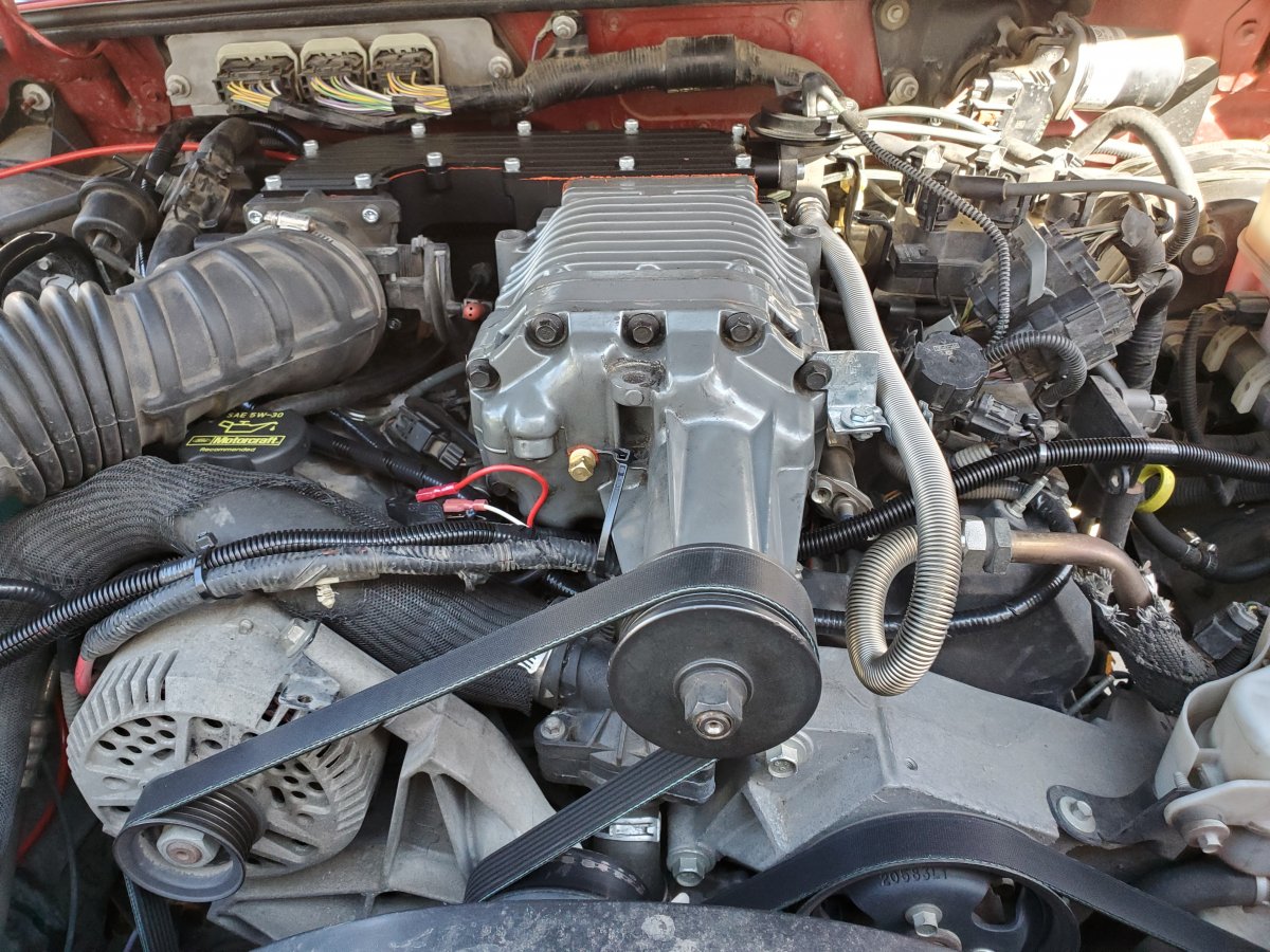

This is what I have been up to the past couple weekends. Working on the tune now, then turn on the meth injection, then add the e-fan.
Sweet. What did you do for the airbox?
Also, what are you using for the meth injection?
Head up, that flexible EGR tube will break if it's not strapped down to something, I used a cable clamp to tie it off so it wouldn't vibrate as much.
Do you plan on putting it on a Dino for a tune or doing it yourself while driving? What software are you using?

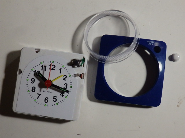

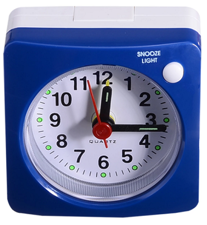

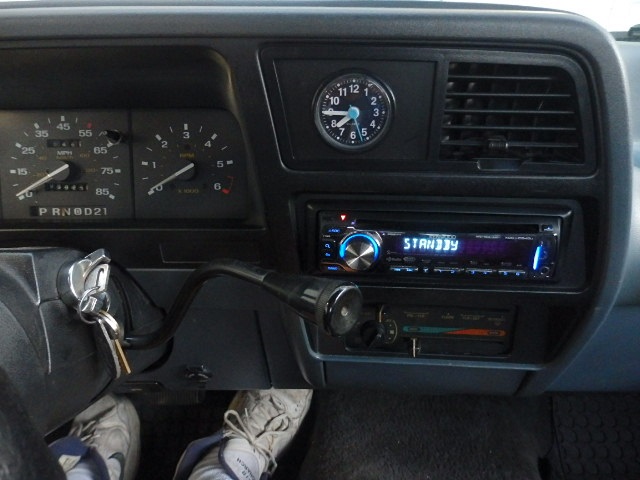

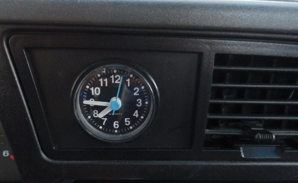

Dashboard Clock w/Sweep Second Hand - Fun Project !
Got tired of the phony vent in the center after 13 yrs & made the space useful by adding a clock. Came out pretty good.
The vents pop out pretty easy with a plastic spudging tool & a small screwdriver.

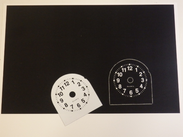

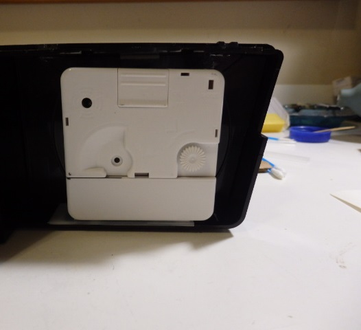

I bought a $3 travel alarm clock & took it apart to remove the snooze/light button & bulb. Also the alarm hand. Removed the white dial from the movement &
took it to a FedEx printing center to print the dial inverted (45¢ a copy). First I had to blacken the green dots on the dial with a fine point Sharpie & trace the edge
& center hole on an index card so they would come out white. I also had to paint the hands.

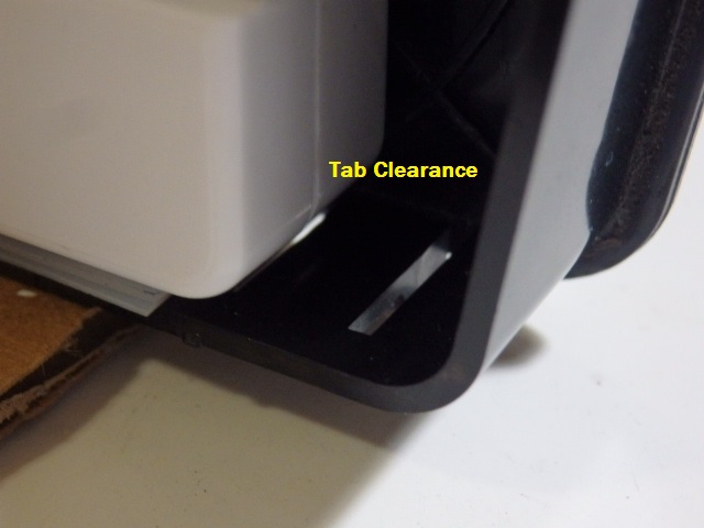

I didn't use the front trim of the clock. Instead, using a piece of scrap plastic I cut a plate using the fake vent as a template. Then I cut a hole in the plate for the clock window.
The movement mounted well with 3M mounting tape & some scrap plastic & epoxy to raise the movement so the dial would be centered up & down.
The front of the dial & movement butts up with the back of the clock window which I pressed through from the back of the plate. I went to my local hardware store &
picked up an O ring to use for trim around the clock window.
Right now its running on a AA battery & thats ok but I have a DC buck step down converter on the way & I'll give that a try so the truck can power the clock.
I also have some 12v 3mm blue LEDs on the way & I'll put 1 in & tie in to the dash light circuit. If it's too bright I'll figure something out, maybe a different resistor.
I'm not sure if the LEDs I'm getting are dimmable with the light circuit but I really never dim the gauge lights anyway.
I can't adjust the time from the front of course, but it's a quartz movement & as I mentioned the vent panel comes out fairly easy.
As for replacing the battery, let's hope the converter works out ok.
I have some improvements in mind but this will do for now. I wish I took more pics but I was too busy having fun with this !
Cheers !! View attachment 67205
View attachment 67202View attachment 67203
View attachment 67206View attachment 67208
View attachment 67210View attachment 67212View attachment 67213
Buck converter arrived over the weekend. Still waiting on the LEDs.

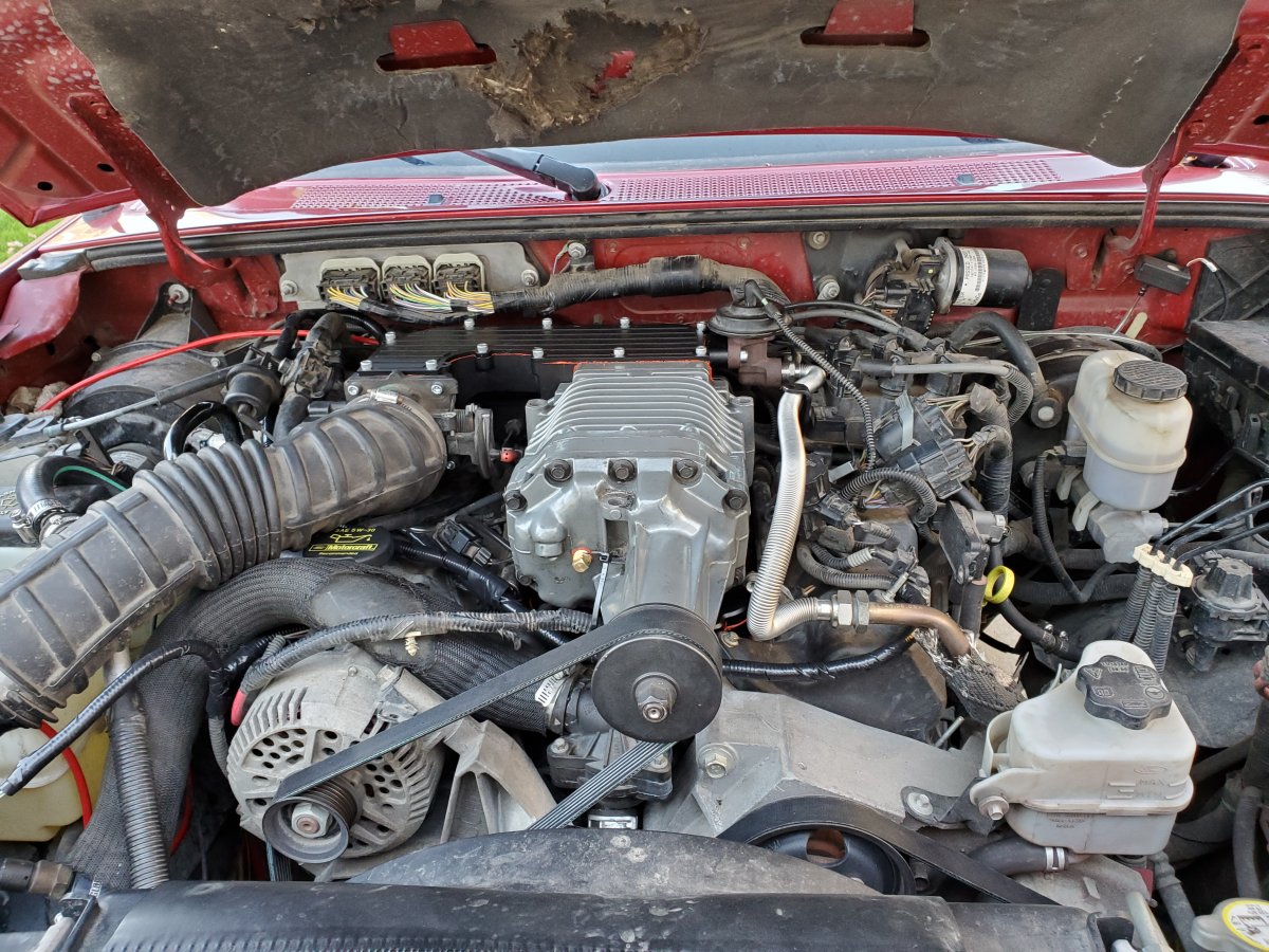

Yes, here is what it looks like now. I bought an egr valve from an 04 Mustang 3.8, which has the inlet port rotated 90 degrees so the flex tube didn't have to push on the coil pack and didn't have to have that sharp bend in it, and then I supported the flex tube as you can see. It looks like in the photo that there are wiring bundles right up against the egr line, but that is not the case. It also looks like the flex line touches the blower, but that is not the case either.
I have a Snow stage 1 meth kit - its installed but I have not turned down the activation switch enough yet that it actually comes on. Its running a max of 6psi boost right now, and I plan to have the meth come on at about 4psi. I am tuning with SCT ProRacer. I did a RPCaster kit on the 03 that I had years ago, so this is mostly copying the tune adjustments that I ended up with on that truck into this one. I had that one on the dyno, but do not plan to dyno this one. So far, I am enjoying having a little more get up and go, but am taking it pretty easy until I get the details completed.

That’s pretty sweet. Let us know how you make out with that tune.
I ended up flipping my egr valve upside down, I figured vacuum still works upside down, so the flex hose doesn’t jam into the coil pack.
Does the transmission output go straight through, and then mount to the drive shaft? Or does it just go in, and connect with a separate shaft that comes out the back side of the transfer case?
Rangers use a married transfer case, right? And it's chain driven? (I did a little reading about transfer cases)
