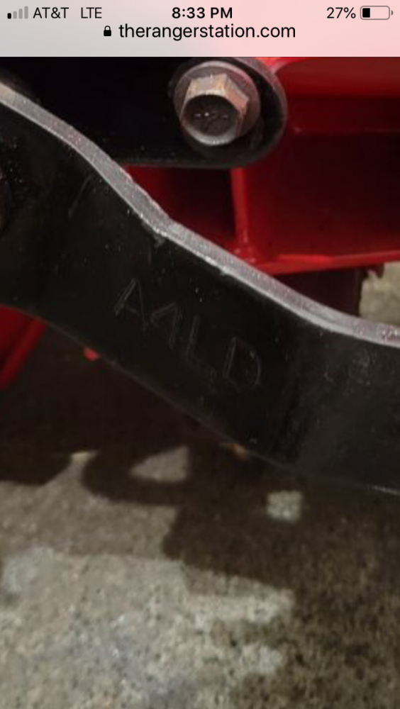

Not to question you but are you sure? I think it’s my fault to a degree. Look at the shifter arm that goes to the transfer case. It say A4LD on the one I gave him. I’ve got 3 in the barn. One automatic and 2 manual. I went out and looked and by god they are different. The manual arm is 90 degree doglegged. The automatic is slightly offset. View attachment 67654View attachment 67655

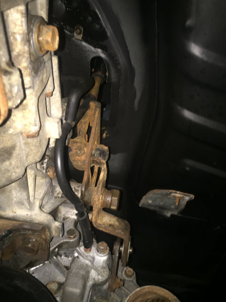

Both there’s picks are my 85s. One A4LD.
One FM145

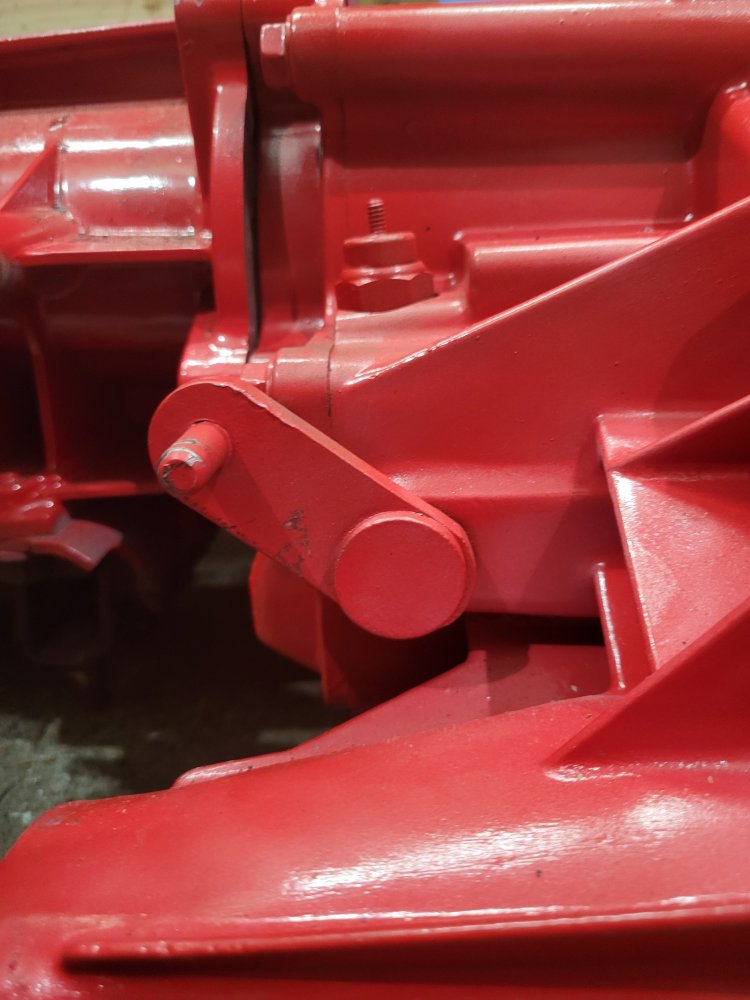

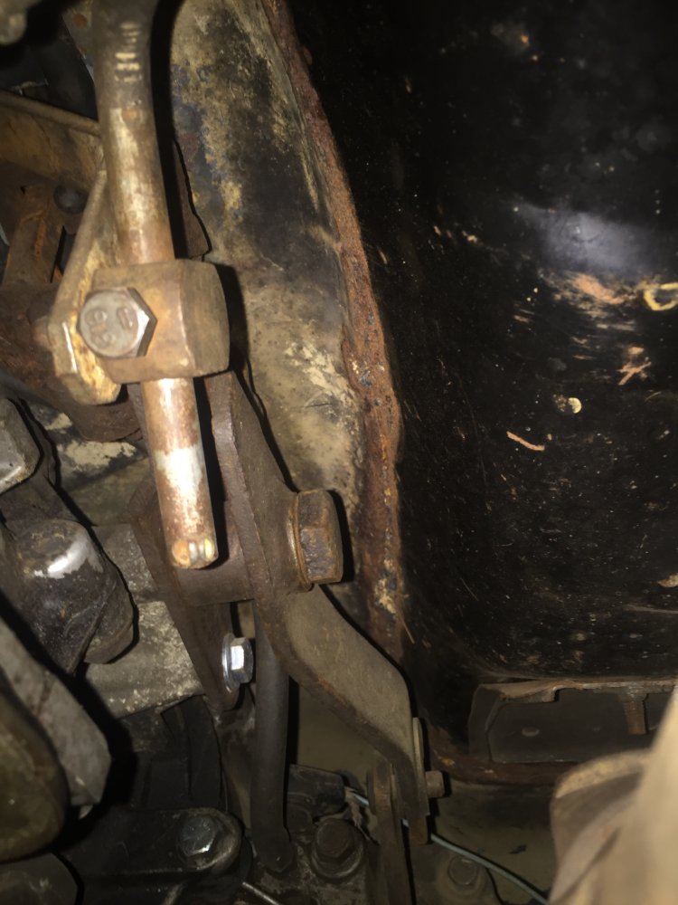

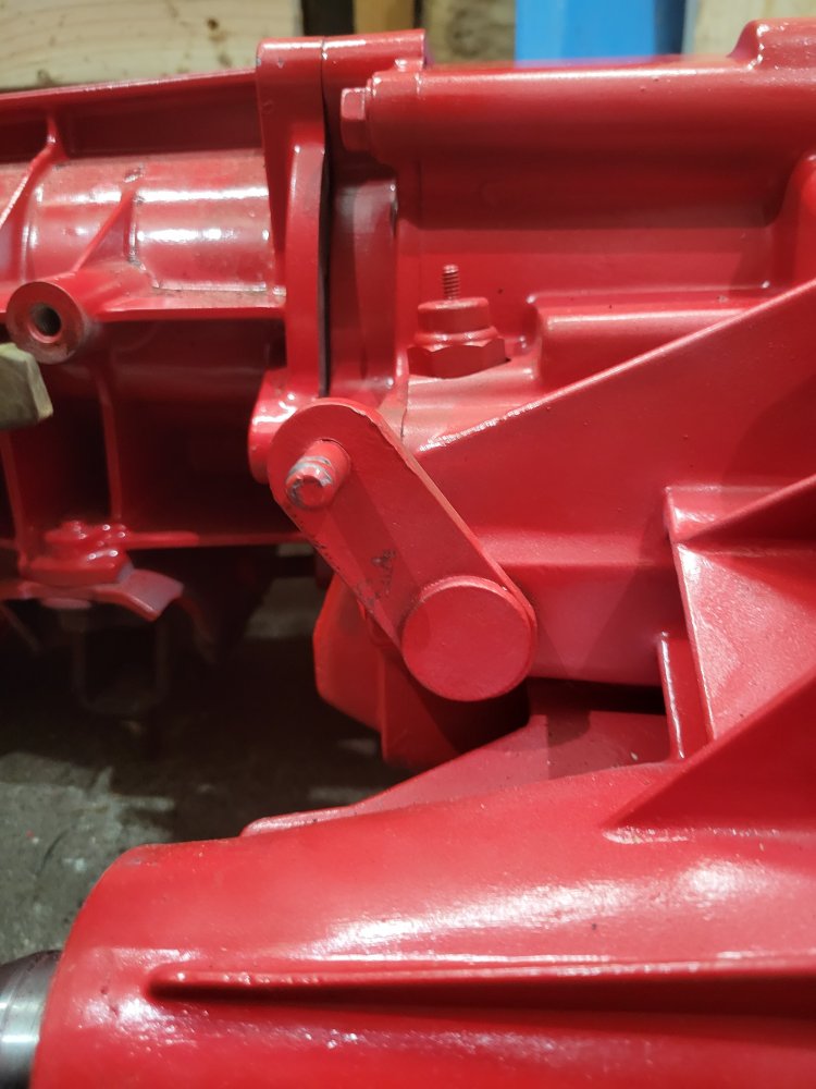

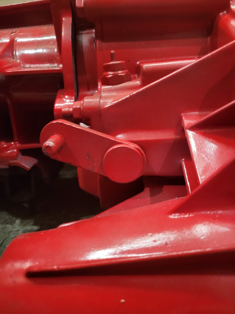

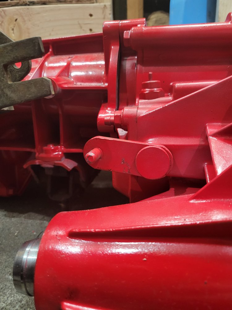

So this first pic is of the shifter that came off the truck with this 1350, than the second is the one from tw205. The second one does bolt to the tail housing correctly, and my original does not.

It's the manual 5 speed out of an 83 4x4 ranger, the one that takes gear oil. The shifter on my truck currently A 2.3 4SPD 4X4 MANUAL has the same shifter

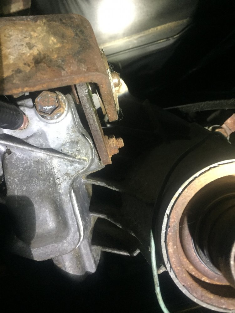

If i could also get clock angles for the input arm for each gear location that would help me build an adaptor if I need to for instance this is pics in order top to bottom 2hi 4 hi neutral 4low
