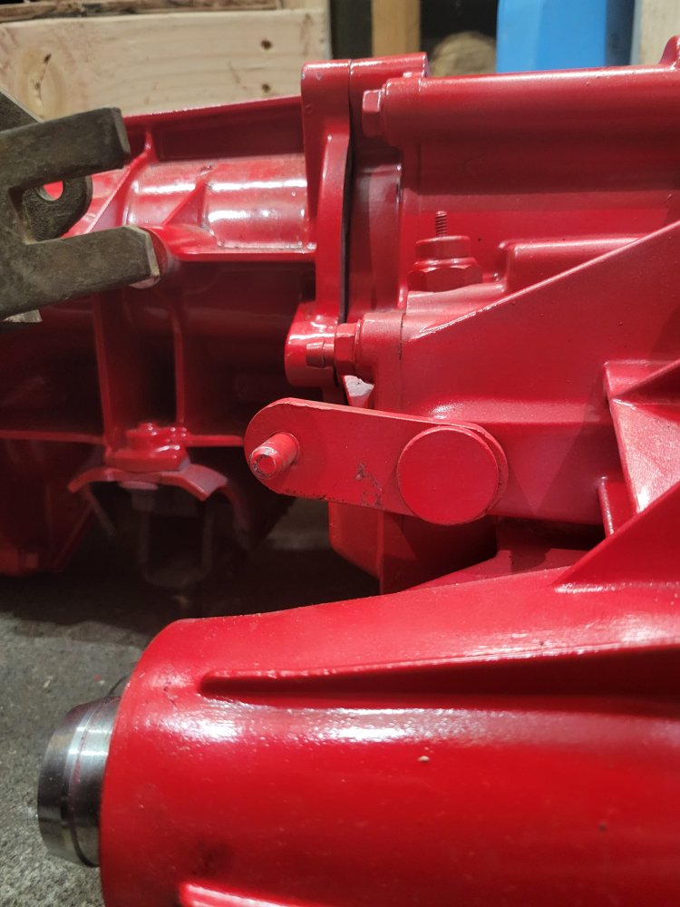

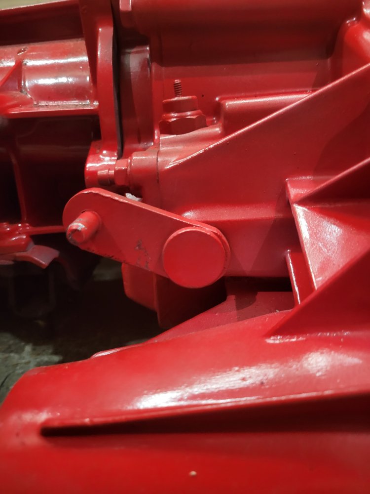

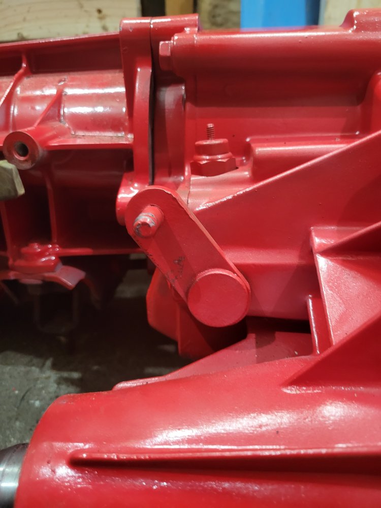

If i could also get clock angles for the input arm for each gear location that would help me build an adaptor if I need to for instance this is pics in order top to bottom 2hi 4 hi neutral 4lowView attachment 67660View attachment 67661View attachment 67662View attachment 67663

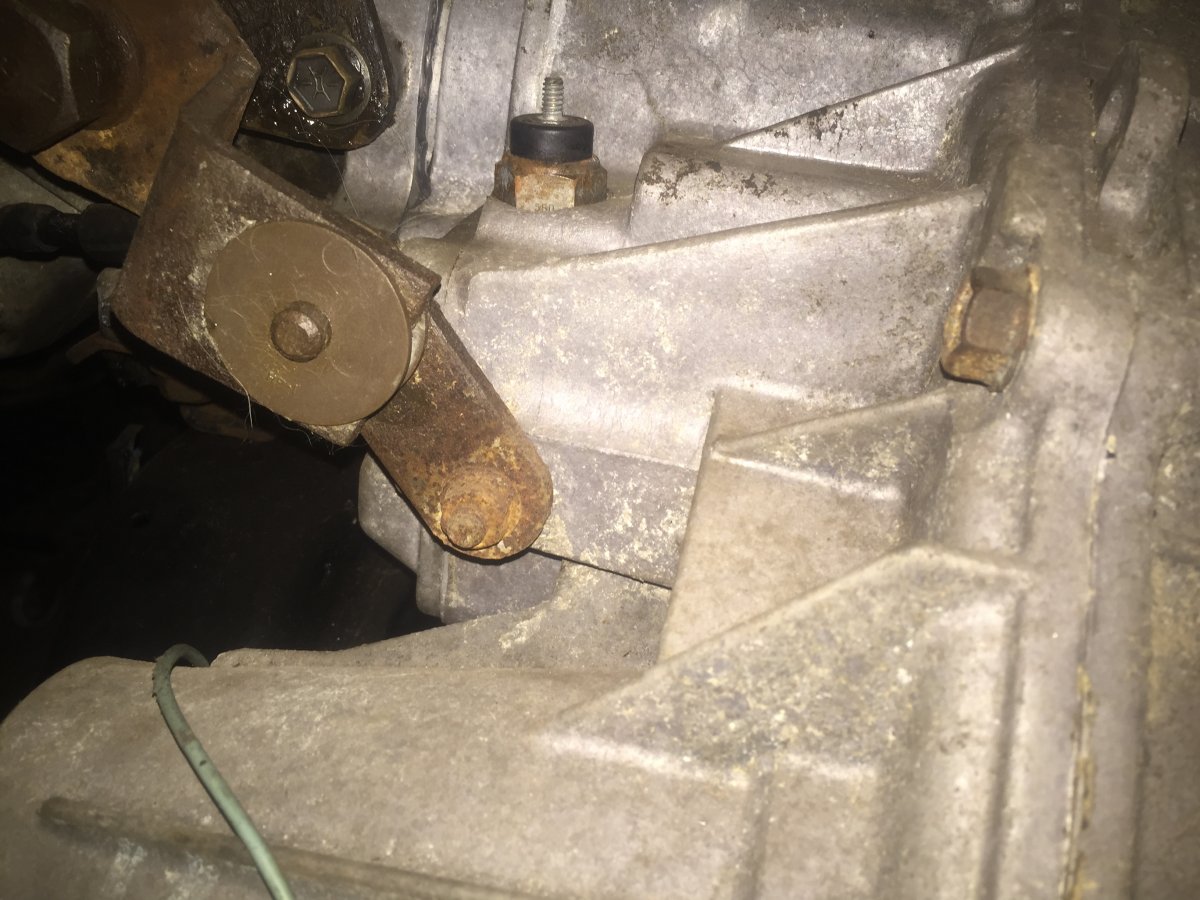

Ok. So I have an M50D from a 94 explorer I bought for the same reason mated to the 1350. She in the rain now so I climbing under there. I can make those measurements tomorrow and compare them to yours. It may well be your transfer case but seeing is believing. As for your clocking. Your 2H looks the same as mine.
The first pictures you posted it appears the shifter is setting in neutral and the transfer case is 2H. Makes it look like it would be correct if they made contact. I’m wondering, after all the photos and hubabaloo that maybe the shift lever on your case is shorter in length.
Ok. So I have an M50D from a 94 explorer I bought for the same reason mated to the 1350. She in the rain now so I climbing under there. I can make those measurements tomorrow and compare them to yours. It may well be your transfer case but seeing is believing. As for your clocking. Your 2H looks the same as mine. View attachment 67664
It is shorter and clocked slightly different. I tried cutting down and welding my a4ld one and it didn't work.

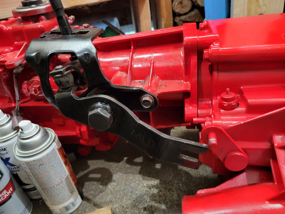

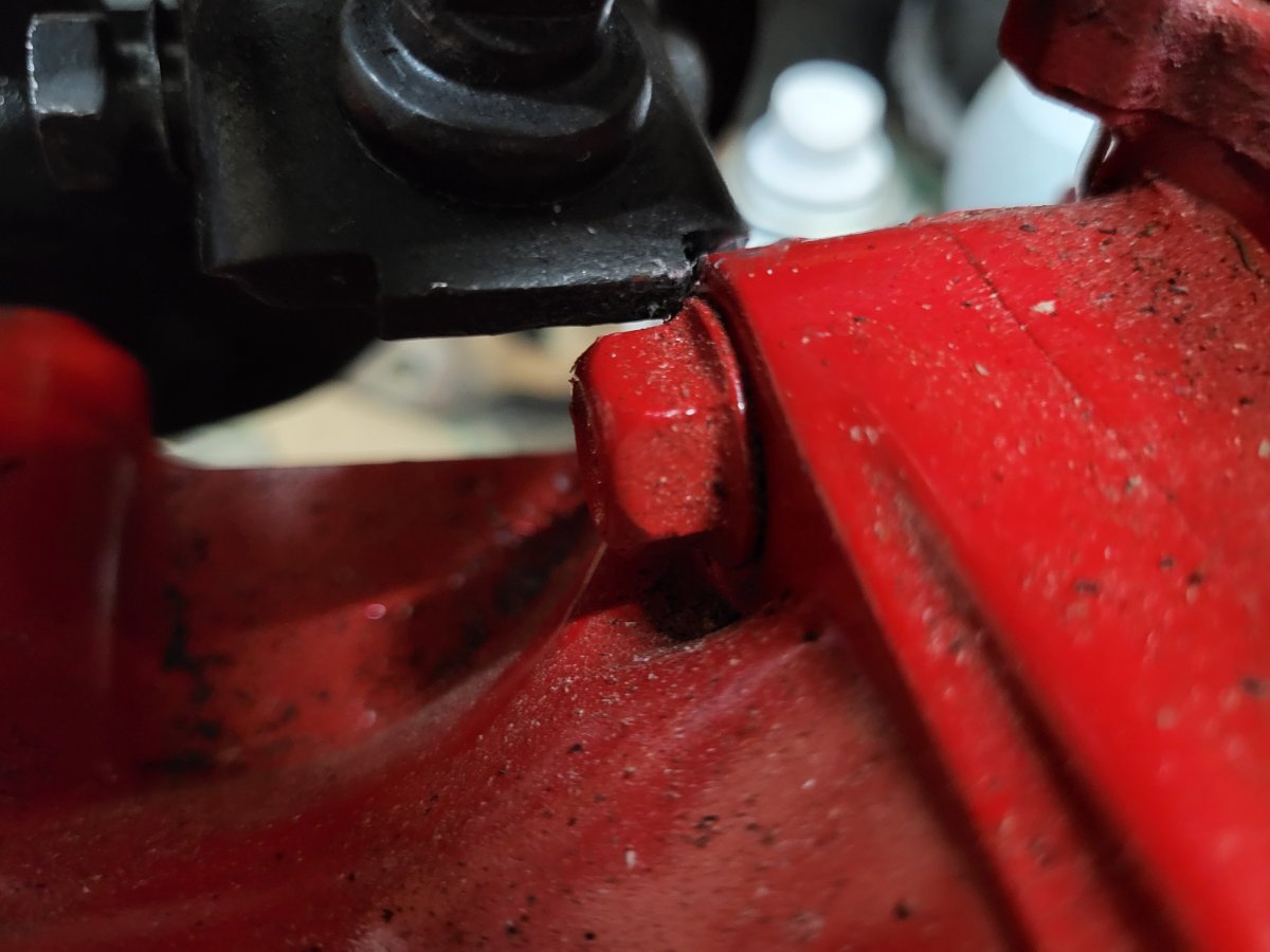

l today I recieved the transfercase shift linkage kindly provided by @tw205. I guess I should have test fit it before I made it look great.View attachment 67648View attachment 67649
Why am I having such a hard time finding the right shifter, this is closer than the one I had, was there never a 1350 manual shift behind an m50d, is this my issue. No blame on tw205 as far as we knew it should have fit. Does anyone have any idea if the shifter I need exists. Should I just give up and use the 1354 elec.shift
The early 13-50s had the non-removable arm on the shaft... IIRC, they were about 1” shorter than the one used with the M5OD/A4LD. You’re going to have to modify the either the shift linkage or the arm on the T-case.
I see it. I blew up the pictures of his and mine. His Clocking looks like 1030 mine looks like 10. Interesting. I hope you aren’t offended by my inquiries. I really like gaining the knowledge. Don’t know what I’ll use if for but hey, it’s a hobby.

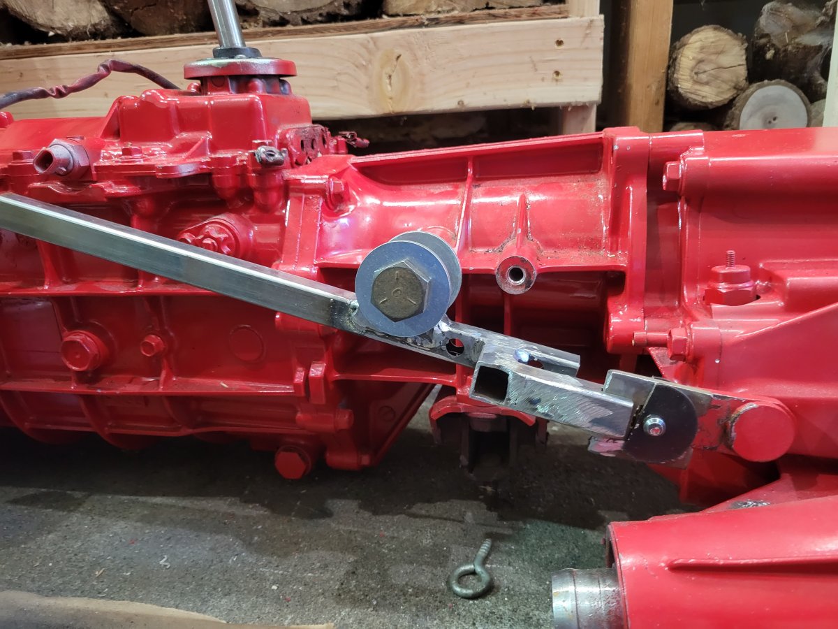

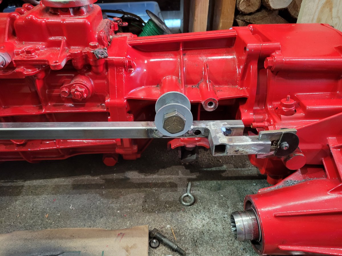

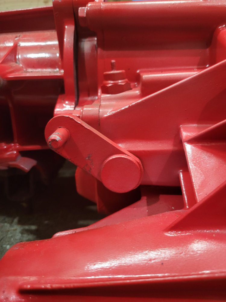

Been working in fabricating the new transfercase shift linkage. Here is what I have so far runs through the gears quite nicely. Now I just have to figure out how to get it up into position for the shifter. First pic is 2high 2nd pic is 4low
