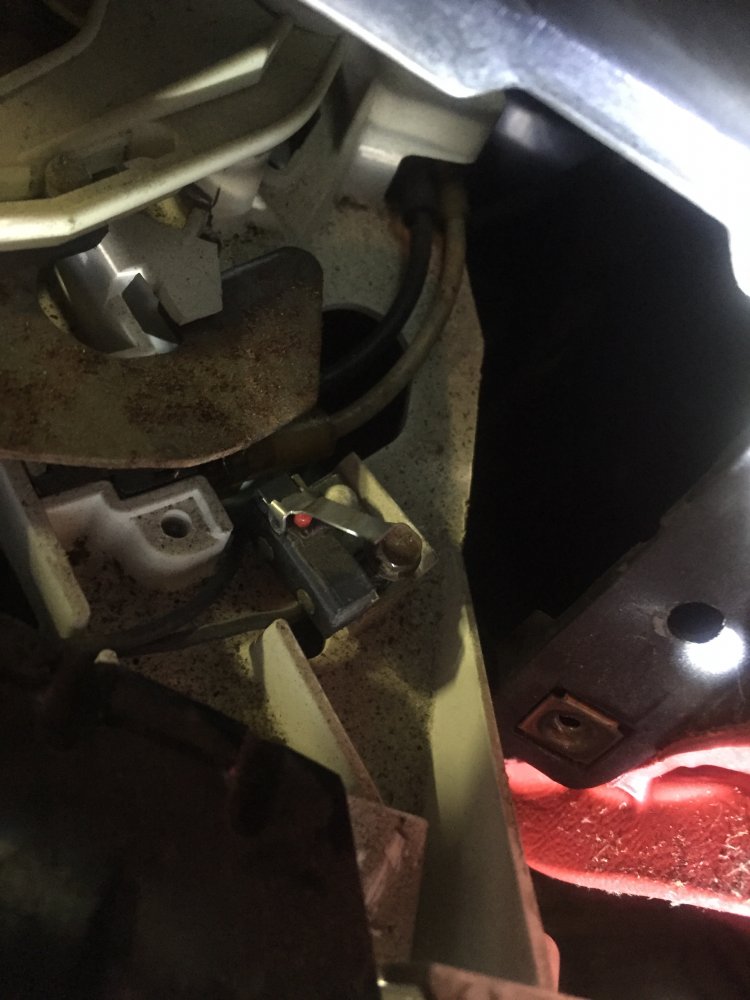

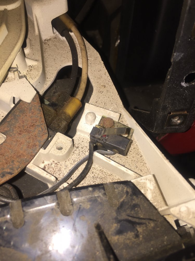

Spent yesterday working out a bug on the 89. I’m using my old deleted a/c power circuit to power my light bar. Defrost was turning on my lights. Found the switch and disabled it.

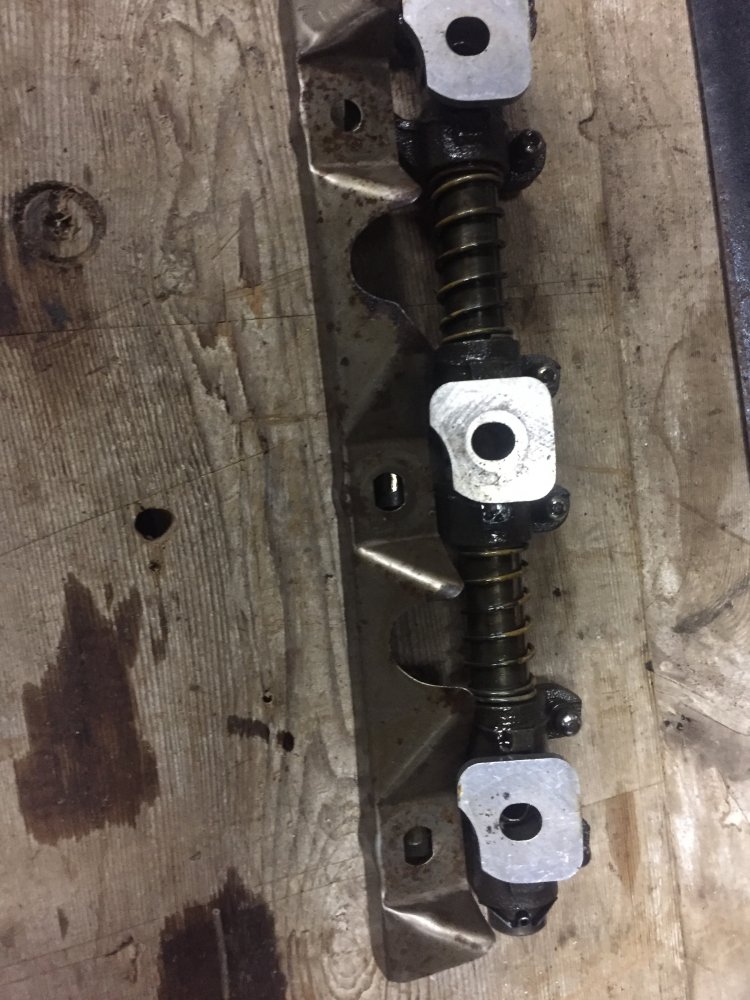

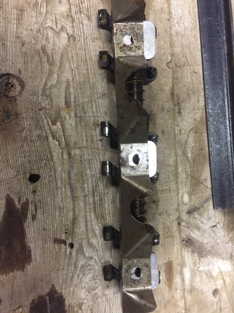

Then decided to put the baffles on the rocker arm shafts on one of the 85s. Found the shaft stand are not the correct ones and won’t allow the baffles to fit.
Today I’m kicking my own arse for scrapping a ton of parts I should have kept. What was I thinking🤦🏼‍♂️? I scrapped two engines that had the shaft stands. Oh woe is me.
So now, do I grind off the excess material on the stand bases to fit or do the right thing and disassemble them and see if the shaft bore is even the right diameter? I’ve been fighting a valve tick. This could be why. Or just go spend the money for new ones. I don’t know 🤷‍♂️.

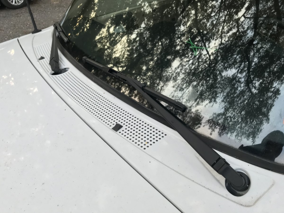

I pulled the wiper arms this week and repainted them. Flat is too flat for OEM look. It’s probably supposed to be semi gloss or one notch flatter than that.

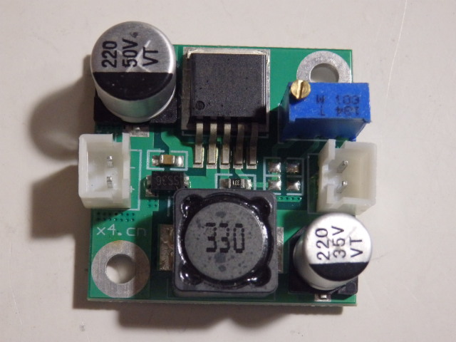

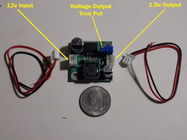

Buck converter arrived over the weekend. Still waiting on the LEDs.
View attachment 67516View attachment 67517
Tested this little booger & it works great ! LEDs arrived @ PO bx this morn.

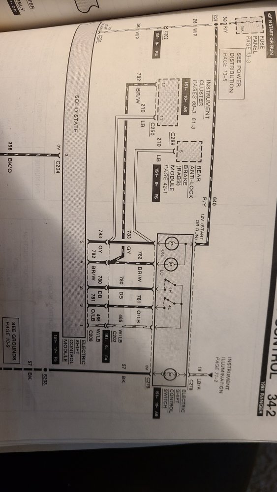

I haven't gotten around to take a VOM to the test the wire harness that's behind the phony vent. I know its for a switch for trucks with FWD but does anyone know what's
available ( 12v constant, 12v acc. , etc ) on it ?
Yes my a/c button has been repurposed. On my rig when you push the a/c button a small orange light comes on there on the climate control so it even tells when it’s on.

That would be connector C278 in this diagram. With fuse #7 installed, you should have 12v on the red/yellow wire with key on. Ground on the black wire. The rest is pretty useless without the rest of the 4x4
system.
When I painted mine a few years ago I think I used a satin or semigloss. they turned out pretty good.
system.
Thanks Erik. Now I'm thinking of tying into the cigarette lighter circuits. I'll have both there. The lighter is constant + the ashtray is illuminated.
