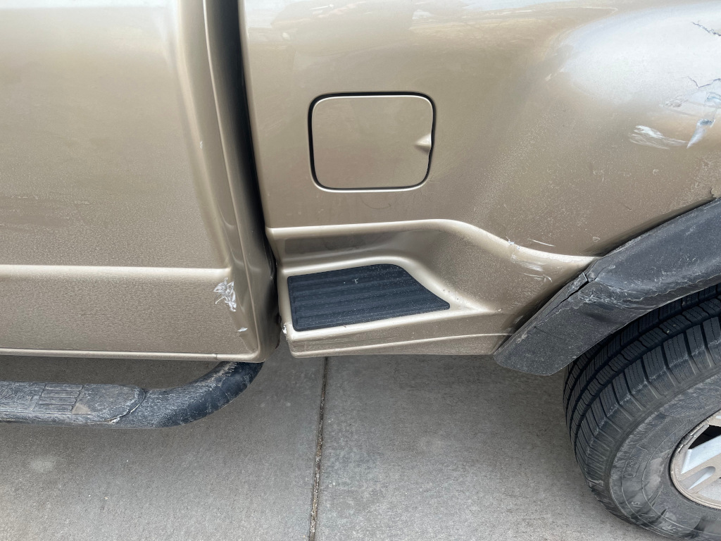

Hit and run, Friday night 28 February 2025 while parked in a very dark parking lot near a car wash. Of course what to expect here in Colorado.
Witnesses thought only the rear bumper was hit. That would have caused no permanent damage since I built that rear bumper out of a 6” wide steel channel iron.
Now 2 March 2025 in full daylight I can see the extensive damage primarily to the left side of the fiberglass bed. Shredded the left rear fender. Bent in the fiberglass near the cab. Also dinged the paint at the rear left corner of the cab.
Reported to insurance company. I do have insured motorist coverage and rental car coverage but what a nuisance.
Wouldn't be so bad but I had to have that same fender fixed from a Home Depot parking lot back in 2015.

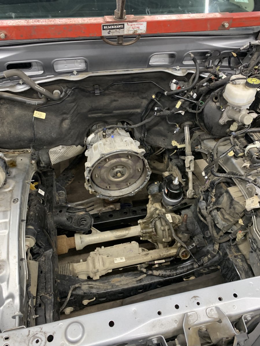

Pulled the engine…
I think a coyote will fit in there.

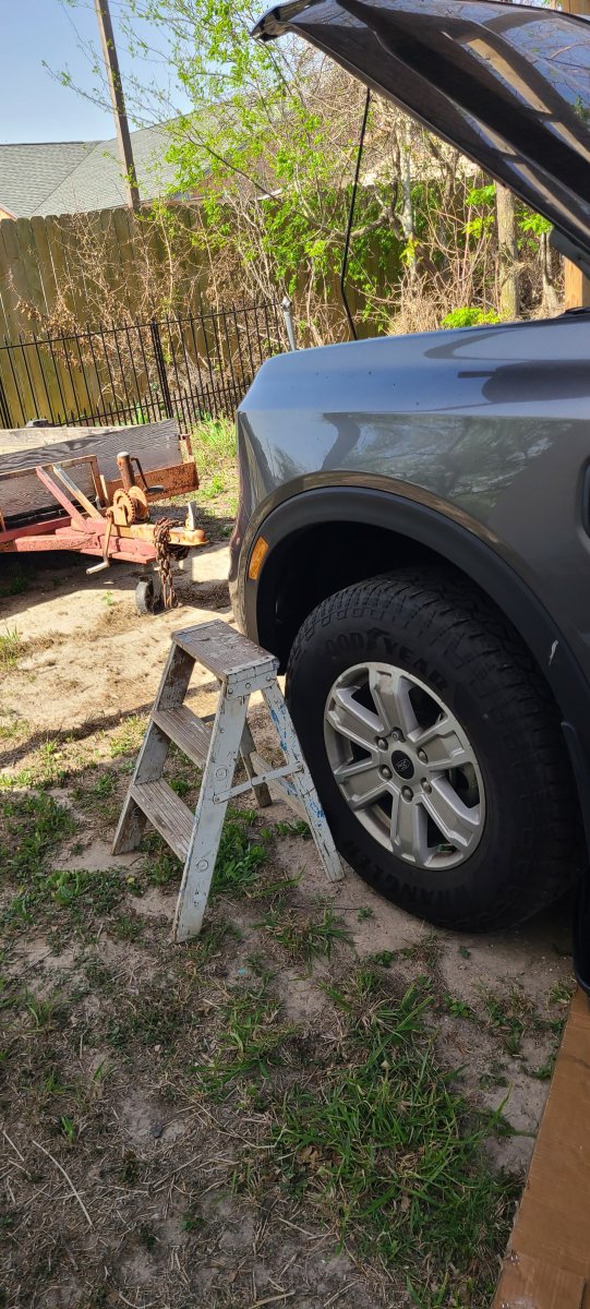

Did the first 3k mile oil change in the brand new 2024 2.3 ecoboost ranger. Not nearly as bad as people make it out to be, really, not bad at all. To me, very similar to chnaging rhe oil on the 3.0 in my 04.
First thing, you need a small step stool because they don't make trucks any kind of normal height anymore.

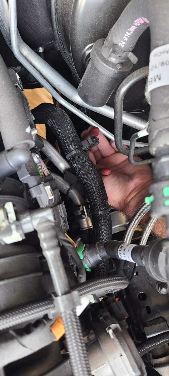

And this is not a lot of pictures kind of deal. Everyone has done oil changes. I am just showing qhere to out your hand for the easiest shot to the oil filter.

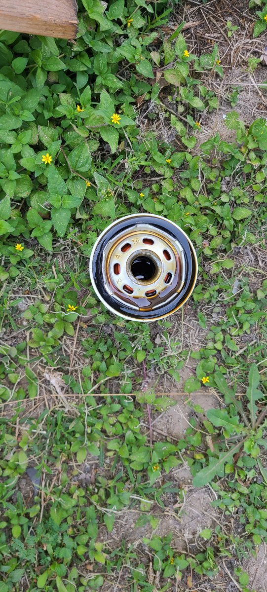

Ok, next, i tried to get the filter off but the dang factory torqued that sucker down so tight i couldn't get it to budge. I ended up getting some filter pliers and breaking it loose and than i could spin it off.
Ok, first, i tried with my right hand and my elbow and wrist just dont bend the correct way so ince i changed to the left arm, all was well. Anyways, you see where to go right down between everything to get to the filter.

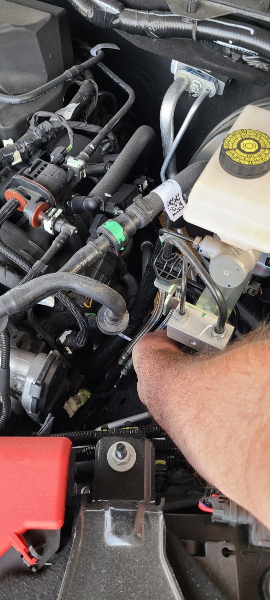

There you see the left hand can grab properly. You tilt the filter and it slides right out. There is a cool little tray snd oil chute, like i think the 3.0 has, that drains the oil away so it doesn't get on everything.

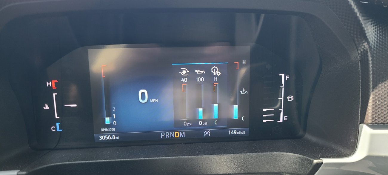

And i found a cool gauge cluster screen setting called off road. I have a 2wd so i was surprised the off road screen works but it gives me gauges for oil pressure, trans temp, and i think boost pressurr but maybe its hurricanes in the area?
I like the trans temp for when towing
