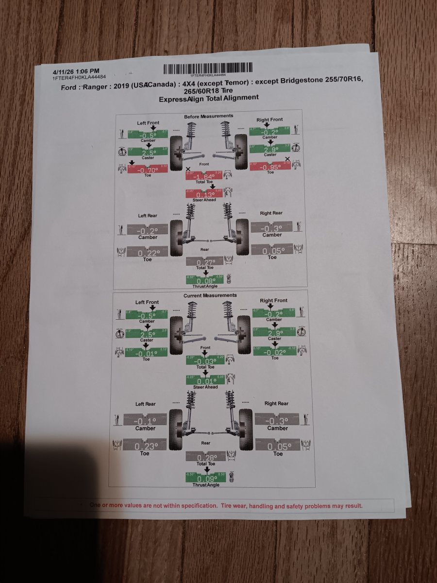

The 2019 got it's new steering rack programmed or, I should say the truck was programmed to accept the new rack and it's different firmware.
I also had them check the alignment while I was there. The two tape measures and a couple pieces of metal angle did a pretty good job, less that a degree off.
