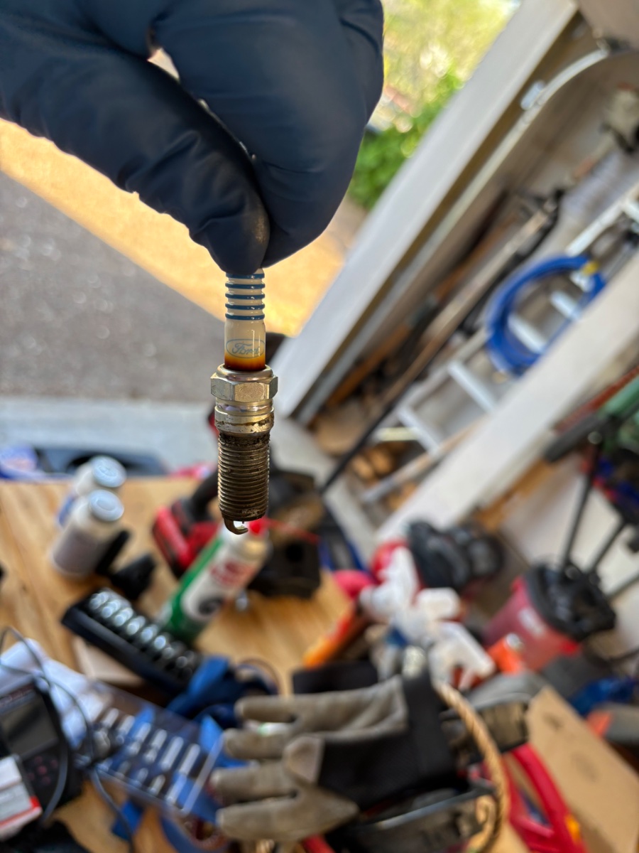

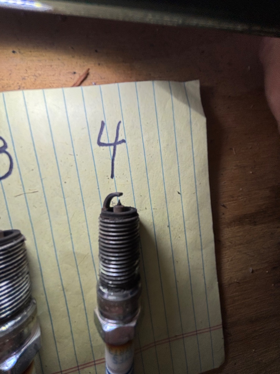

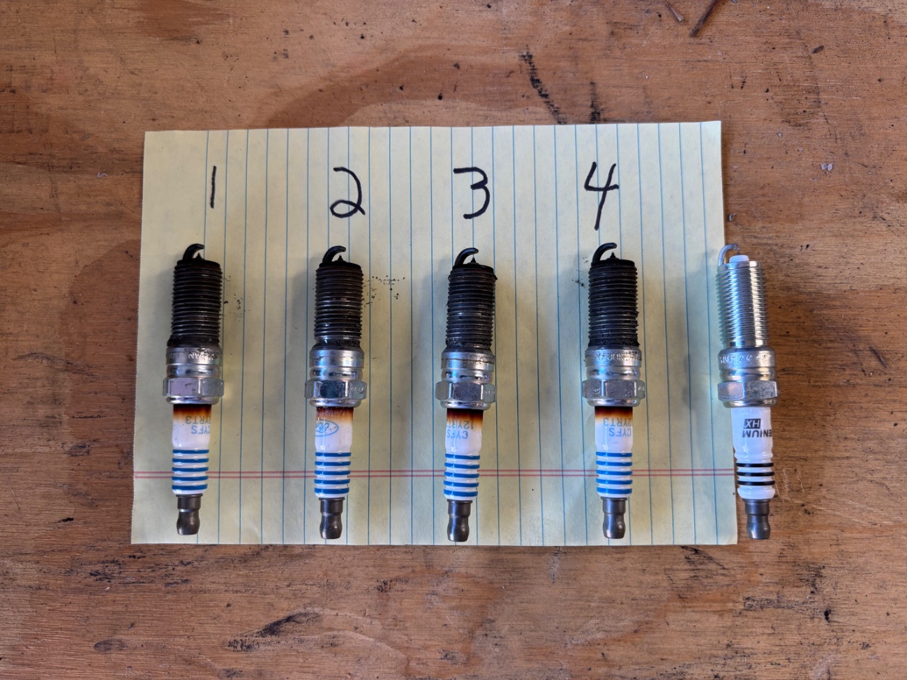

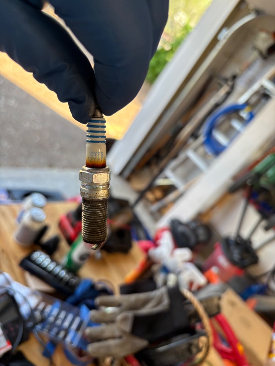

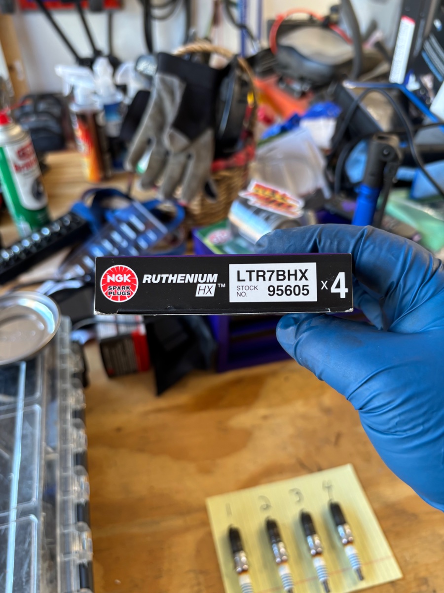

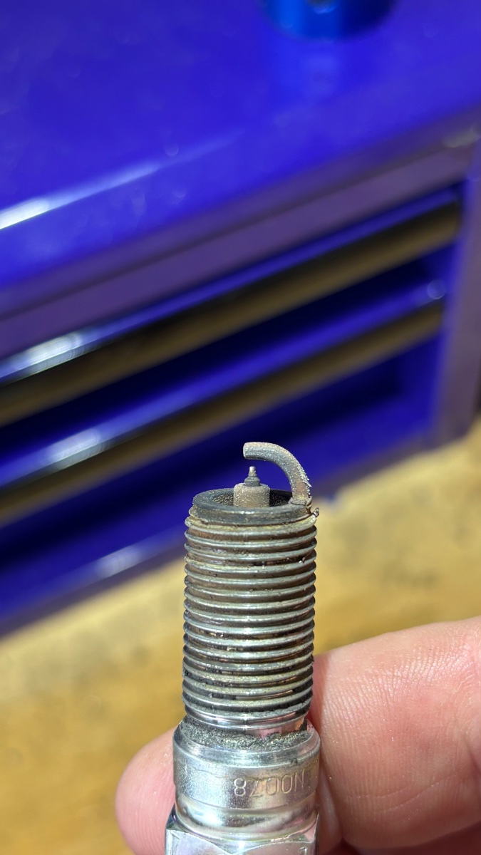

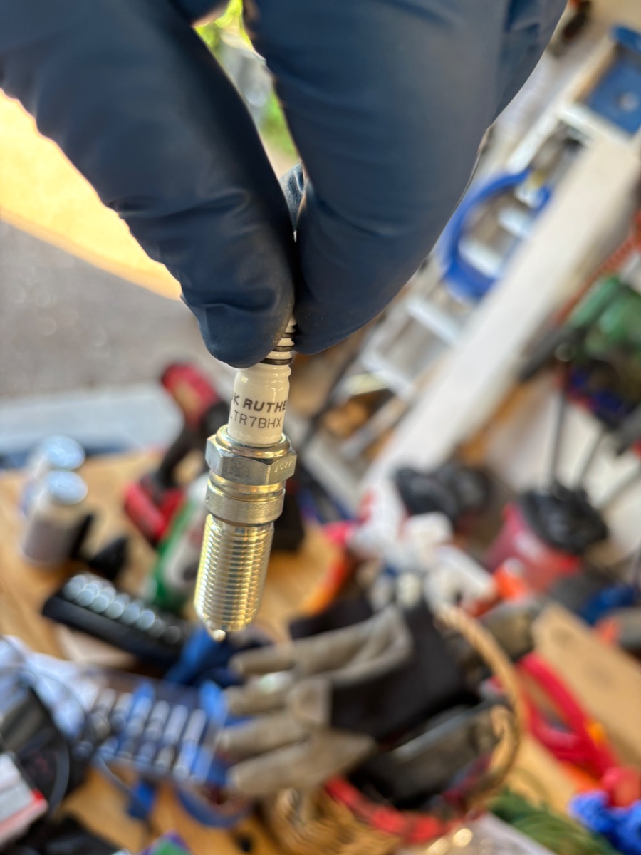

I changed out the spark plugs this morning and was wondering what people thought about the plugs I pulled out of the Ranger. 88,000 miles. Changed the plugs out to support the tune. The tune is incredible. Love how the truck drives now that I have driven it for a few days now.
View attachment 141362View attachment 141363View attachment 141364View attachment 141368
Also, 1 and 2 were very difficult get out. I thought I was going to break 1. 2 would move a little and stop move a little stop. 3 and 4 were easy.
Same plugs I got. My old ones weren't that black though. Do you do a lot of short trips?
It may have been but it’s previous owners. But not with me.
Those look VERY black to me. Weird that it seems to be in the threads so much too...
I don't like how dark those plugs are. Odd that #1 and #2 were the hard ones to pull out. Usually, it's be back two, especially if you have a cowl leak onto the spark plugs, like some have had with the 2019-2023 models. Hopefully, things will be better with the next change and it is purely how the previous owner drove the truck.
Mine didn't look too bad at 100,000 miles when I changed mine.
