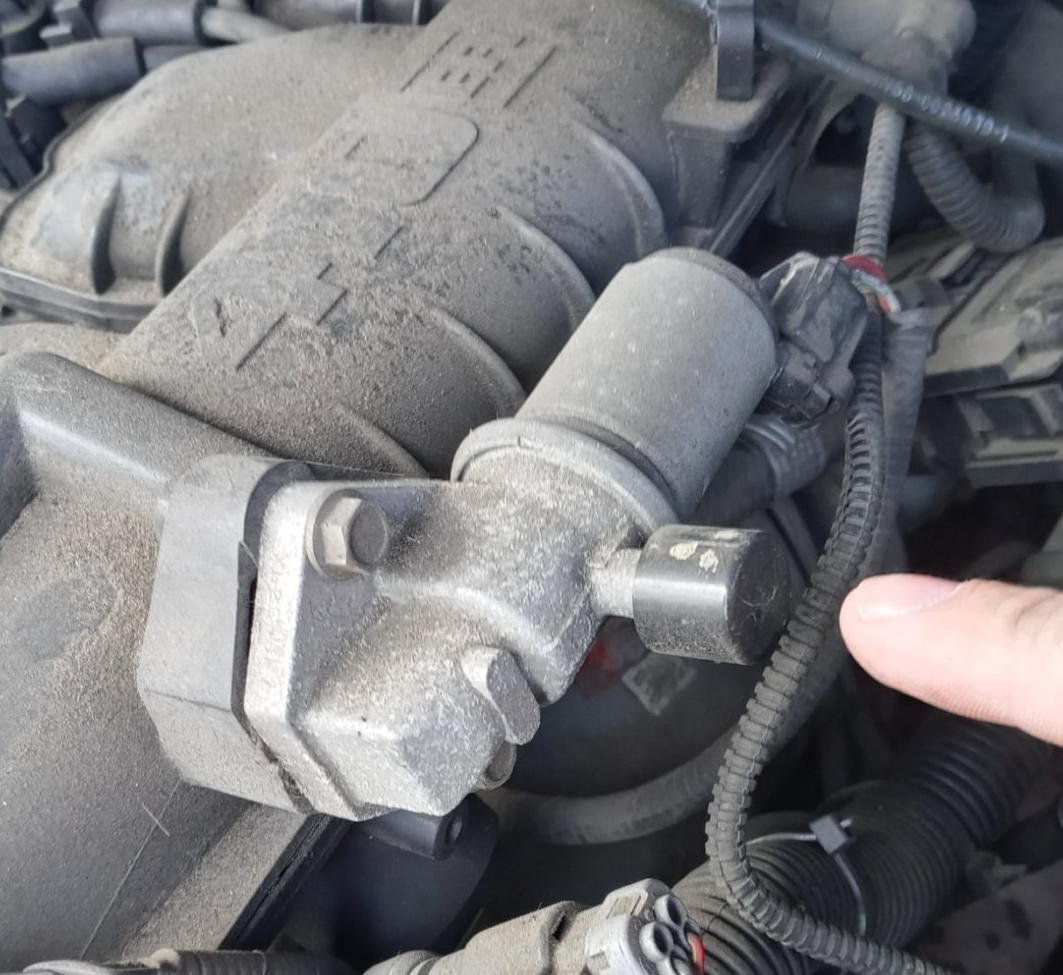

I unplugged the IAC while the truck was running and the idle dropped down a little but it didn't stall. I took it off and cleaned it keeping the motor upright. I'm not ready to replace it yet as new ones are $75. It seemed to run a little better and the idle didn't drop down at regular intervals like it did before. Does anyone know what the big black knob on the side of it is for? See attached Pic.
  • What causes idle to drop slightly then back up? - 2000 B4000
That is simply an air vent cover.
