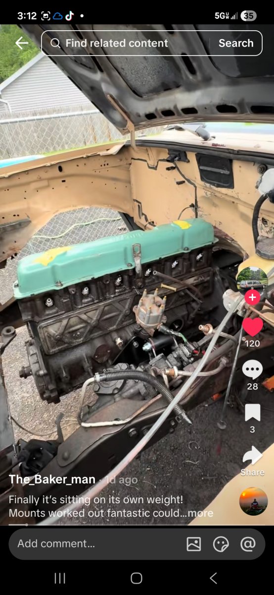

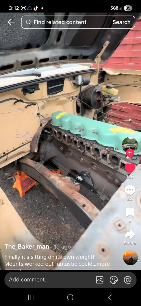

A guy in New York, tiktok name is The_Baker_man, is doing the ford 300 I6. He's got the block in and didn't have to stretch anything.
