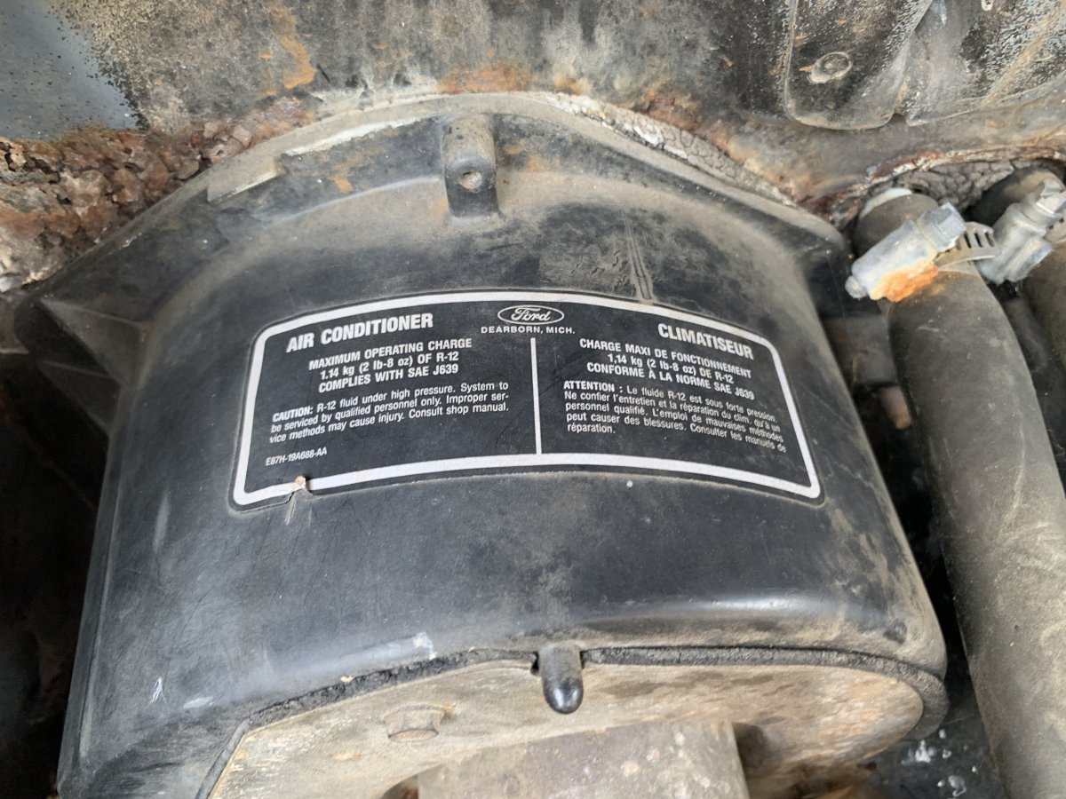

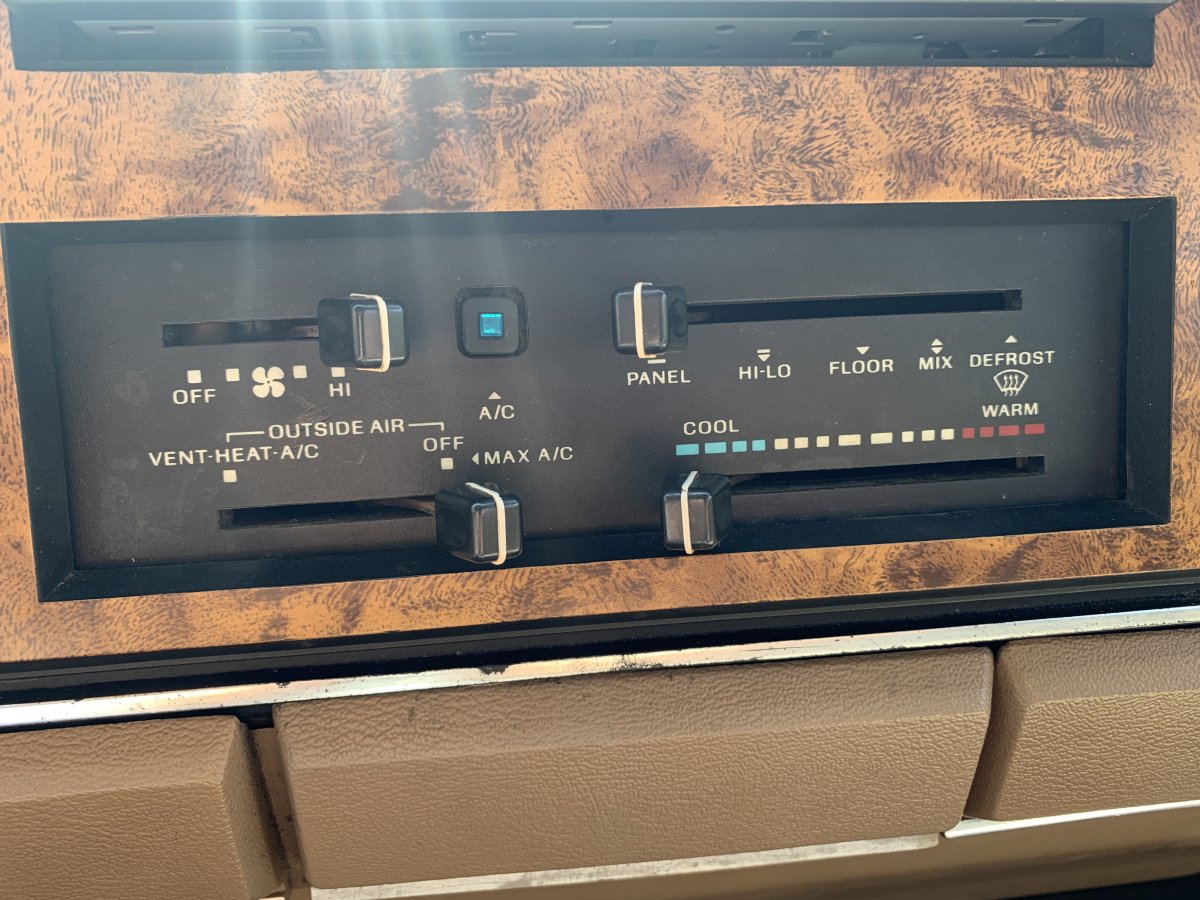

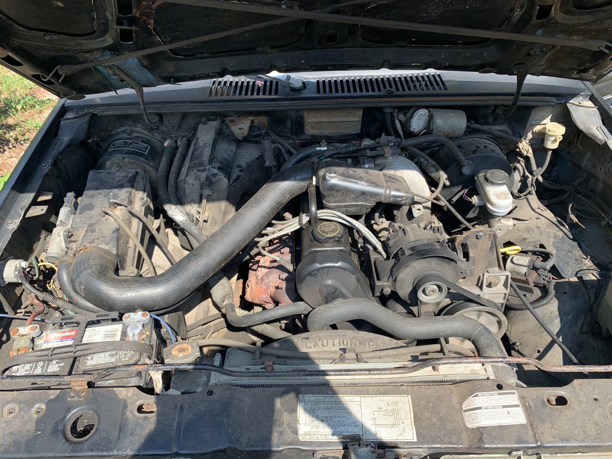

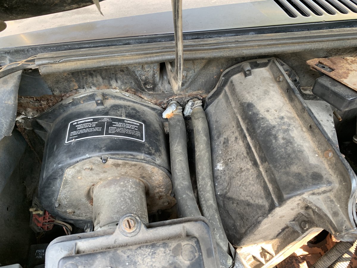

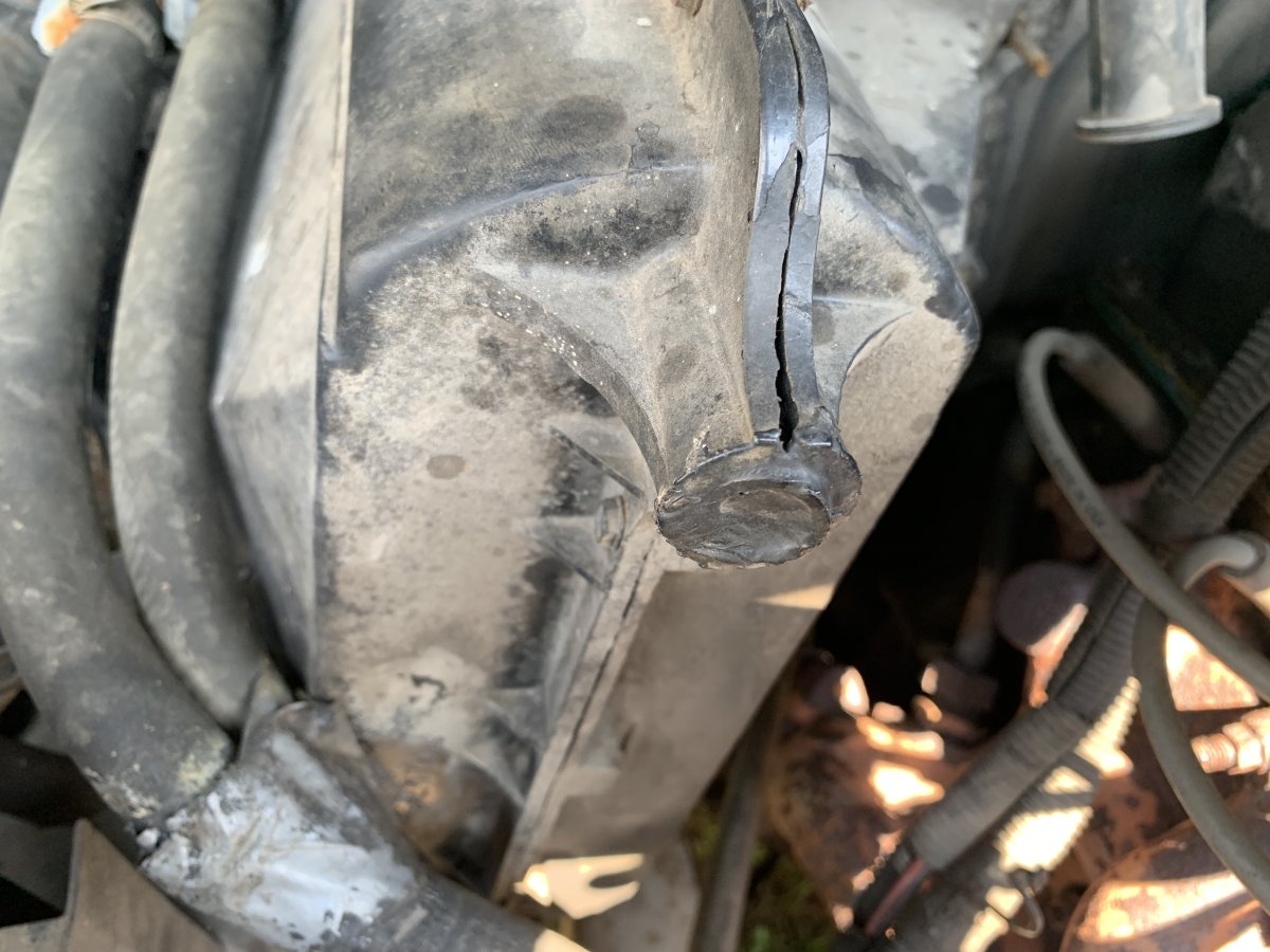

When I purchased this truck the previous owner told me it never had AC. But from what I understand it seems like it did at one point. Did someone rip out a bunch of components and alter things? Can anyone confirm for me and maybe tell me if I have options of getting AC back again and what that would entail. Please and thank you.

Yes, it had AC, and "some" of it is still there.
It looks like AC was an option on that trim but was never installed, so not something removed by previous owner
The heater box would have the old evaporator still inside with metal tubes sticking out like this pic:
Even if someone remove compressor and hoses and condenser(in front of radiator), there would be no reason in the world to remove the Evaporator
Yes, would be a lot of work, but doable on any Ranger
Hard part would be to install the evaporator(have to pull that housing off the firewall) and finding the brackets for the 2.3l Compressor
My guess is someone at some point replaced the heater box and that's what they found? The sticker looks to be an '88 part number at least...
My '97 Ranger has blocked off evaporator port holes in the heater box so it's just got a bunch of dead space in it but I think there was only one heater box by that time... On my '90 I'm on like the third heater box but it's always just been the non AC version...
Look at the belts, if the water pump pulley has two rows of serpentine belts and there's a bracket under the front end of the exhaust manifold which is where an AC compressor would mount there's a chance it did at one point have AC... those things were not on the non AC versions...
The charge sticker and an AC HVAC control head makes me think it was originally equipped. Maybe a repair after a front end collision in the past the condenser and compressor was ditched, but most don't go through the trouble of removing the evaporator.
Very likely had A/C. I would about guarantee it did from the factory.
It has the evap housing for sure obviously. The evaporator probably plugged up with who knows what and got deleted in the name of better airflow. Been there, done that personally.
You have the button on the dash which is kind of an obscure thing for someone to go out of their way to change. If not factory A/C it wouldn't have the button. If dealer added A/C it would have a different button (usually round and cheap looking)
Kinda neither here nor there but it looks like you have the full A/C style fan shroud as well.
For the most part you need all the stuff you would need to revive a dead system anyway. Evaporator, drier, orifice tube, compressor belt and probably a condenser. It might be lurking under the rad support and it might have been capped. Probably not but a guy can hope.
