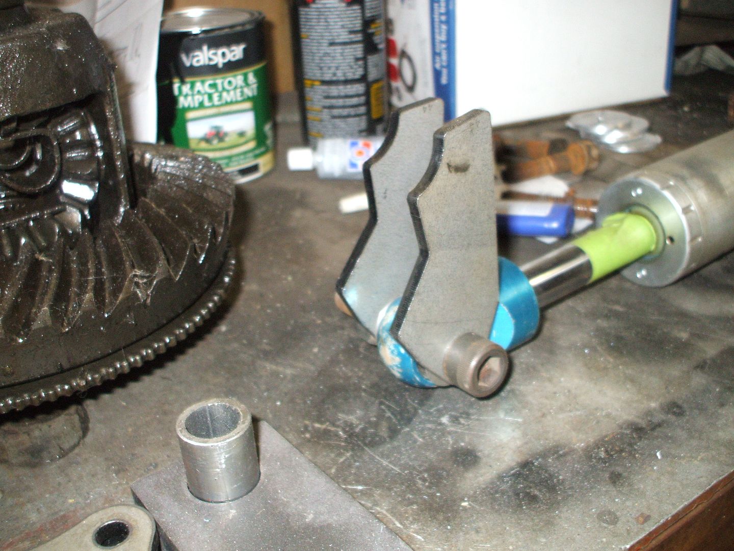

I got my lower coilover brackets from Ballistic that fit the D44 knuckle.

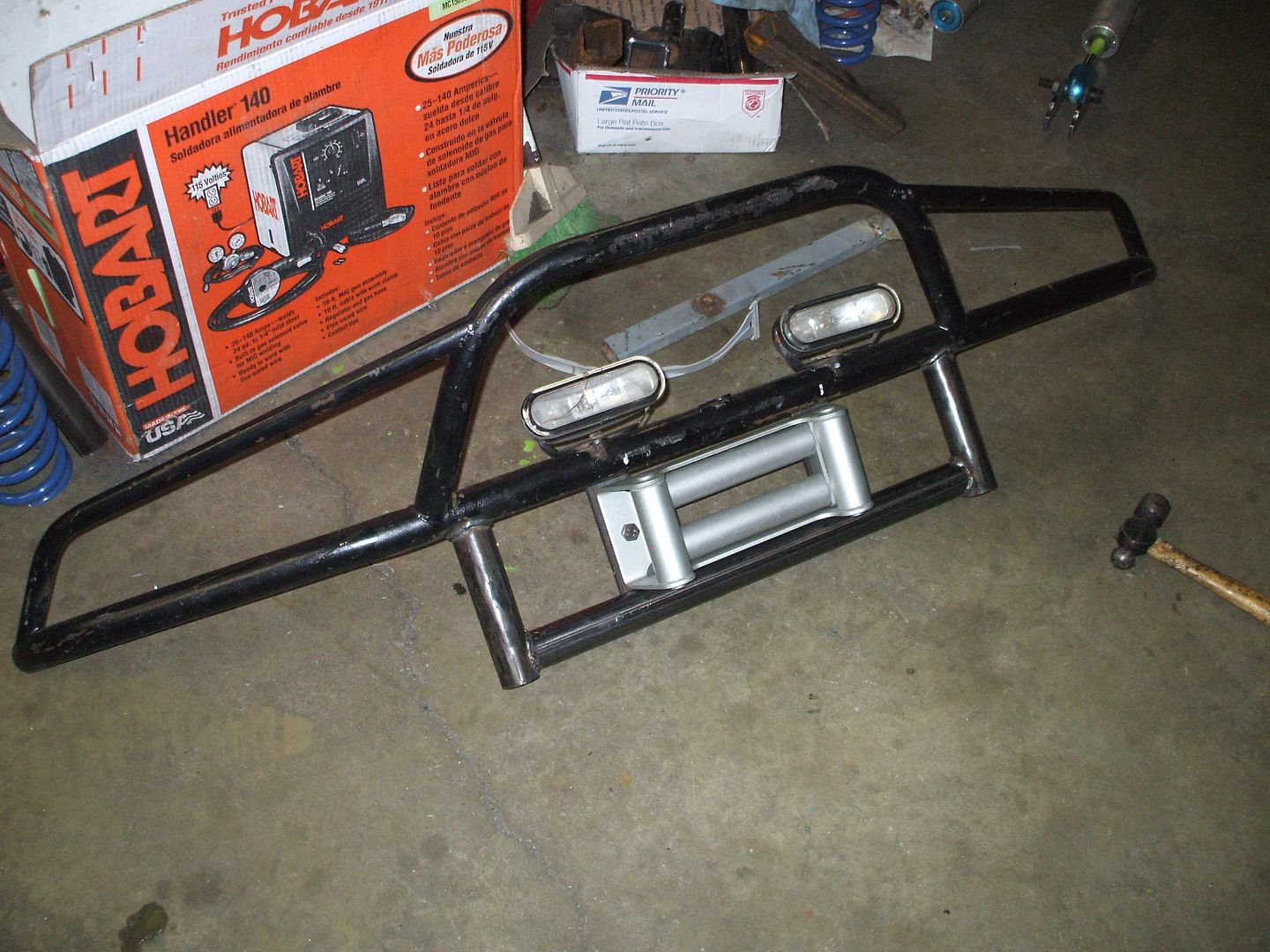

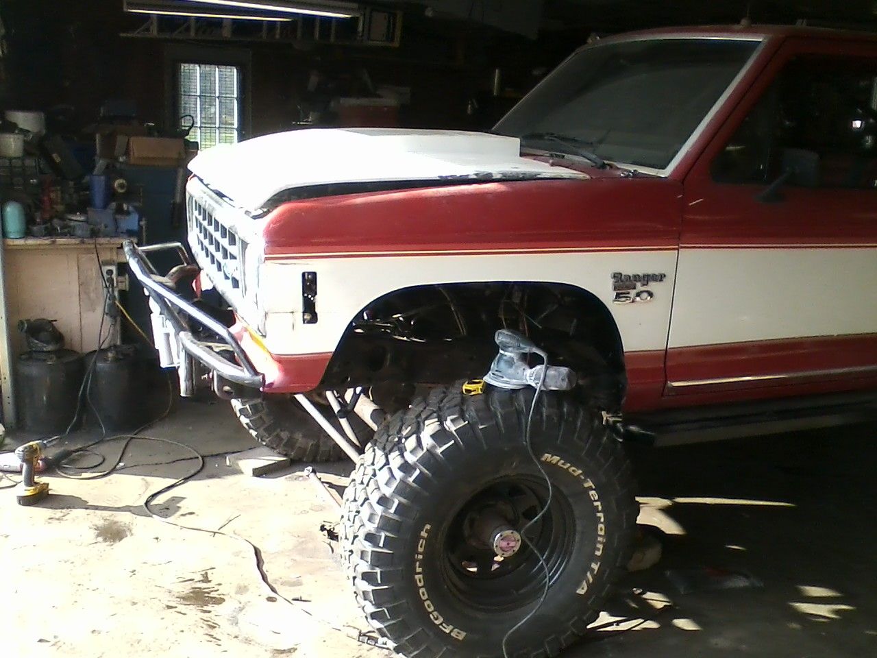

Wish I had a "before" pic of my old Bronco2 front bumper but I forgot.I chopped it down and cut it up a little and refit it so it works on the Ranger now. Turned out great and the tube bumper looks awesome with the other tubing.

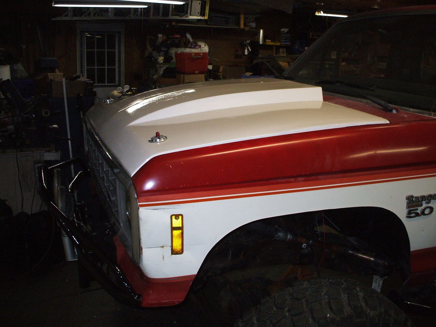

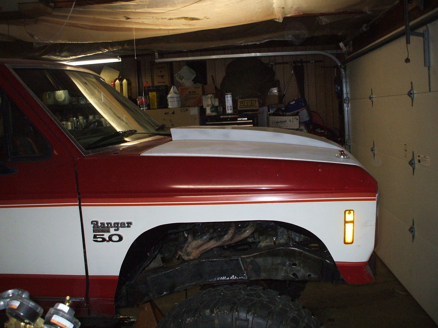

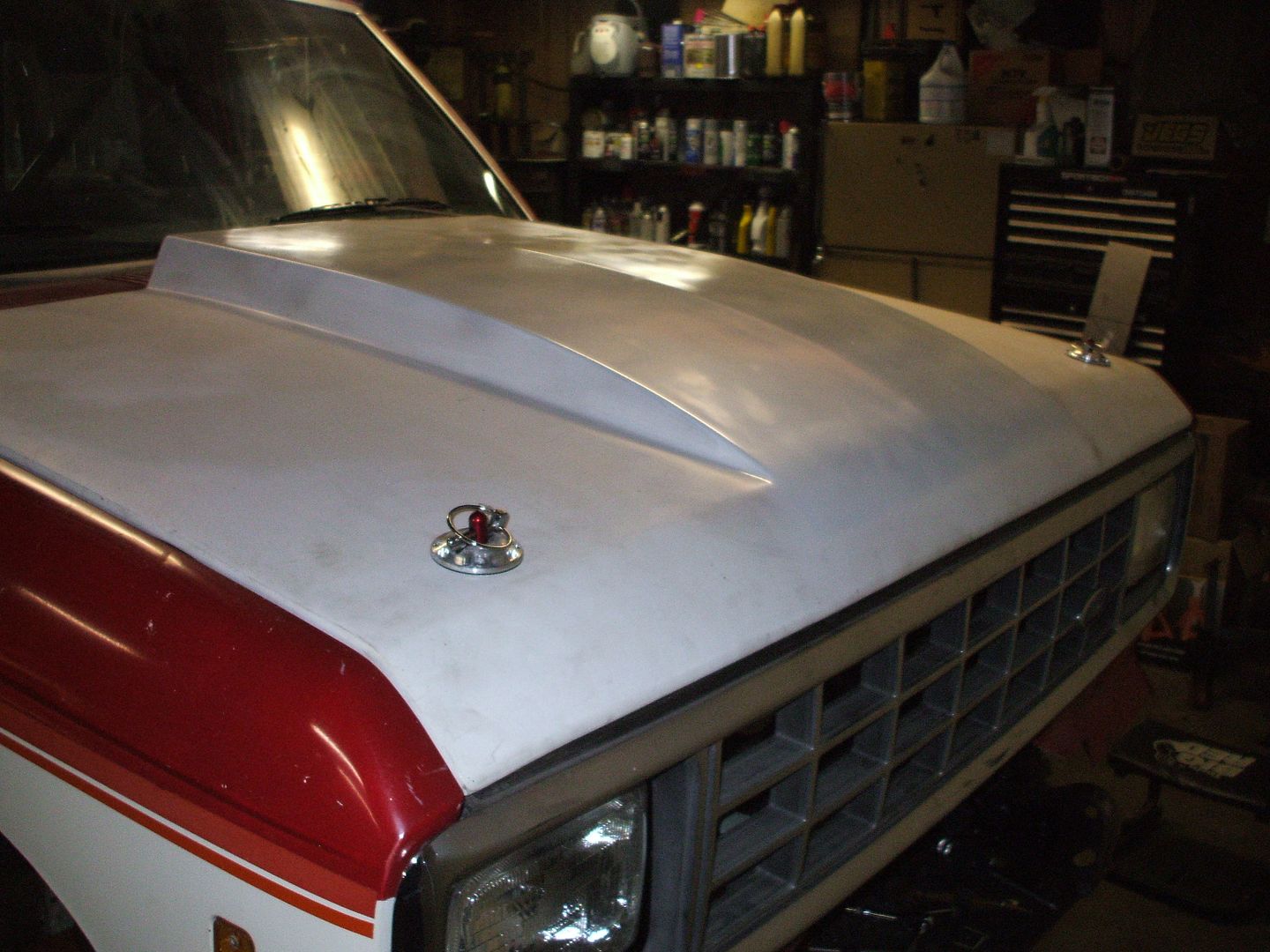

I bolted up the glass hood and got it all lined up and installed the pins. Had to add some fiberglass filler to one edge and after its sanded down I will hit it with some fresh white paint.
Bumper installed. Paint is dryin as I type.
what kinda winch are you planning on running?
I have a Smitybilt xr8 right now but I plan to buy a Warn Powerplant in the spring and move the XR8 to the rear.

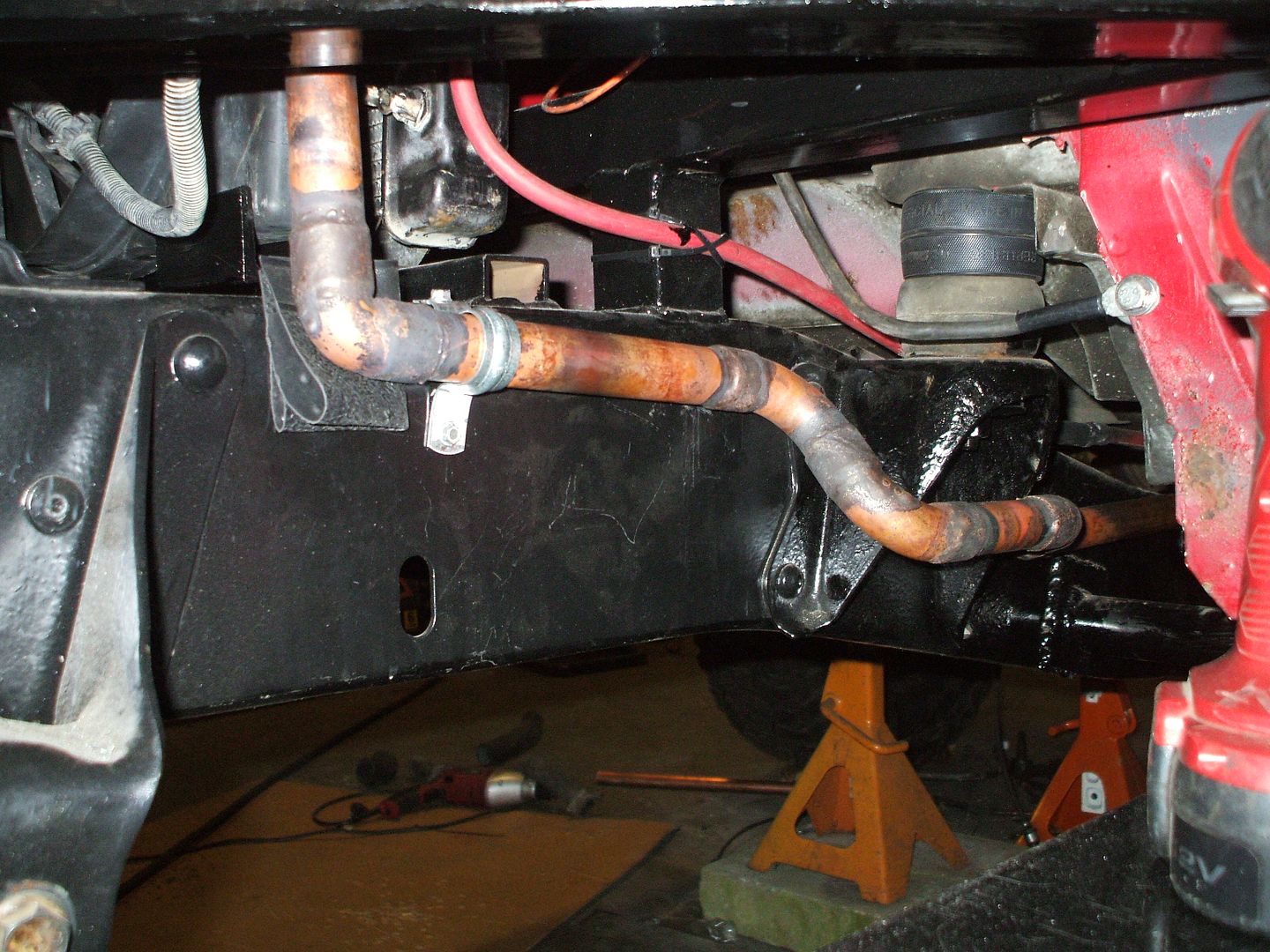

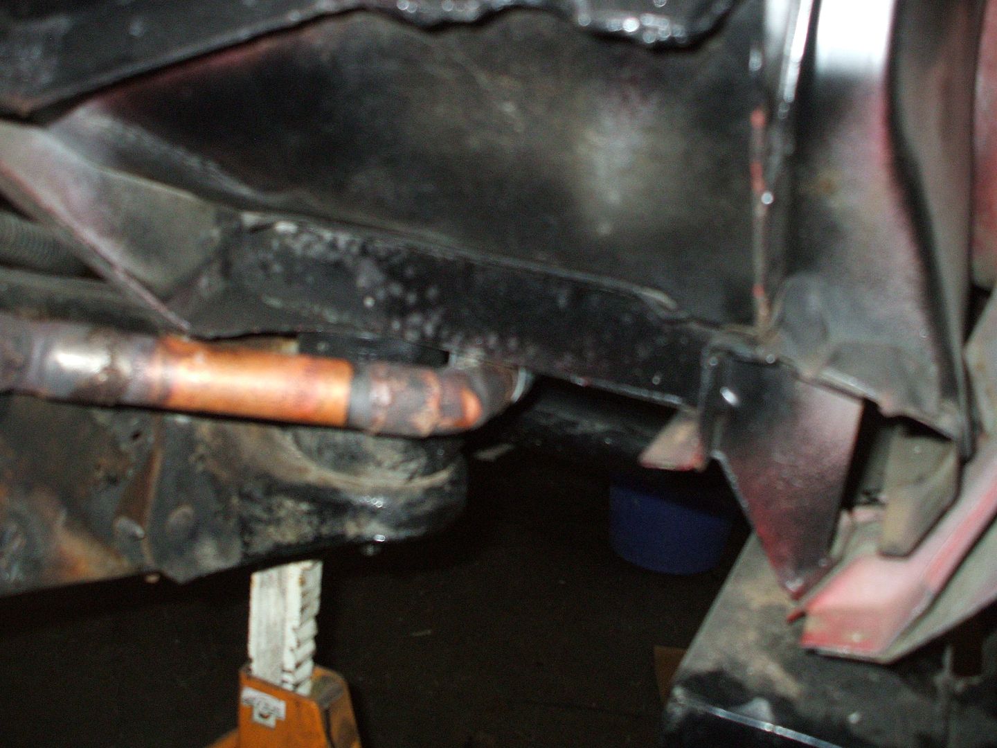

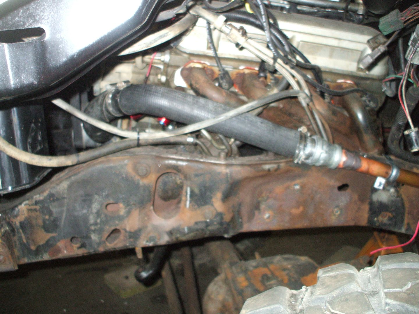

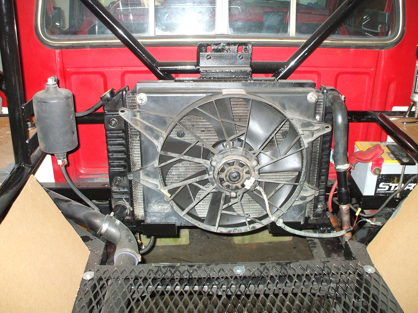

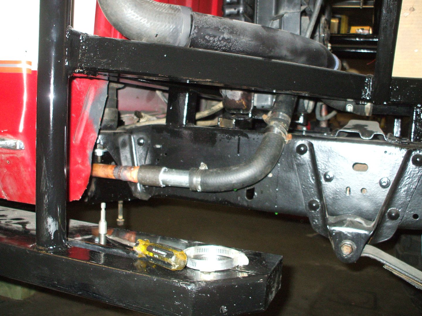

Went and got a bunch of 1inch copper stuff and my buddy and me got the cooling system all plumbed. No leaks!
Here how it turned out following the path of flow...
Also finished the hood.

Glad you went with copper, but I would have used a little larger diameter pipe, you might have issues with high pressure due to the smaller pipe. If you have hot temps when you run it, it's most likely be to the reduced flow. I'd increase it to at least 1.25". Other than that, it looks great, keep up the work!

Well strange as it may sound I wanted to use 1.25 but I couldnt find a single place in town that had any! I could get 1inch everywhere so I went back and did some research online and found quite a few people who are only using 1 inch I.D. pipe,tubing or hose and they reported no issues. If I run into issues I will change it latter but for now its done and we shall see! My only real concern is since I work rite outside of Detroit Im wondering if I should paint all of it since there is over 200.00 in copper hanging in plain site!
Not taking any bends into account (which will affect this system's restriction more than the diameter of pipe) a 1", 1.25", 1.5" pipe will add 0.7psi, 0.4psi, 0.1psi restriction to his cooling system. Assume 20gpm flowrate and 12ft run (6ft there and back).
You could also double up and run two 1" pipes with a Y at the hookup points...

Right now Im not even worried about it. Im taking my underdrive pulleys off and putting stock ones back on to speed up the pump at low speeds.
