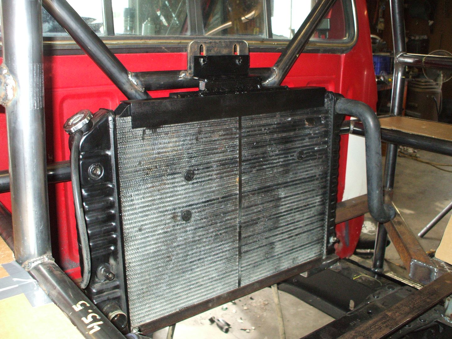

Here is the rad mount without the fan on it.

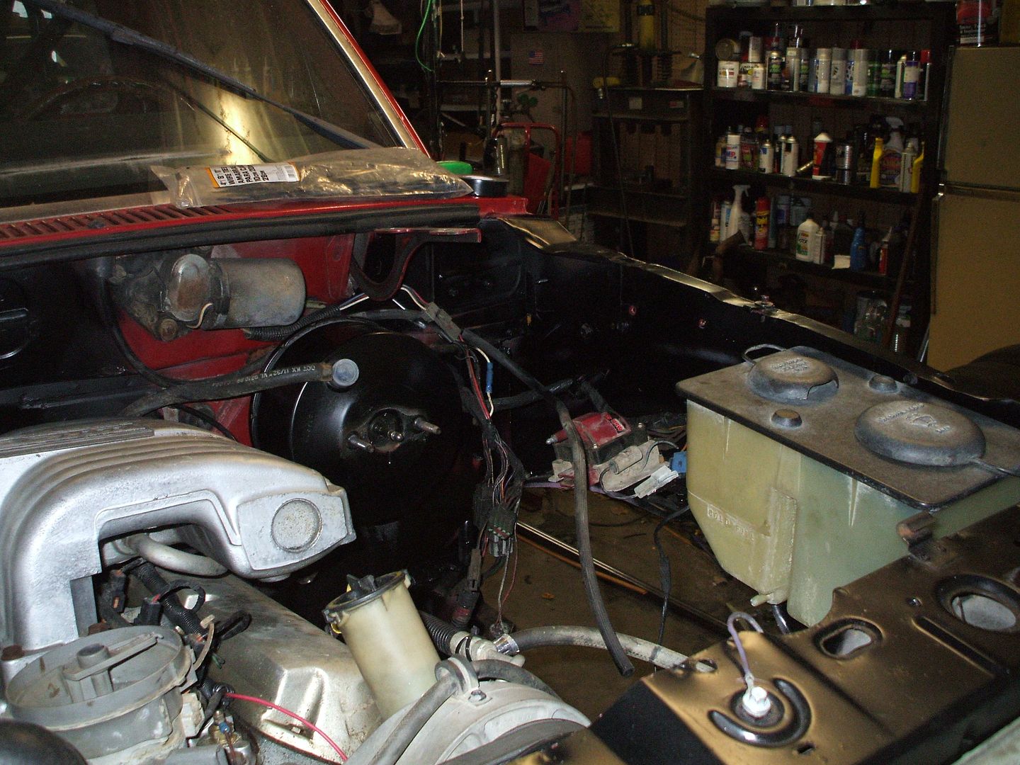

Got the chassis harness hooked up today and the lights all work.

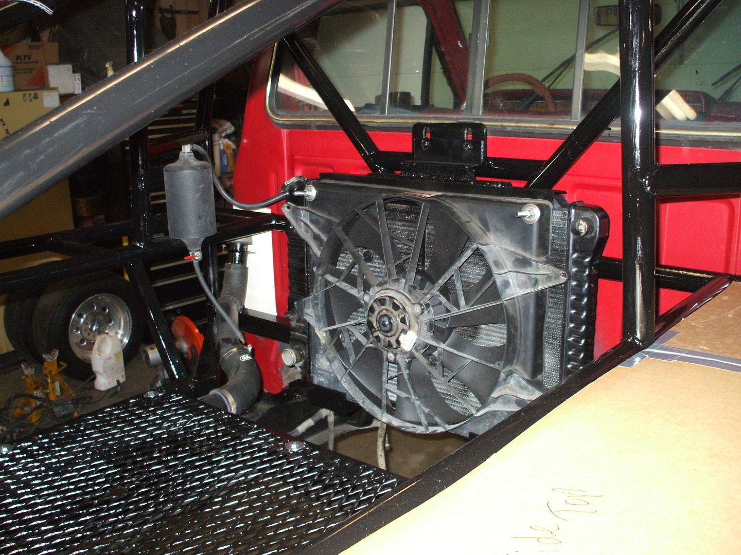

And mounted up an overflow for the rad.

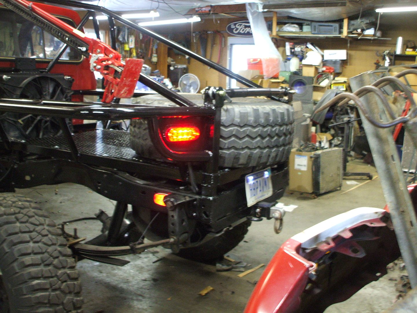

This is going to be really cool when it's done... A few questions though.. Do you guys who build the truggies take note on how heavy you want the bed to be? I know the Ranger bed is light as crap and some of the built beds look even lighter... How does traction workout on the truggies?

I have not weighed anything yet but Im sure the rear of mine gained weight over a stock bed.

Anyway today I finished up the interior for now. Harnesses done,headliner out,auto pedal essembly in,booster in and stock seat belts reinstalled for street driving.Also got chassis wiring done so all lights work,wipers work,overflow/windshield washer bottle works.
And I got the fan mounted up so I can start wiring that.
