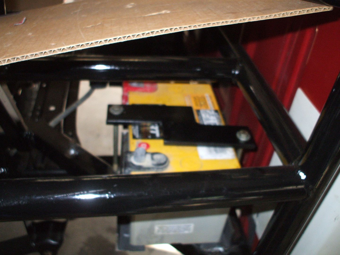

And built my tray for the primary battery.
you gonna cover the battery? it's gonna get all sorts of dirt and junk flung into it on the trail

When I get my sheet of aluminum for the bed I may make a panel to protect it.....or I might just leave it.
You could also get a plastic cover used in marine applications
What you waiting for, get that aluminum already :thefinger:
