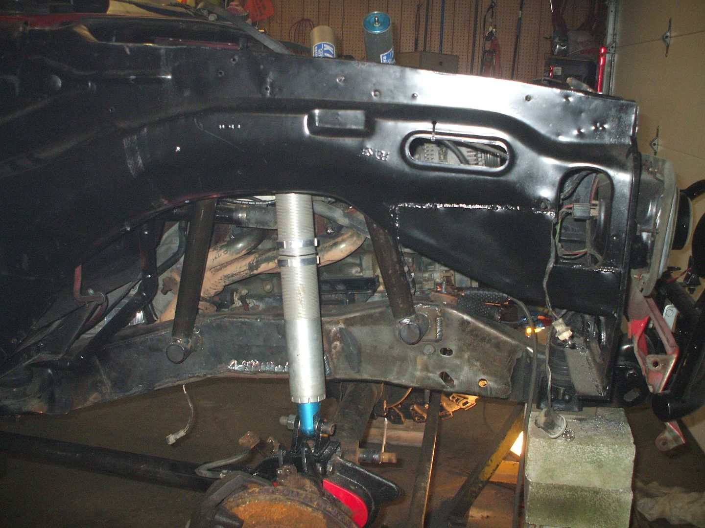

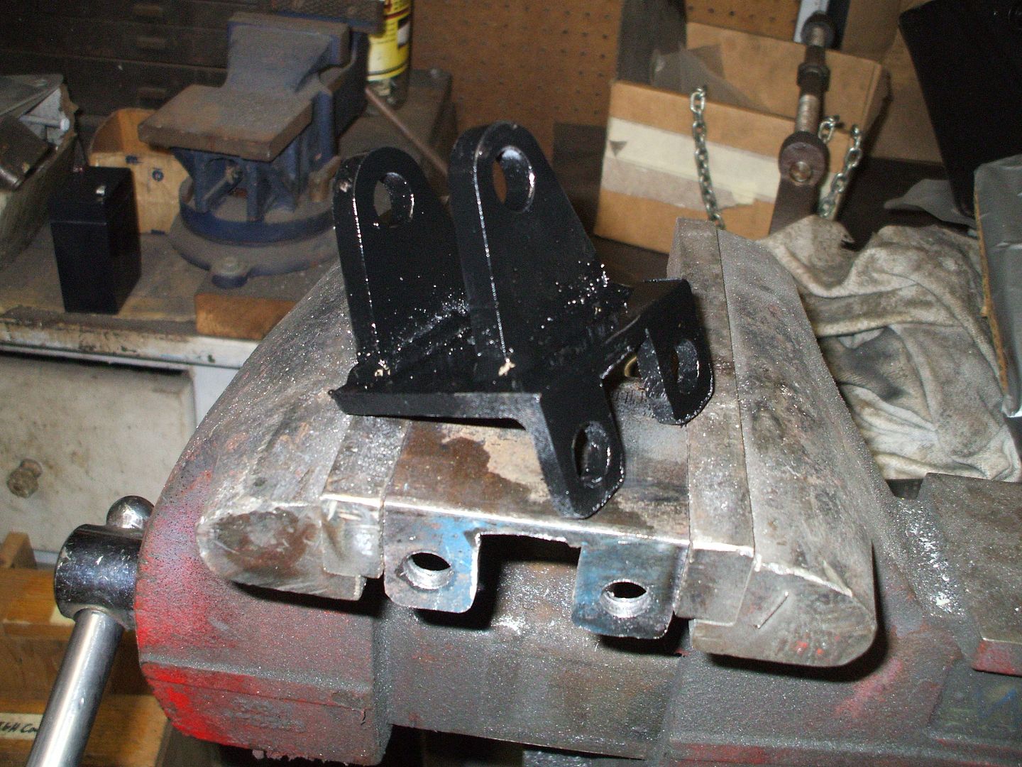

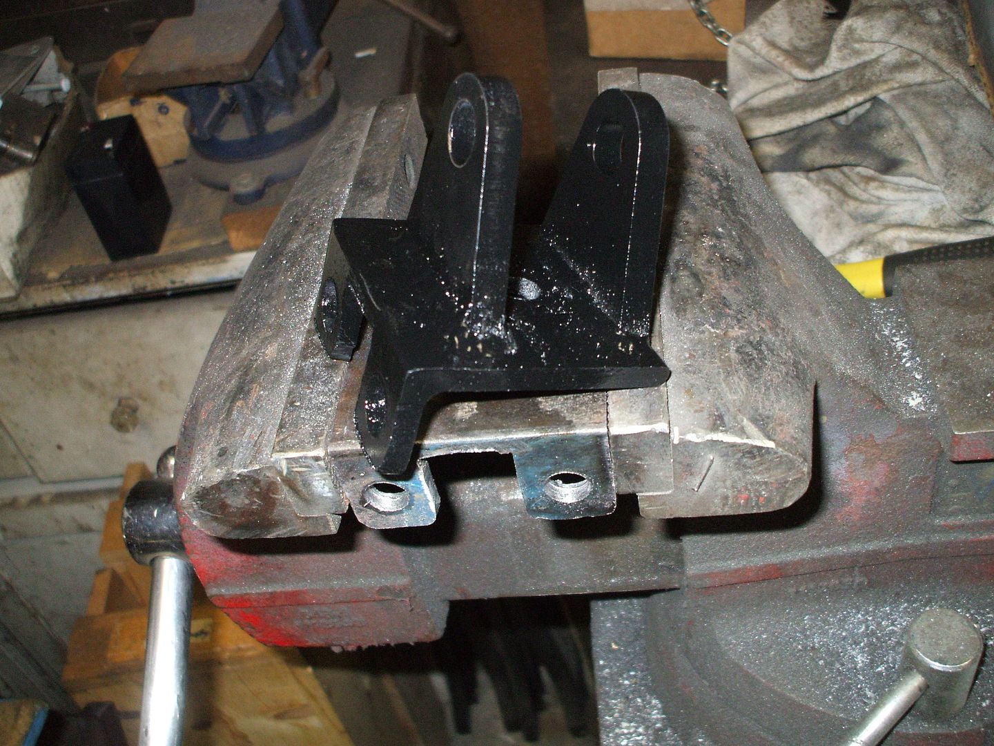

Turns out the lower coilover mounts wont work. The caster angle was to much for the lower misalignment bushings in the coilovers and they would of had to be mounted leaning back almost 15º to stop them from binding. So I built my own lower mount that uses the top two wedge bolts and one of the coil spring pad bolt holes. Coilovers can now sit at 5º rear and 5º in.

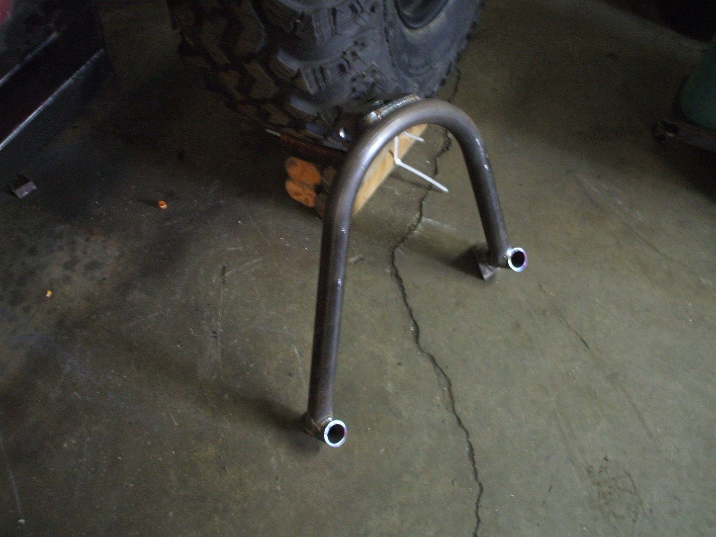

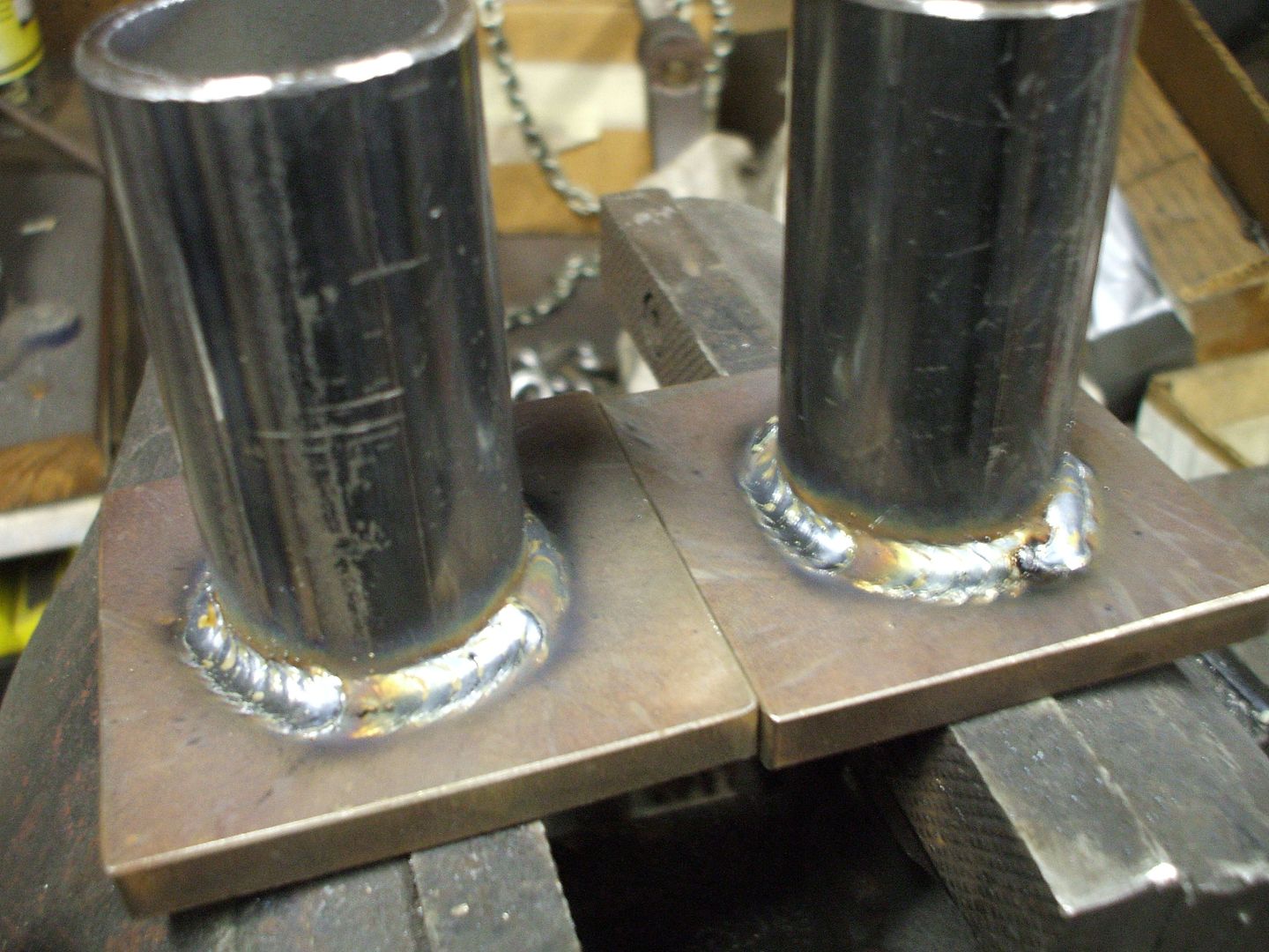

Then I made 4 stands to weld to the frame for the hoops to sit on.

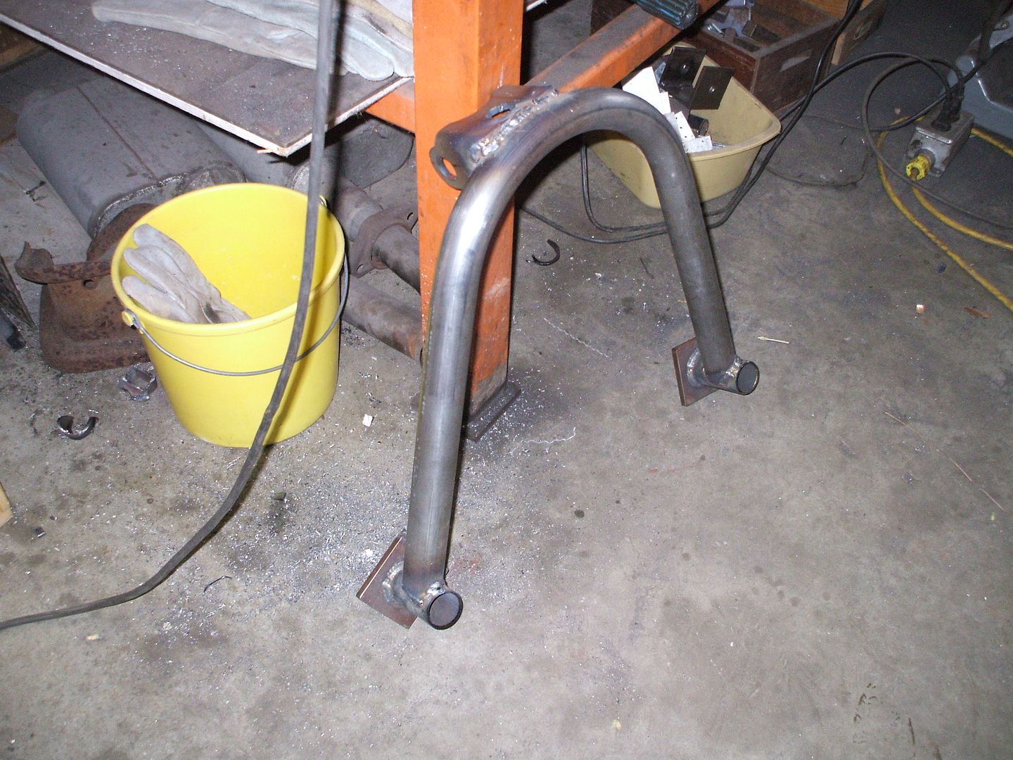

After a whole day of mocking the coilovers up getting the right angles I welded up the hoops.

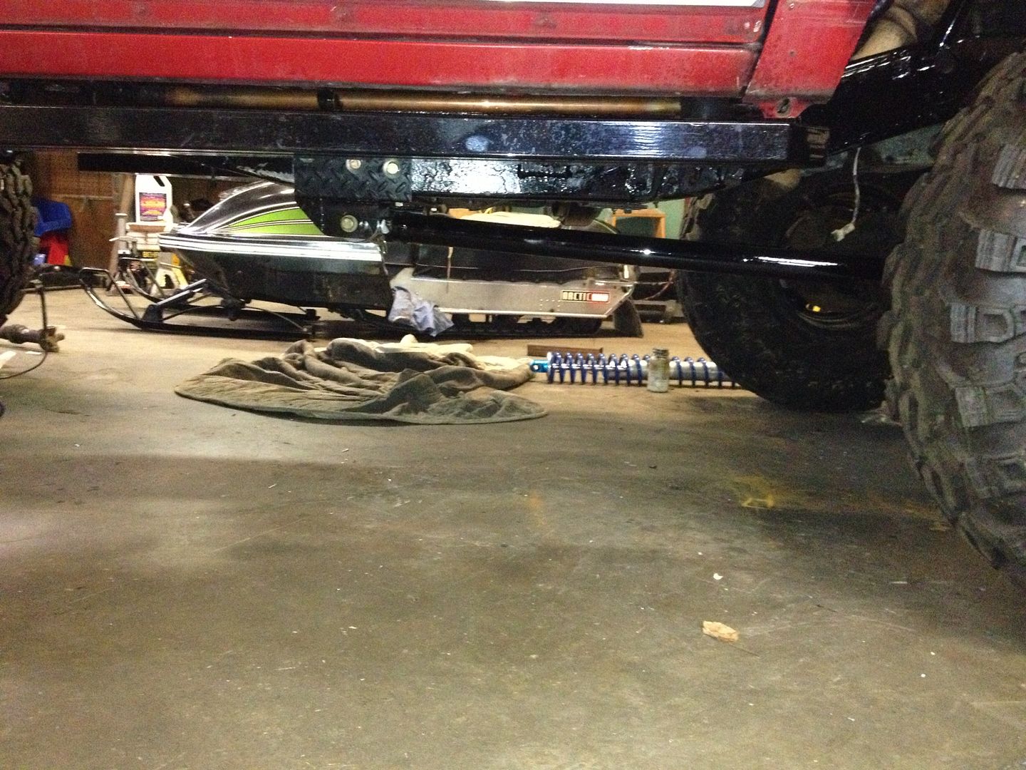

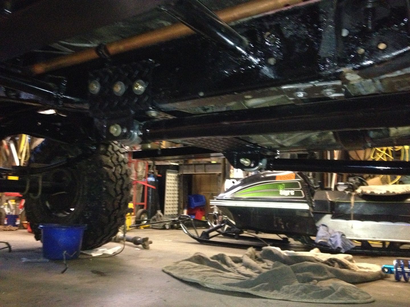

Just need to make the crossover bar and weld up the radius arm mounts at the frame and looks like she ready for coils.

Going to move heims to other mounting hole to push axle forward another inch. Need to build the crossover for the hoops and mount the track bar.

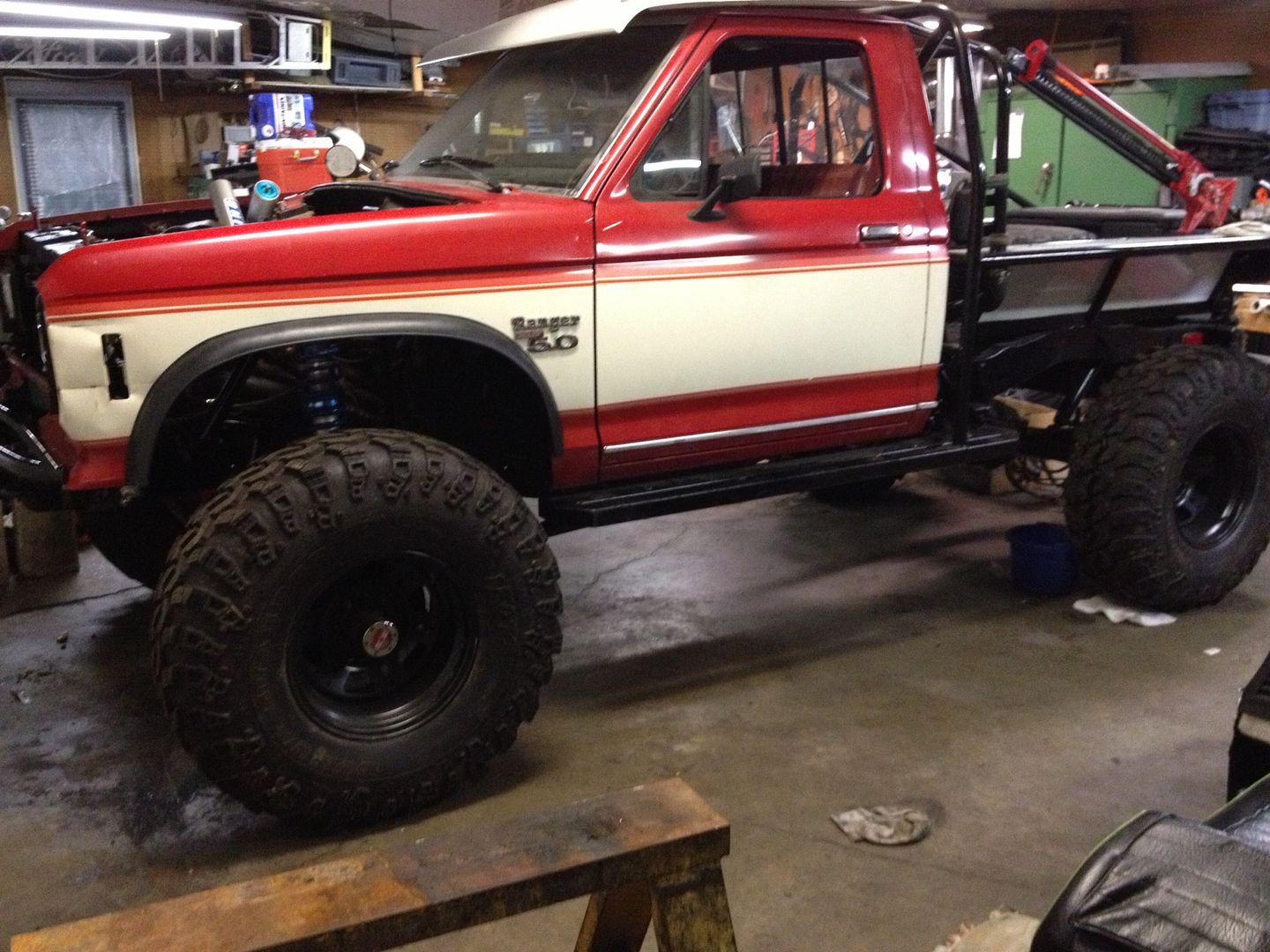

Looks awesome! When will it be ready to come out of the garage?

Im going to roll it outside today and get some pix. Still have a bunch to do before I can drive it tho.
