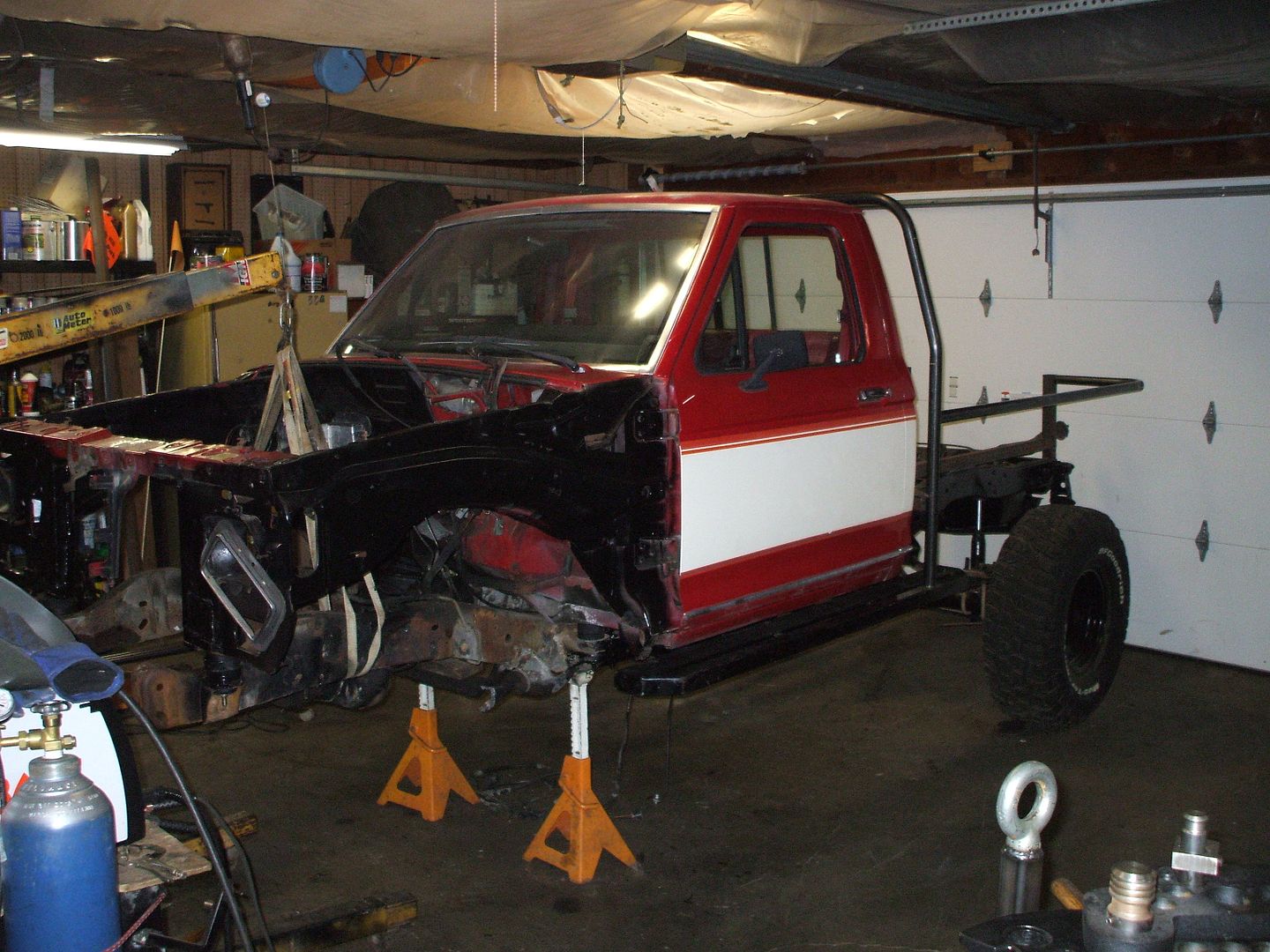

I had to cut out bottom of core support for winch clearance then I had to rebuild the area around the body mounts on the passenger side from battery acid damage. The whole corner under the battery tray was gone so I made some patch panels and rebuilt that area also.
I got the 2" bodylift finished and cab bolted back down and mounted up my rocksliders. Started bending tube and got the main hoop in and the fender tops.
Took some time to think the rest through and added my brace for the main hoop then started running tape.Spare tire will get mounted in this location.
I made hoops to go under the rear of the fenders for my tails and have trailer markers for the side of the frame rails.
All the manual brake crap is off and all the 2wd suspension is cut off, all clean frame up front.

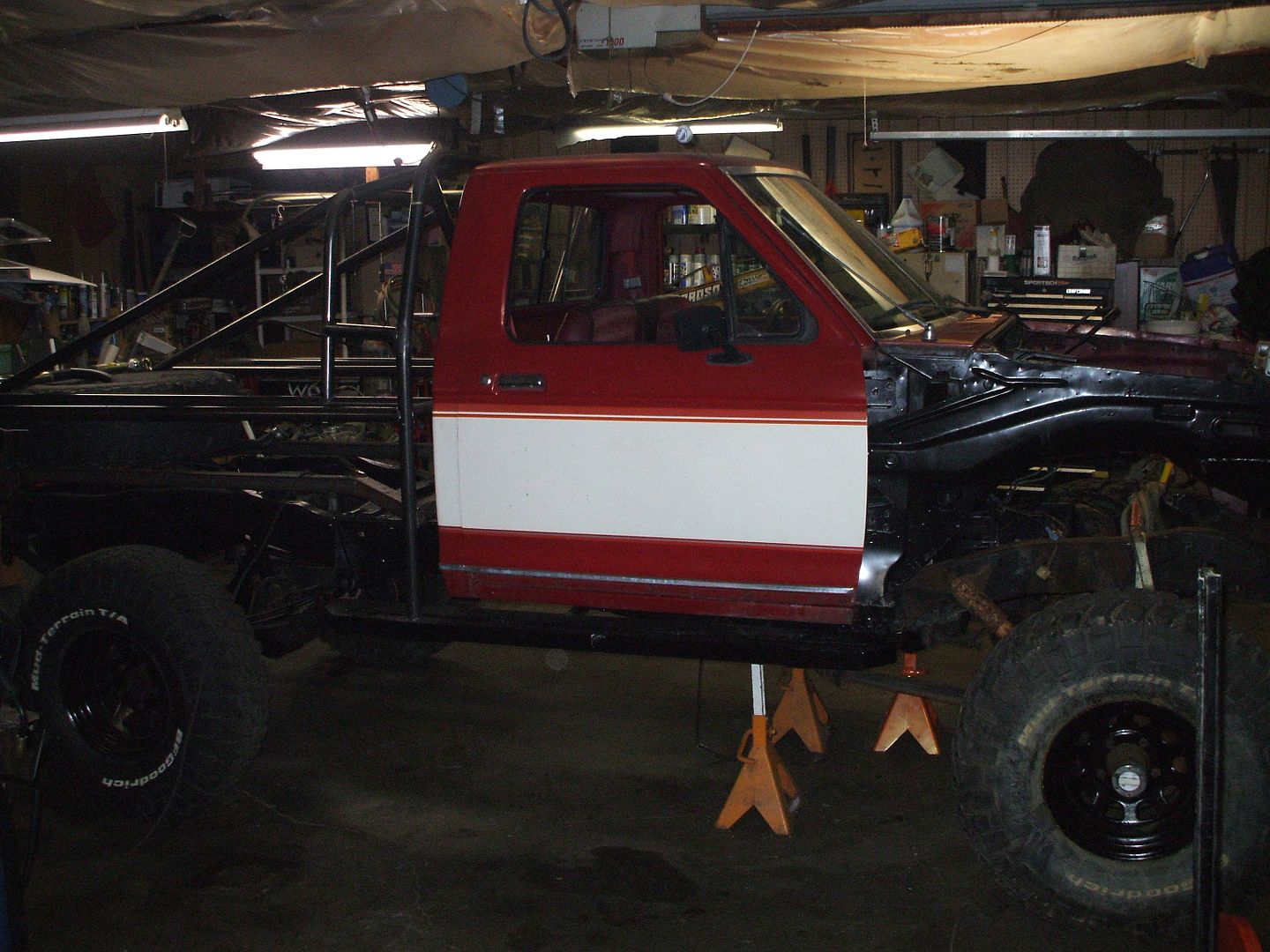

Spent a good 8hr cutting,notching,bending,welding and scratching my head today. Yes Im that slow.Its my first cage so piss off. lol

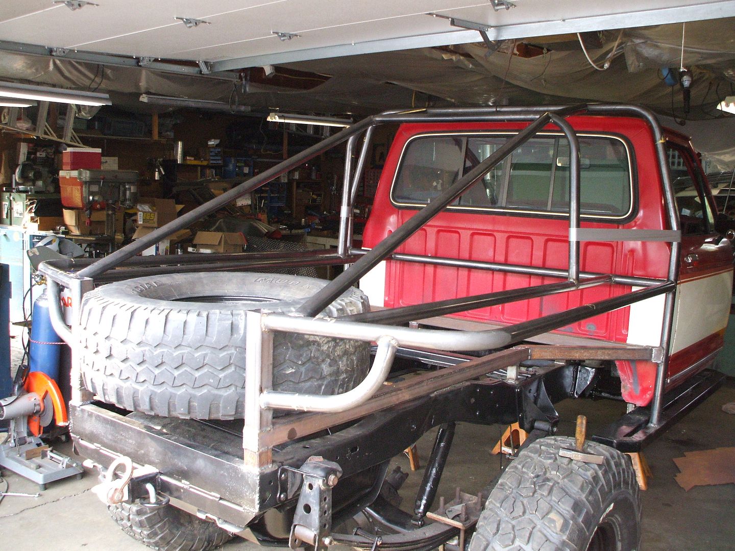

Got rear braces/tail light hoops in today and have filler panels cut. You can see the 80º bend of the fender tube in this pic. I hate how the other pix make it look like its just a square bed.
The two outside tubes will make up the tops of my fenders. Added a second hoop that still needs all the other bars added yet.
Should have hoops braced and rear down bars finished tomorrow. I also have my spare tire mount bent up but need some tube inserts and some hiems.
Have filler panels welded in for the tails now also.
Few more tubes to add then I can start cutting aluminum for fender tops and bed sides.

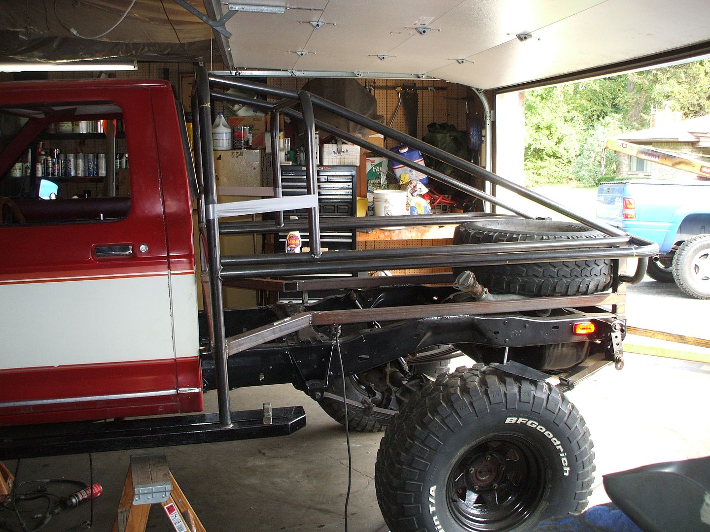

Cage is finished except for some 1" square tubing I gotta add for some braces and bedsides. I also turned truck around so I can start on dropping motor in and building from suspension. I rolled the d44 under to see how much of the stock crossmember needs to be trimmed and to curb my curiosity on what its gona look like in a few weeks.
And here is my tire carrier. Need to add the tabs to the top rails that the pins go through still.
3.5" tube fits in center of rim,plate will hold rim down and the bar tires bedsides together.
Starting on radiator mount tomorrow and picking up all the other tabs I need for mounting aluminum for bedsides and fenders.

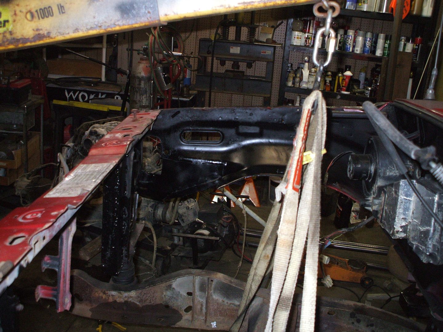

Frame cut to clear headers then plated to restore some strength.There will be more tubing for the coilover hoops goin in so it will be much stronger when Im done.
Had to cut out the stock crossmember since it was only 3" away from axle sitting at ride heigth. Made this one that tucks up much closer to the oilpan and clears the axle alot better.
I also got the winch plate on and finished the core support. Mounted and plumbed the powersteering cooler.

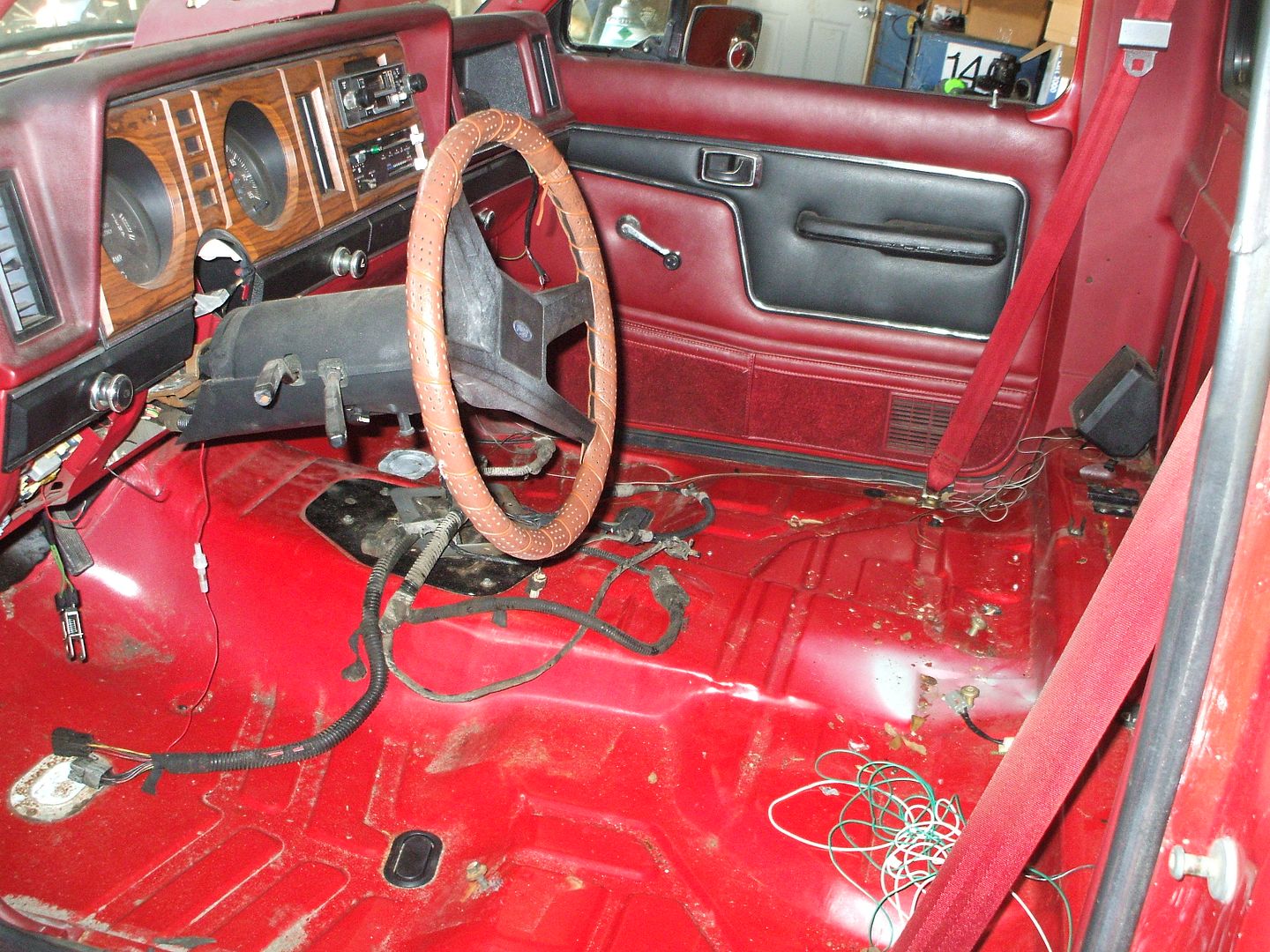

Interior tore out so I can make a cross bar behind the seat for the 5pt belts to mount to and Im doing roll on bedliner on the floors instead of carpet.

Looks good, but where you plated the frame instead of a straight vertical weld you should have fishplated it. Right now the straight weld from top to bottom is now your weak point in the frame...
