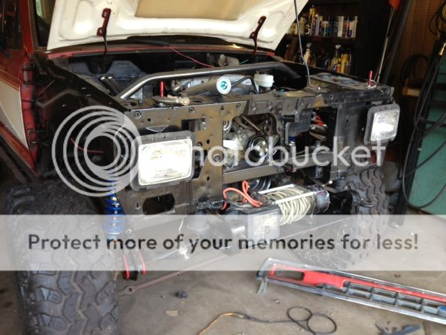

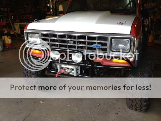

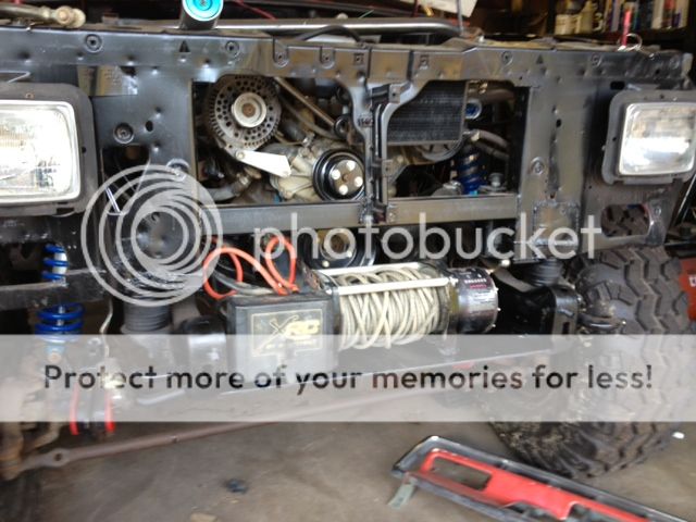

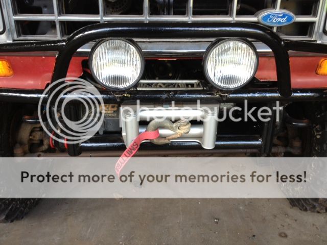

Picked a small but important project today. Finishing the winch. I already had a new motor put on my XR8 last year and today I reclocked the control box and bolted it down and wired it up. Fits just how I wanted it to.

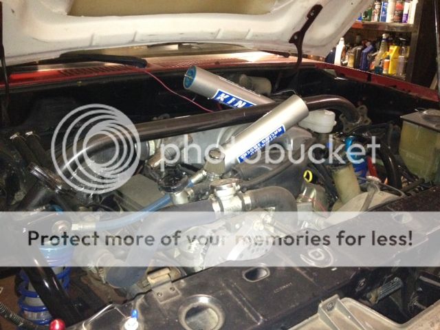

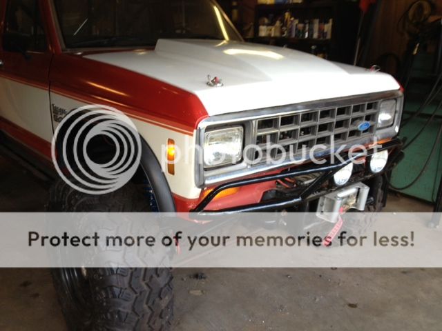

The whole front sheet metal has been just sitting on the truck since I started the build so today I finally got everything lined up and bolted down for good. You can also see I started on the shock hoop crossover today also.
Goin to finish up the crossover brace and get reservoirs mounted in morning along with new/different exhaust manifolds so I can finish steering.

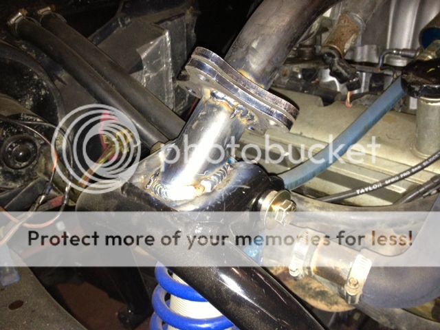

Decided why wait for morning! Check another thing off my To Do List.

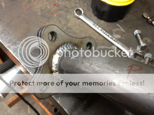

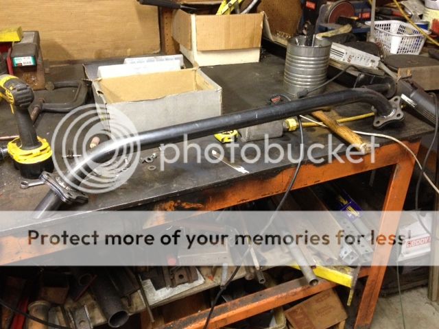

Whipped this up tonite..

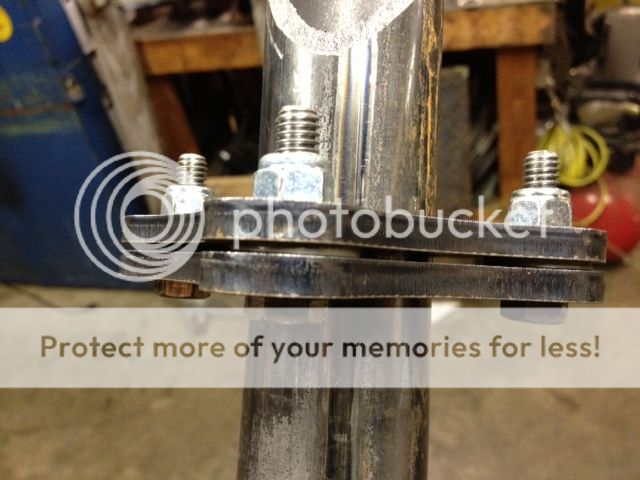

Welded the flanges on bolted together with washers inbetween each flange.
Then welded them to the hoops.
Then I removed the bolts and the washers fall out.Now I just run the sawzall inbetween the two flanges.
Then I painted and bolted everything together.Just used some worm clamps on the reservoirs for now.

That's a pretty trick way of making sure everything lines up, I like it. :icon_cheers:

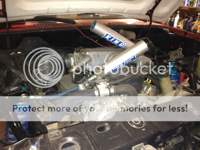

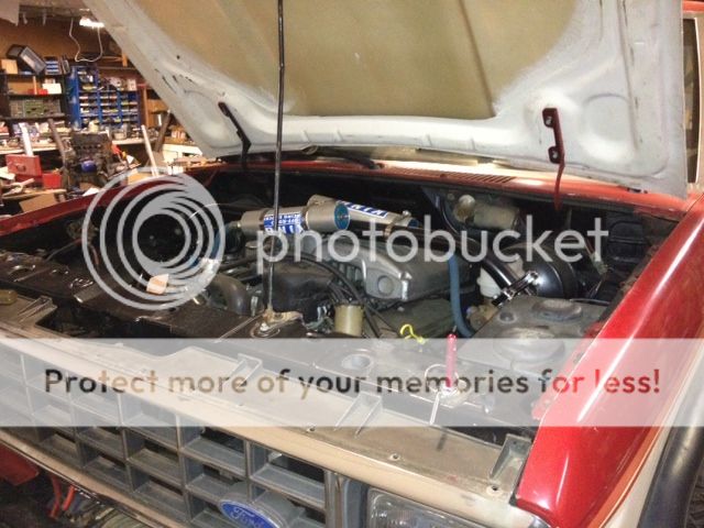

Welded up a mounting bracket on frame rail for oil filter mount,made the oil lines from engine to relocation adapter,came up with a decent air inlet setup with a K&N filter,started pulling current headers off and have engine harness laid out on table to cut open and make it fit this truck a little better than it did in the Bronco2.

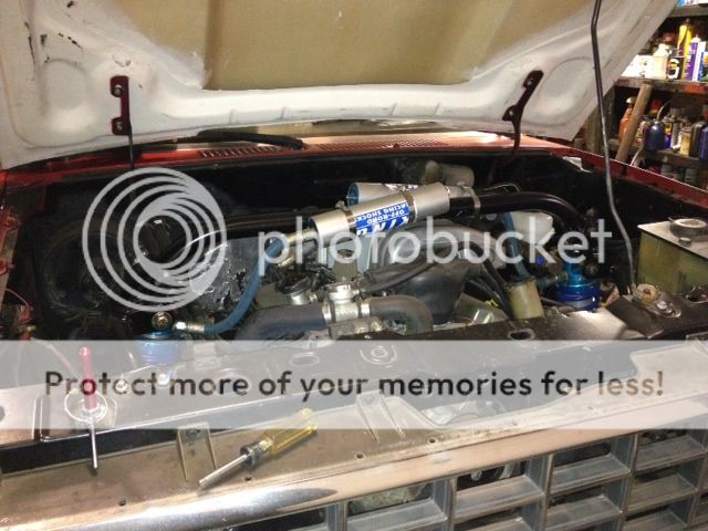

Pulled the BBK headers off and swapped on the cast Explorer manifolds. Building my Y-pipe gona be alot easier now,have tons of room now for steering shaft and I had to re-do my plug wires to fit differently because of how those manifolds are made.
Got trans lines all plumbed and hooked to cooler along with vac line that I had forgotten all about.
