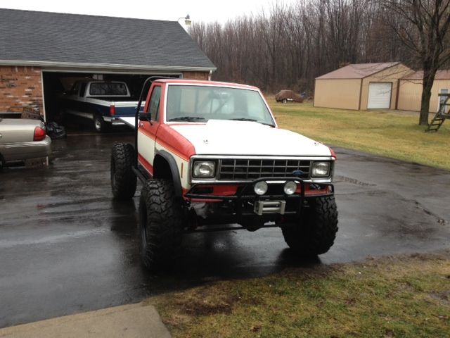

Walker Flexas Ranger.......yes another one!
Still working on steering but it rolls!
SCHweeeet on all counts! Interior too--glad you kept the "Porno Red", and ditched the 70s faux-woodgrain plastic schlock, lol. :icon_thumby:
Wish I could drop RED seats and matching door panels into my black truck... Krylon? :icon_idea:
Looking good!
SVT
Hooray for projects that make it out of the shop!
looks awesome man. now go beat on it.

how much does the main hoop on the bed stick out past the top of the cab and the sides?
Across the roof its about 2" taller.Leaves me just enough room to finish the exo with 1 5/8 tubing. The sides you can see dont follow the body line but the lower half sticks out about 2" also.

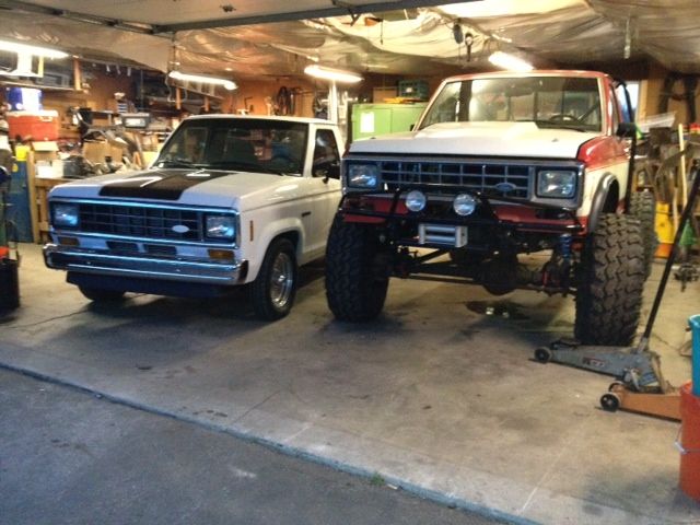

Sadly I havent touched truck in about 2months though. Been busy with my turbo truck lately but in the next week or so I will be back at this truck and hope to have it on the road very soon

Update for new parts.
Been on a mad spending spree lately between both trucks but here is the new toys for the truggy.
Got my D&D doubler. Going to replace the stock 4 pinion planetary with a 6 pinion
I also picked up my disc brake brackets,a 9in axle brace,bought a DTS 31spline spool and a 9in pinion guard.
And picked up some Explorer manifolds that will take care of my steering shaft issues. My BBK headers were in the way of the steering shaft so these manifolds will give me all the room I need now.
So as soon as Im done with the turbo swap on the other truck I will be jumpin in with both feet to get the truggy done.
