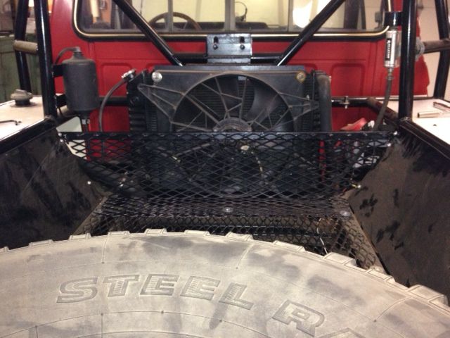

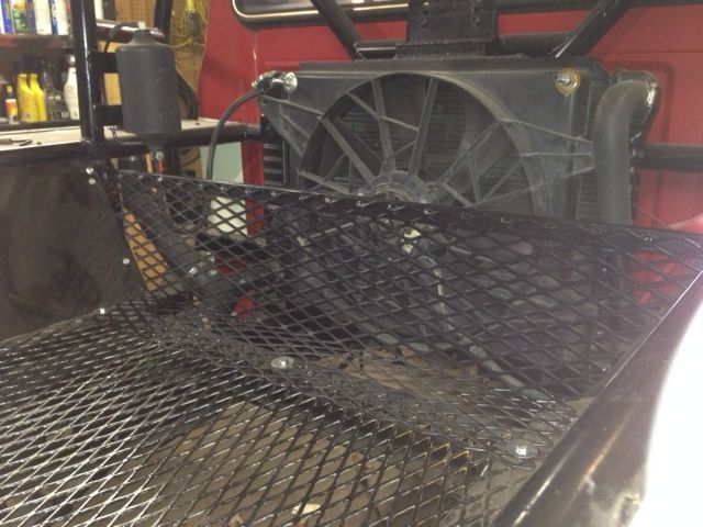

I been working on finishing the bed so I built a removable bulkhead to protect the fan/rad and make the bed actually useful.
