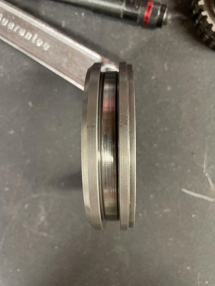

Here's a picture of my old, damaged 5th/Reverse synchronizer slider (36-tooth). You can see the flat surface that's been cut out on the right side of it, whereas the left side retains a bevel. After receiving the new slider I'm no longer sure what version of the M5OD-R1 transmission it came from

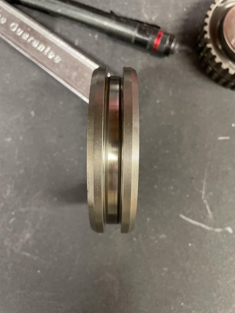

Here's the new slider I got labelled M5R1-15 "early" (36-tooth), which has bevels on both sides. Honestly, it looks a lot like my 3rd/4th gear synchronizer slider

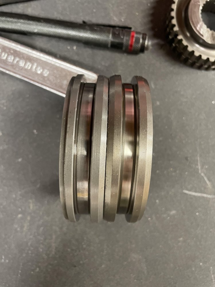

And here's both side-by-side so the differences are more visible
