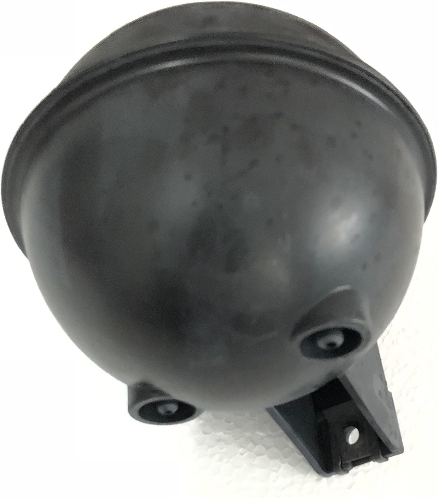

Your vacuum reservoir should look like a ball...
Vacuum lines
These are readily available. It should be mounted on the right inner fender well. It sounds like yours is missing... which tells me you may have issues with the heater controls. I don't remember having to remove the fender liner to get at it. But I'm a grandpa too... and my memory may be off.
