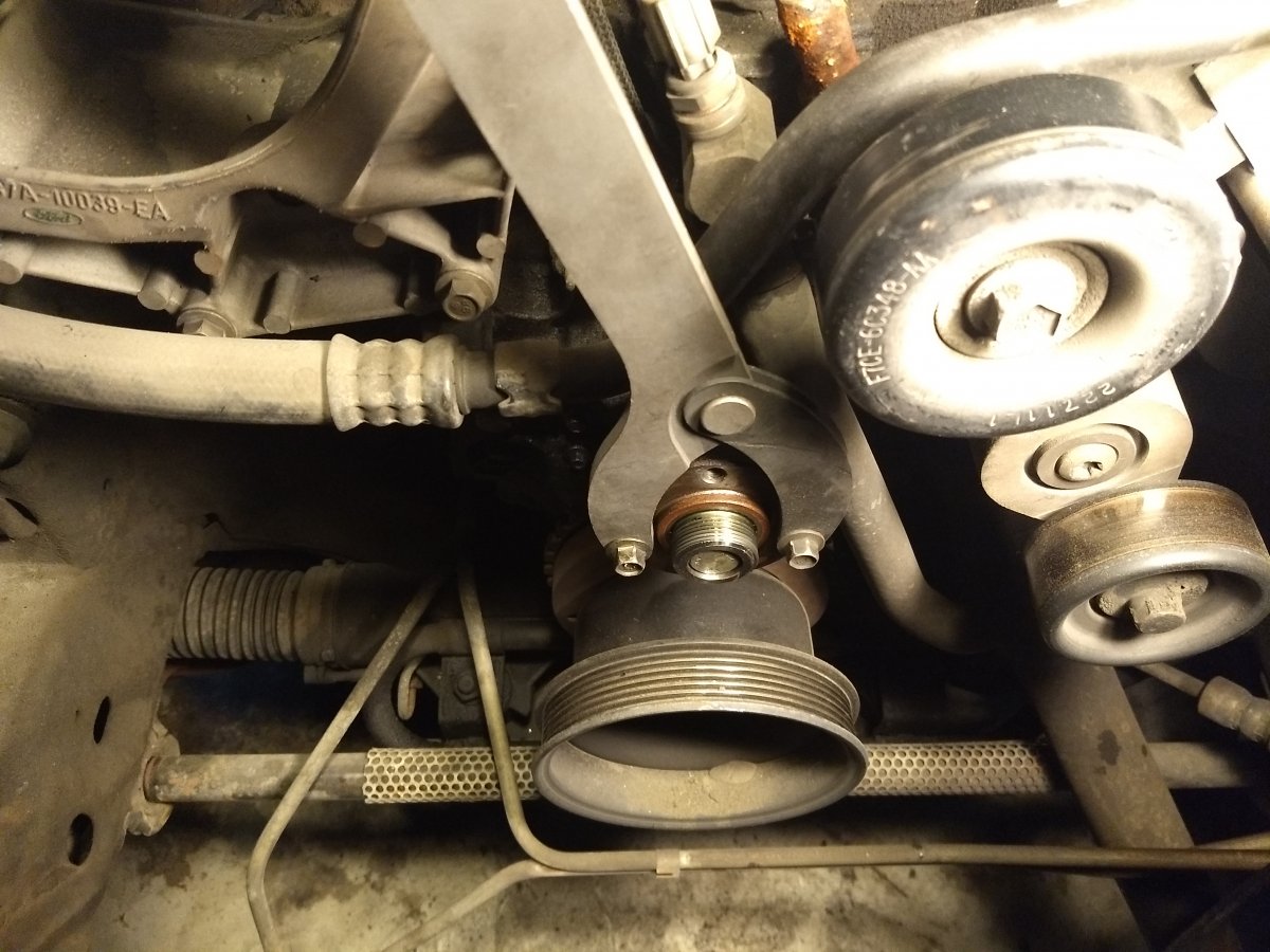

At this point, I already removed the 4 bolts on the pulley, so the pulley was just hanging there, exposing the water pump flange with its 4 threaded holes. Then it dawned on me. I removed my Audi A4 cam sprocket with this counter hold tool. It comes with 2 pairs of screw-on studs, and the screw thread and size match the 2002 Ranger water pump flange EXACTLY. One of the reason I choose Ranger 3.0L is knowing that Vulcan V6 is metric like my Audi(s) -- and it pays off:
1. Use the same screw for the pulley to fasten the counter hold tool onto the flange. Take a bit of finest to get a tight fit.
63851

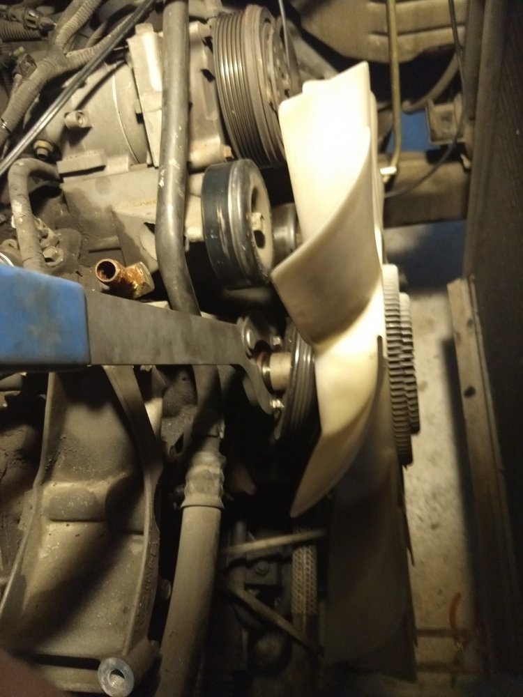

2. Attach adjustable wrench (about 7/8" opening) on the hex neck of the fan clutch. The pulley can be moved around to make space for the wrench:
63858
3. Counter hold tool after fan clutch removed:
63859

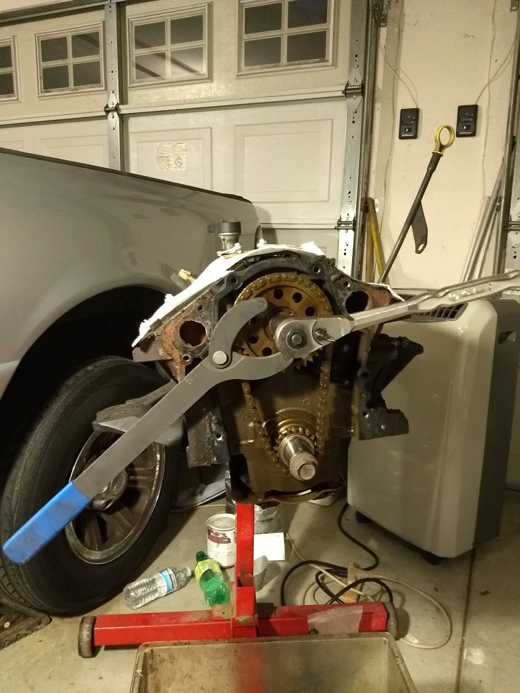

Two more places I used this VW/Audi tool on the Vulcan V6:
Remove and install cam sprocket:
67177

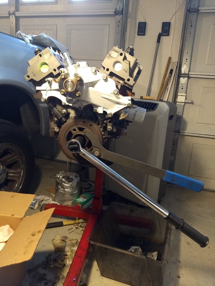

Remove and install harmonic balancer bolt:
67178
