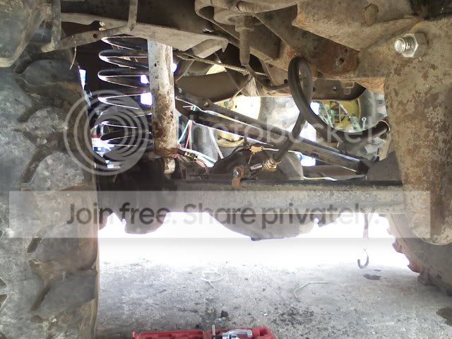

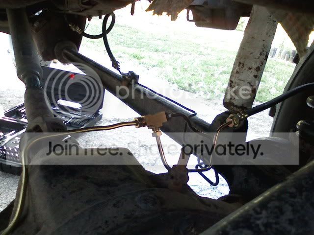

Nice work. :headbang: Could you possibly get me a pic of how your ran your front brake line? Im in the parts gathering proccess on my truck and i cant seem to figure out how to run the brake line. Thanks.
UrbanRedneckKid's Build Thread
I'm not finished but, I rerouted my front brakeline down the driverside frame rail to where my fuel filter is, turned it 180*, then used a rear brake hose from a 95 Caravan to put it down to my drivers side radius arm, then ran it to a tee block, then I used 78-79 bronco front lines/hoses by cutting 6" out of the right side.
I'm still working on the mounts for all the lines though.
Once it's done, I believe it'll be better than two super long, expensive braided lines that would just seem to get caught up in the springs and tires.
I think I have about $25 in the front lines. The Caravan hoses are known to go bad, so finding new ones in the j-yard is easy, and the FS Bronco lines were cheap at AutoZone.
