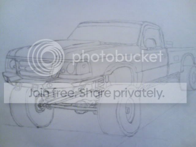

This is sorta what were goin for...

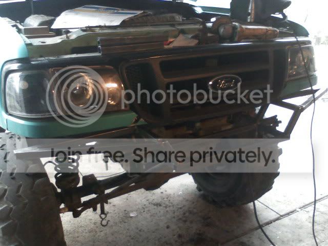

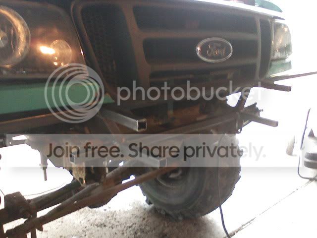

OK, here's what we got so far...

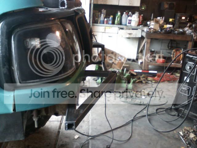

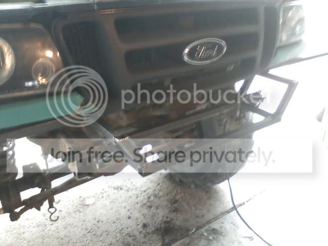

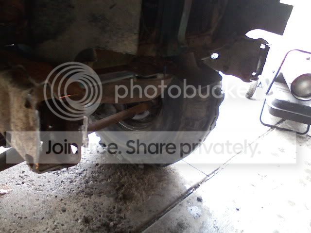

My damn frame is bent! So I'm gunna build the bumper right on the frame. Then cut off the frame horns weld it all up, paint it, then weld the frame back together. This is just the frame work, I'm gunna plate it in sheet metal.

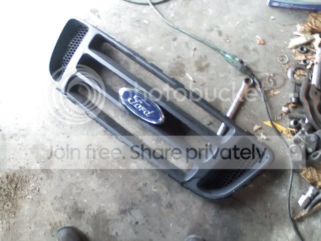

:icon_rofl:I was trying to beat the frame back with a 10lb sledge and the aim was off a little, next thing I know my grill when flying across the garage.

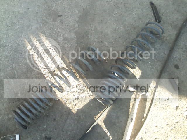

Old coils out, Cage EB 5.5"
Old vs. new Deaver EB 6.5"

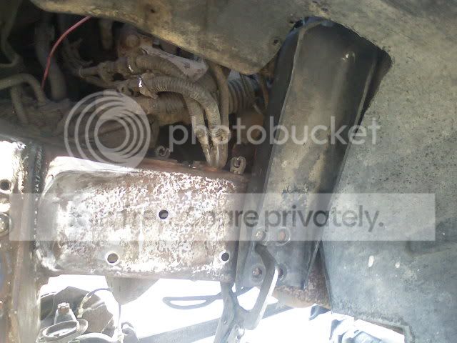

Driverside frame rail stripped of oem coil bucket

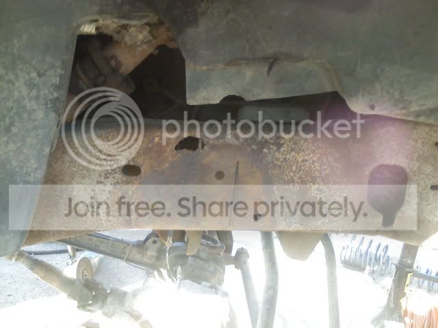

Pass side rail w/o oem bucket, check out my rust hole!!! Yay!:annoyed:

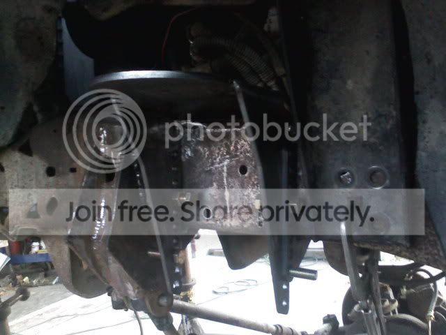

DS shock mount and inner fender trimmed

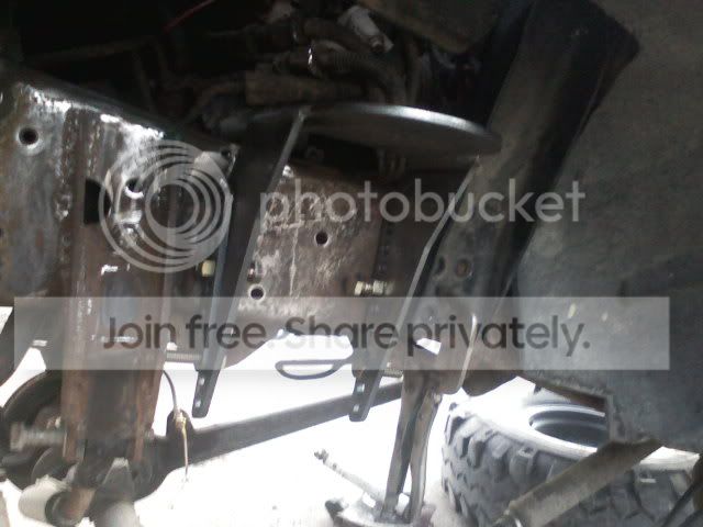

Coil bucket assembled (Ballistic Fab adjustable buckets)
DS completely mocked up, ready to be welded
Once we get a new bottle of argon, The ds will be finished. Then I can move on to repairing the PS frame rail, and setting up the bucket and shock mount on that side, then it's on to the track bar.

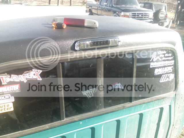

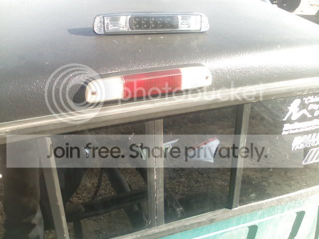

And I finally got a new 3rd brake light, finally matches all my other lights.

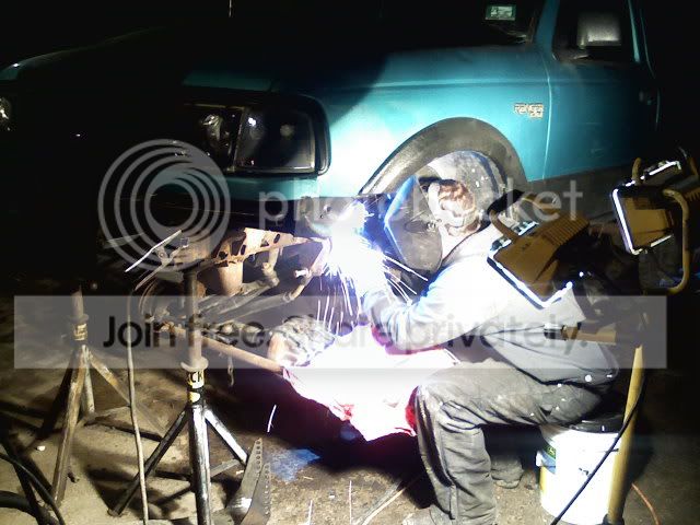

My uncle welding up the mount brackets for my coil buckets.

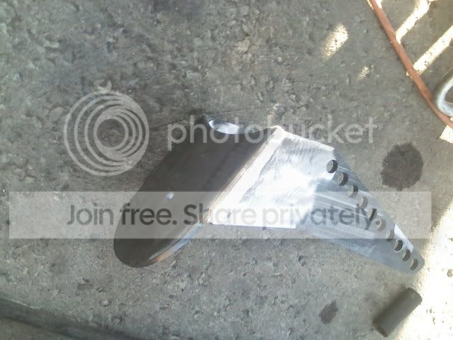

I cut a piece of 3/16 and welded them to the bottom of the lower coil plates to stiffen them, as they are weak and prone to bending.

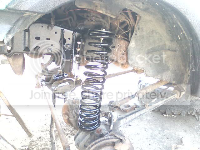

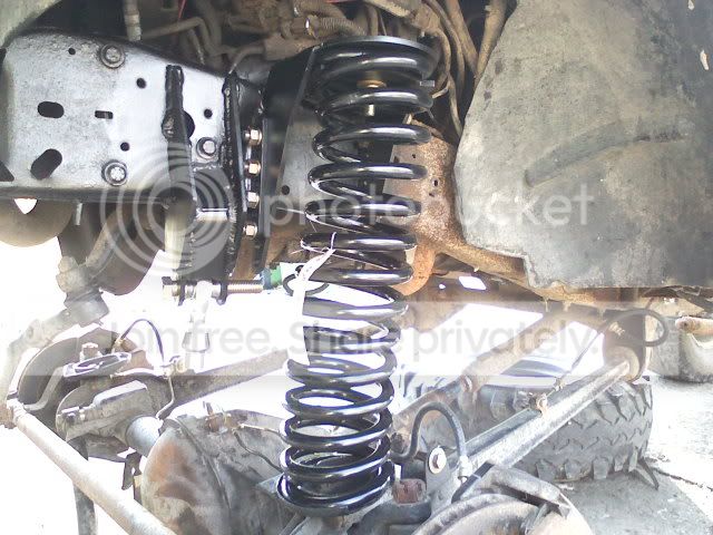

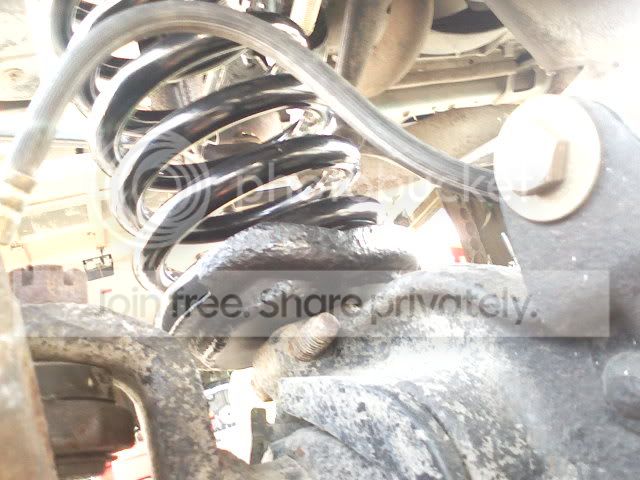

Coil bucket and spring installed and painted
The coil bucket is now set to give 1" of lift over the stock bucket.

Have you considered running heims on the ends of the radius arms?
Those bushings will bind up before your'e out of coil. Some heims on the end otta give ya a few more inches.
Flexy is Sexy!
For a rig that will see a lot of street time, sticking with the bushing ends vs. a jointed end may be a good thing as it acts like a swaybar, eliminating the need for one. I've got over 40,000km on my truck since my build, no swaybars front and rear and it's nearly as stable as a stock ranger.
But a jointed end will give you more flex for sure....:icon_hornsup:
