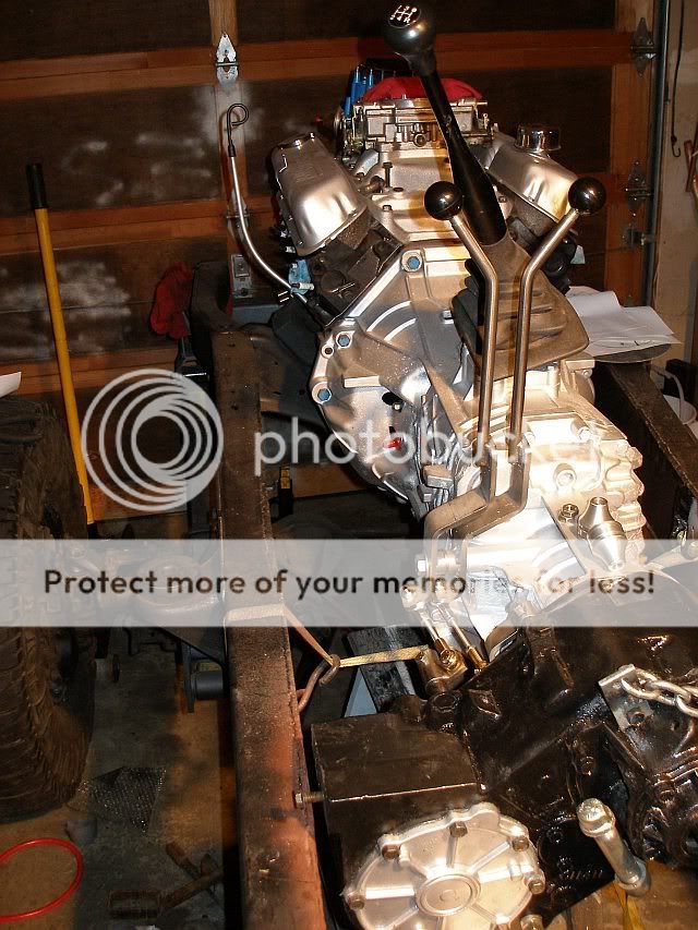

update, zf 5-speed tranny, np205, twin shifters from JBfab, 302, workin on crossmembers
also just got Summit fuel cell, lines, holley elec pump, reg, MSD 6AL box, and more Ballistic stuff for crossmembers
We think alike. That's the same swap that's in the future for me. What I'm really interested in is how the ZF and 205 fit with the cab on.

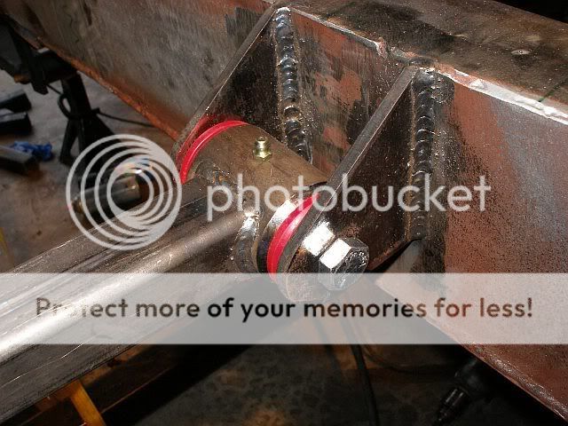

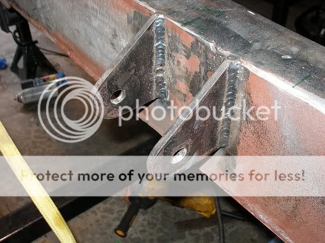

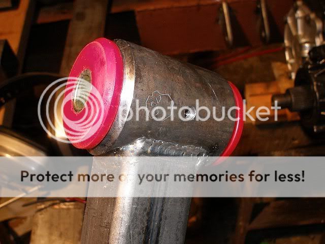

rear side of crossmember done, .188 wall 1.5x1.5 square tube. ballistic fab poly ends/sleeves

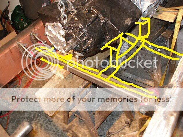

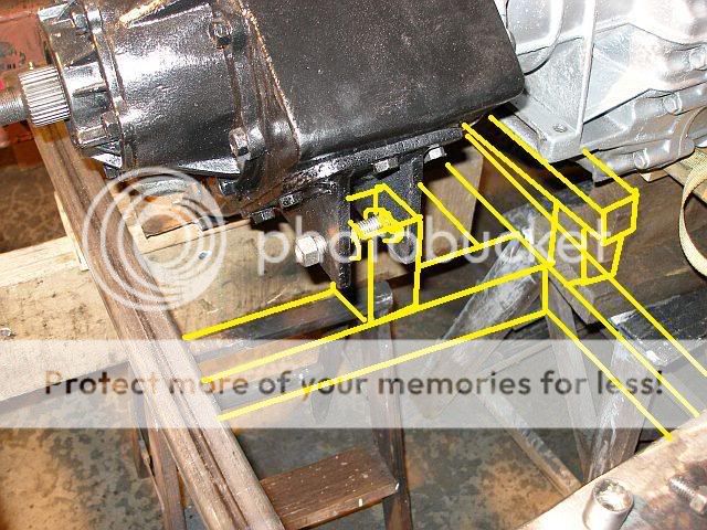

what do you think of that design? its kinda hard to tell but as i build it you will see

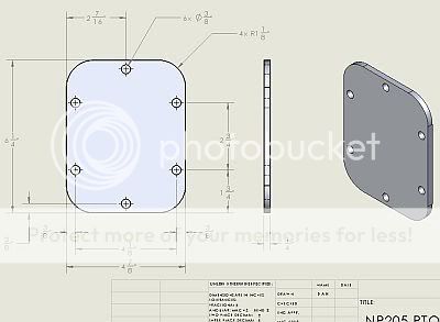

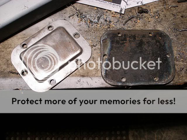

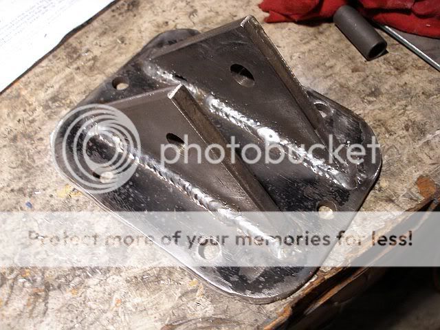

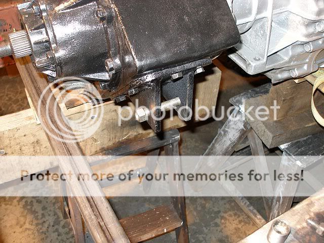

the NP205 Pto cover mount out of .25 plate and 45* mounts .375 thick
i have a solidworks file of it if anyone needs it (or you could just trace over the stock plate i just felt like making it up :D )

Looks like a VERY strong design.
Will you be required to run a body lift for clearance?
mabey, i didnt really want to... i was planning on chopping up the floor and running tube across the sides to mount seets and new floor but i may have to do a slight lift
