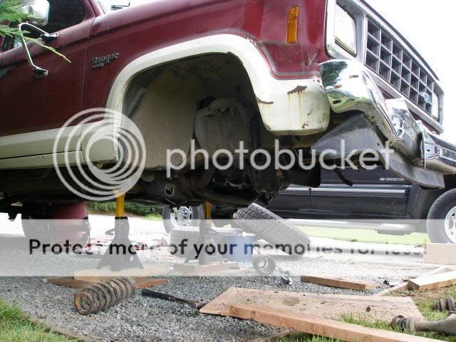

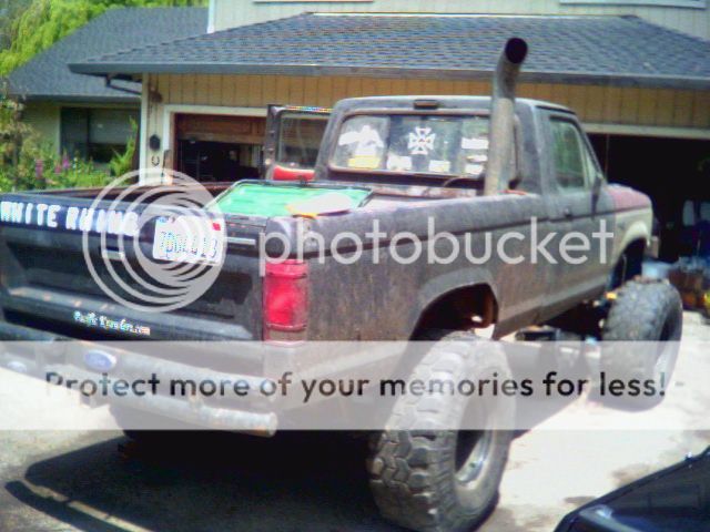

How much lift springs did you put up front ? how big are your tires ? i just sent a picture of your truck to the ruff stuff guy so he can put a kit together for me. well , i mean for us guys here. after your motor and trans get in there .....whatta you thing your headlight height will be ? just trying not to be higher than pensylvania's lift laws. i might have to use a smaller spring.
i used superlift chevy 6" springs... they are a little stiffer then i wanted but i got them for 50 bucks from a friend, those are 36x14.5 inch tires on it now im going to run around a 40 inch tho when im done. i would use some 44044 or the RS44044 if you want a lil smaller. not sure on the headlight highth

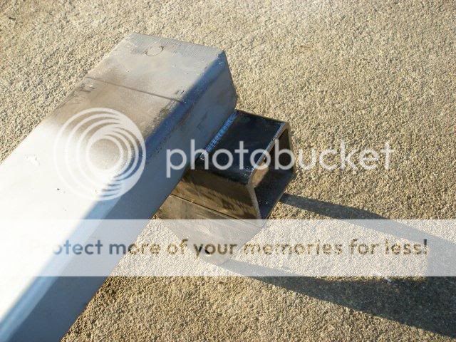

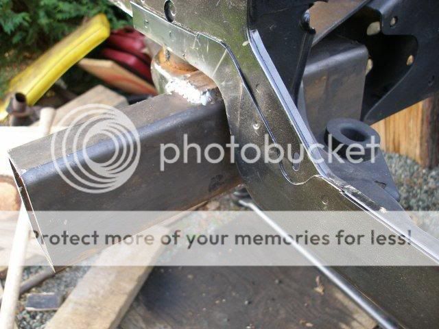

still workin on building crossmembers... in the process of building that Got trikes tube bender... plans look awsome and im gathering supplies for it will post pics on that as i start aswell

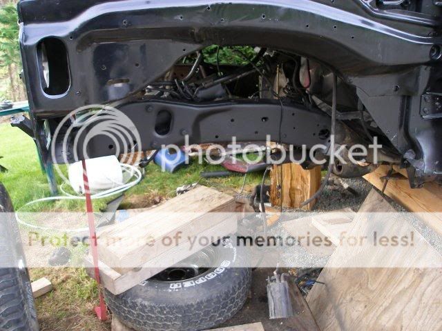

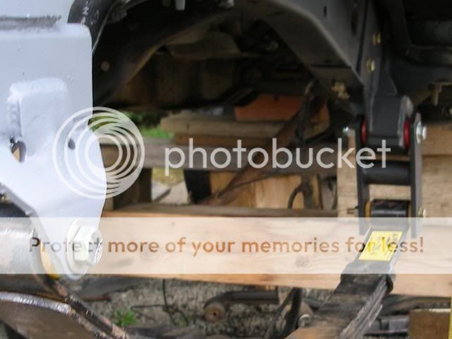

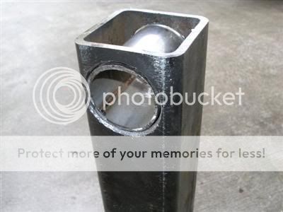

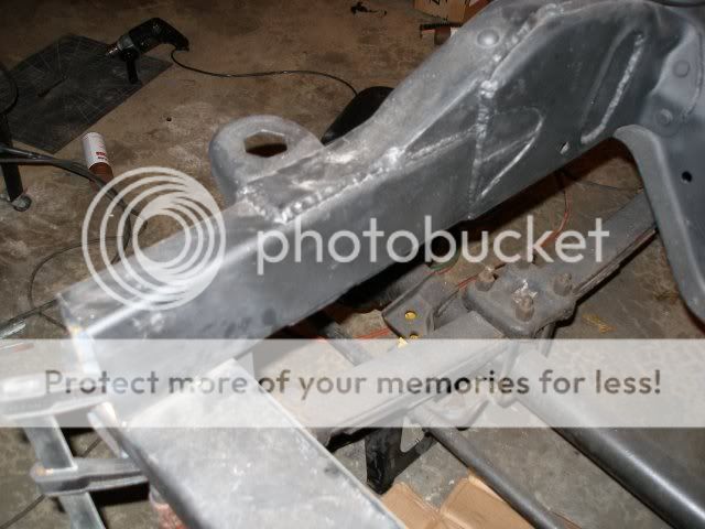

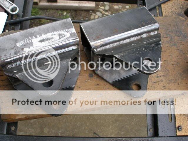

Could I get some pictures of the Front Crossmember, and the Front Shackles. (Basically the front buildup of the truck)
here ya go
it looks a lil better now (its fully painted, frame and body)
it still needs to be gusseted all over the front hanger
i think i made it all for around
100 bucks in metal for front hanger, shackle hangers and shackles
400 axle + 75 machining on knuckle and 100 for ball joints
60 bucks for springs
