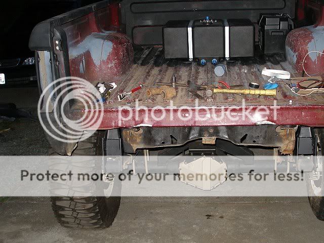

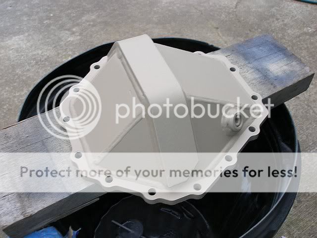

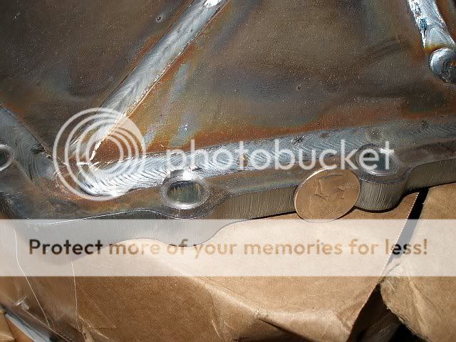

diff cover .5 thick! from great lake offroad

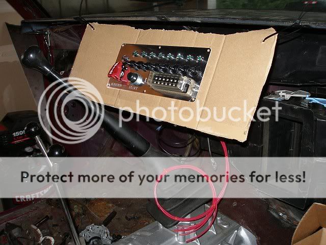

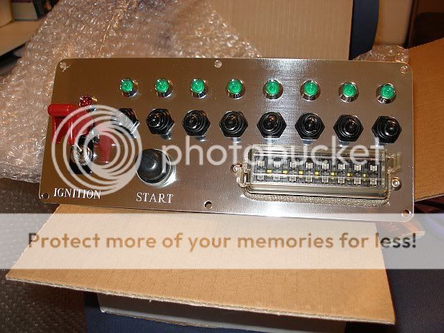

new switch pannel, from 12voltguy.com
in my new sweet dash :D

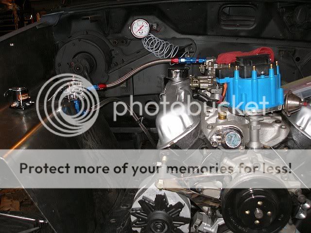

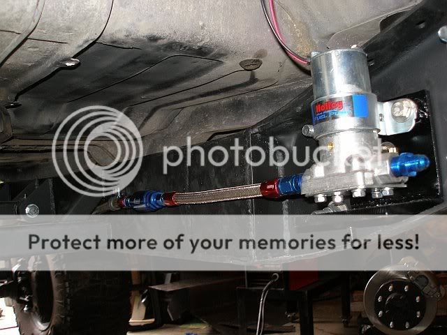

holley blue electric pump, summit lines and filter, holley regulator
wiring it all up, msd 6al, summit 16gal fuel cell, wiring sucks... im partaly color blind by the way :mad: all the wires look the same :D

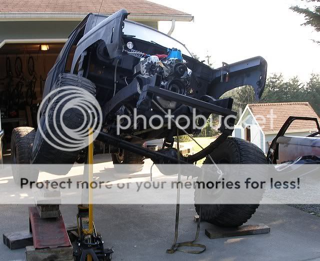

rear springs maxed out, i have the stock shackles and springs on it right now. im going to be putting 63s on it soon

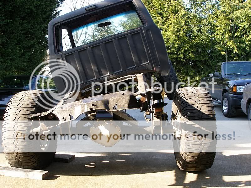

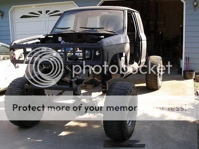

front springs are to stiff... not sure if its that there not broken it yet or what but i may need different springs. im going to wait tell i get the exo cage on then see i guess. i coulda kept goin up but my floor jack idea was a lil sketchy so i stoped. my highlift is broken and my engine hoist is being used so its all i had to flex with . i may still swap in coils and a 4 link

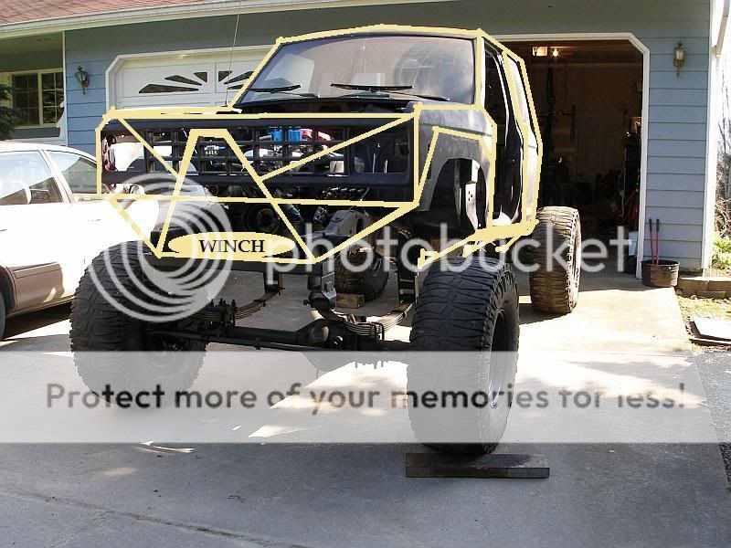

heres one idea for the exo. still not sure if im going to dove the front yet or not. if you think of something better post it up please

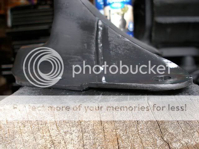

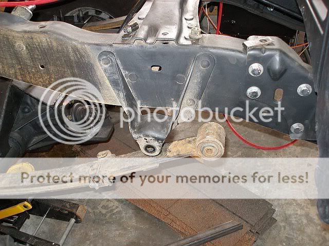

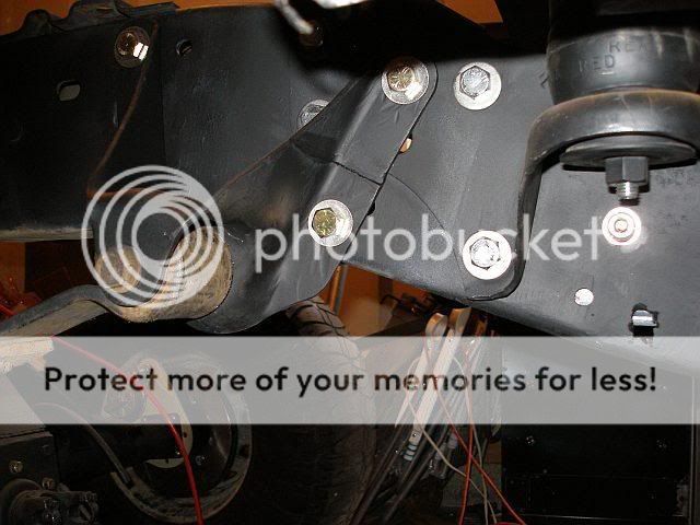

got the chevy 63s on
That is gonna be one tough truck!!

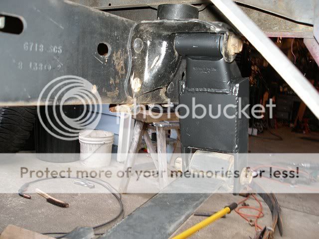

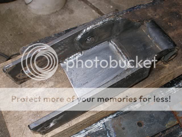

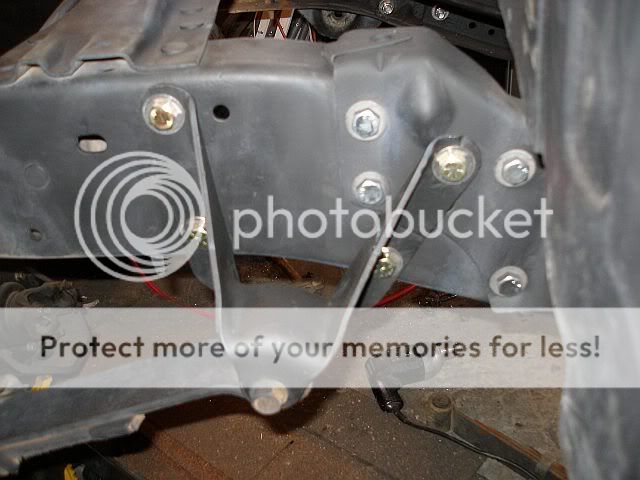

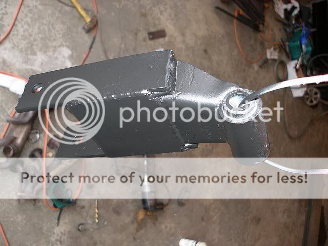

i didnt wanna make new shackle mounts and new shackles so i added to the stock ones for now, the truck finaly sits level now

the front chevy springs suck goat nutz...even in 4 in ez rides. for muddin though it really dont matter, just remove the bottom leafs. 2 in springs work best, but getting the height is a bitch with those for your needs.

put all the front tube under the skin, only expose tube that has to be like around the cab, and make the sheet metel removable for times that require stoooopid. cause stupid is fun:D thats what i intend to do...

as for the front springs yea they suck. as soon as i get some other stuff done to it im goin back to coils that way i can still get the heigth i need
