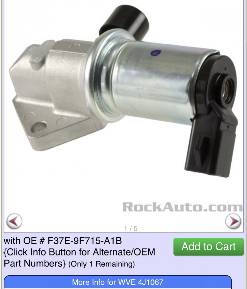

IACs can be troublesome. The El Cheapo $39.95 that Auto Zone sells barely makes it past it's one year warranty, then fails. Went through a bunch of those. Finally, one day, saw that AZ has a "Premium" IAC, made by Hitachi of Japan. Costs double (bit over $70) what the el cheapo part costs, but haven't had to replace it since 2015. Also put one in my Lightning the same year.
Hitachi is the OEM maker so yes, best to get that if you don't get a Motorcraft. Same with MAF sensors.
That I didn't know. Good to know.
I wish Rock Auto listed country of manufacture in their descriptions. The cheap one didn’t look specifically designed for this vehicle, but made of universal parts for ease of manufacture. I’d describe it, but the pics will do a better job. So I counted that one out and went to the next cheapest that made shipping make sense. It was Standard Motor Products I ended up with... and it had the heart by it.
