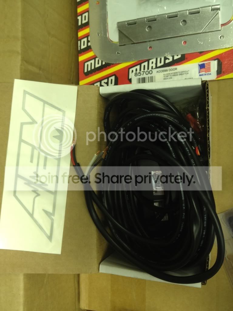

I got my fuel system ordered and plumbed. I put the fuel cell where the spare tire used to sit. I like how the AN fittings ended up visible from behind the truck.
AEM Wideband controller

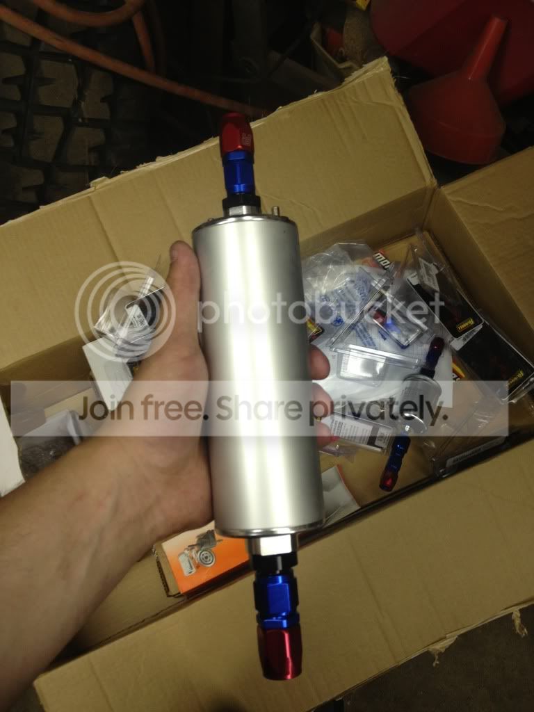

Inline fuel pump.

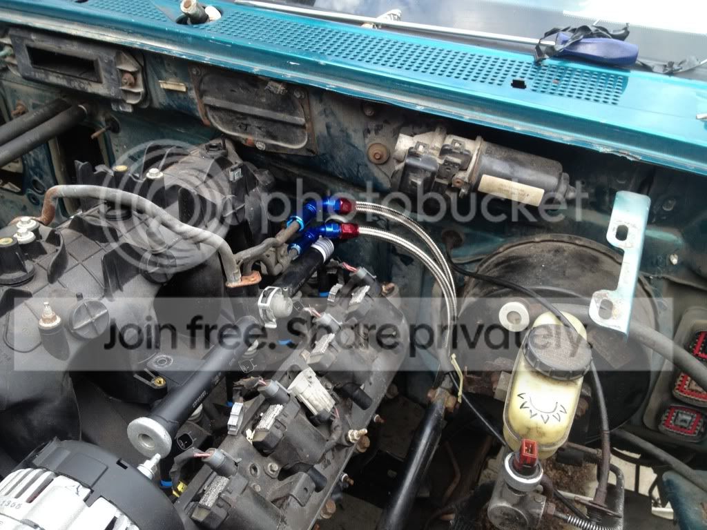

"Unnaturally Aspirated" LS Ranger
Russell makes AN to LS fuel rail adapters.

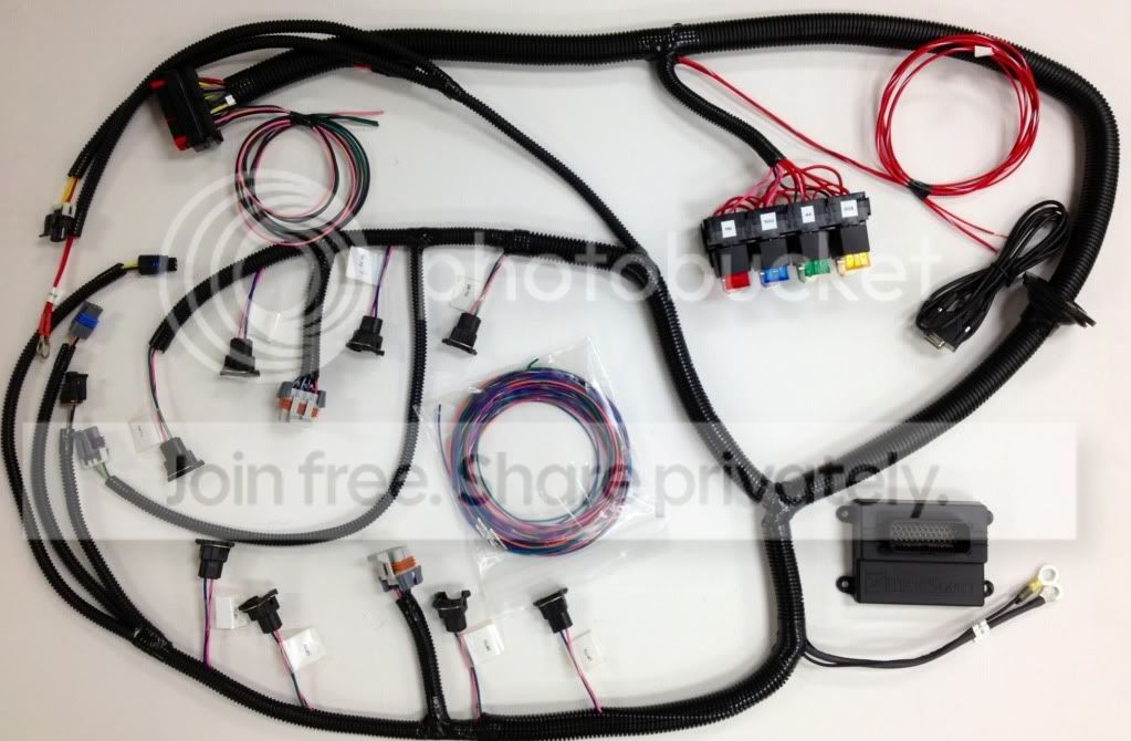

My harness and ECU is ready to go. I sold the MegaSquirt and went with a MicroSquirt setup. The micro fits my needs better.
