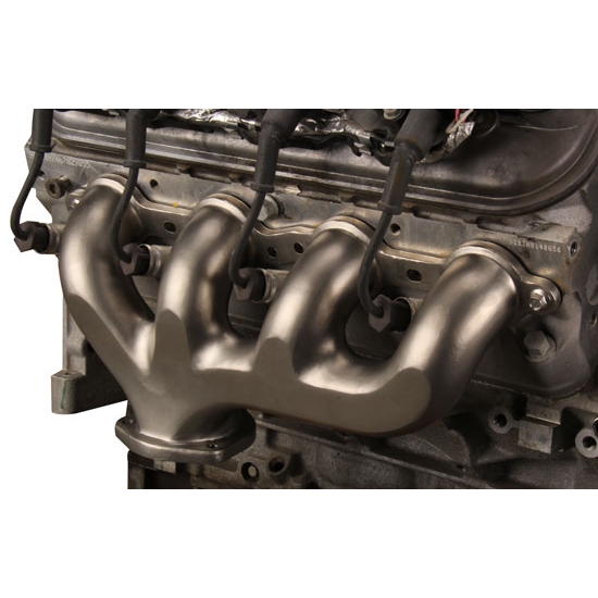

if you roll about 1 inch out of the frame rails the e-rod type manifolds look perfect and according to spec fit awesome....http://www.jegs.com/p/Hooker-Headers/Hooker-LS-Cast-Iron-Exhaust-Manifolds/1918563/10002/-1
i dont see too many issues.:dunno:

great pics here with various applications. http://www.holley.com/8501-3HKR.asp
this style flipped for twin turbo would be cool looking too....
anyway, like the stock truck manifolds the hookers are supposed to be really nice to cut and weld. i seen the cut and reworked manifolds in a ranger(strip application) and several other vehicles at koh last year.
