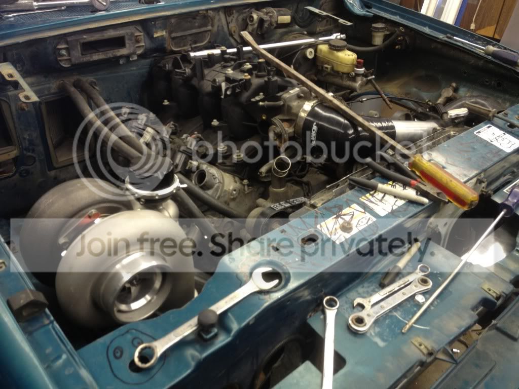

Here's a shot of my crossover pipe tacked in place. It runs down under the balancer and up in between the heater hose outlet and frame rail. Now I need to decided exactly how I want to merge the pipes into the turbo. I have it planned out it my head, just need to see if it transfers to the real thing.

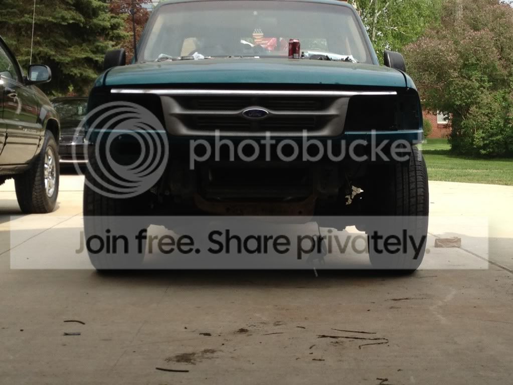

There's actually a ton of room between the grill and core support for electric fans. I need to recess the radiator to give more room for the IC piping but so far it's fitting.
The intercooler fits nicely behind the grill as well.

Did you have to do any trimming to the grill to get it in there
I didn't cut the grill at all. I cut out the center piece of the fiberglass header panel and a little of the side supports for the IC piping.

I made my turbo mount and finally got a good portion of the passenger manifold made. The hot side is done just needs final welding. The cold side is done after the IC just waiting on a 90 degree reducer for the turbo side.

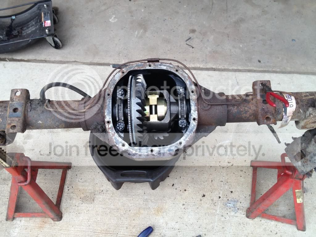

I found a cheap explorer 8.8 and installed a mini spool.

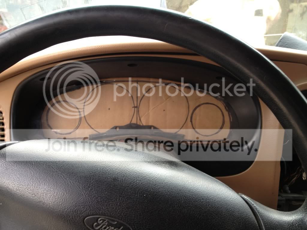

I took apart the cluster to mount gauges to it. This is my cardboard template. I'm going to use some sort of plastic. It screws right into the back half of the cluster which mounts to the dash for a nice clean look.

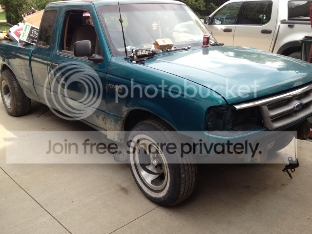

I was also measuring for a driveshaft. It's finally sitting outside under it's own weight and the hood actually clears everything surprisingly.
It looks so unsuspecting, I love it. My friend is also giving me a fiberglass capper for it too hahah sleeper status.
That is sweet.... Total sleeper status for sure. Are you going to lower it or raise it at all or keep it that way
It'll be stock height for a while just to add to the effect of someone getting beat by a ranger. :icon_rofl:
Next winter if everything goes as planned, it'll be getting cage work, beams and 4 linked. I miss my prerunner. This will just be a better and faster version. :icon_thumby:

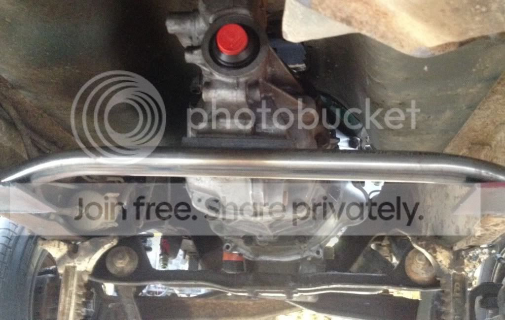

Last weekend I built my trans crossmember and mount. Also measured for a driveshaft. From the trans output to the axle drive flange is 70". The place I always go to says for that length and RPM I need a 5" to be safe. Rather than trying to modify the fuel tank to clear, I'm just gonna order a fuel cell and be done with it.
