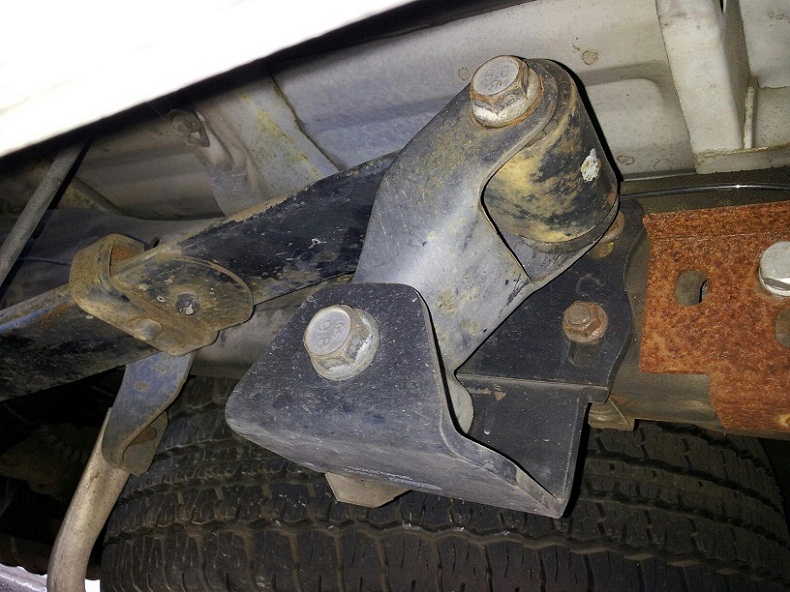

So I have a Mazda b2300, I really love it but I bought it lowered and I have been driving it that way for about a year. I would like to use my truck for... Truck like uses, towing, light off-road, bug outs, camping etc...
Problem is I have 0 stock parts to swap back on. I looked under and I have an Eibach lowering kit on this thing.
I guess my #1 question is, can I flip these Eibach hangers to re-gain height in the rear.

well I dont have any pics at the moment... Im not exactly sure why they would help though. I have an eibach lowering kit, Im asking about the rear hangers... can I flip them, or has anyone done it. If not I'll flip them and see what happens.
I figure flipped since the stocks flip these would to, and worst case I may need to grind a locator tab off or something...

Get stock hangers and bolt them on. That's at least a 3/4 drop on there.
You should be able to flip the hangers around and reuse them.
There might be clearance problems if he flips those hangers. They are lowering hangers.
Ya, those are definitely aftermarket hangers, you can get factory ones just about anywhere, then just flip the shackle where its supposed to be, and bolt it all back together.
