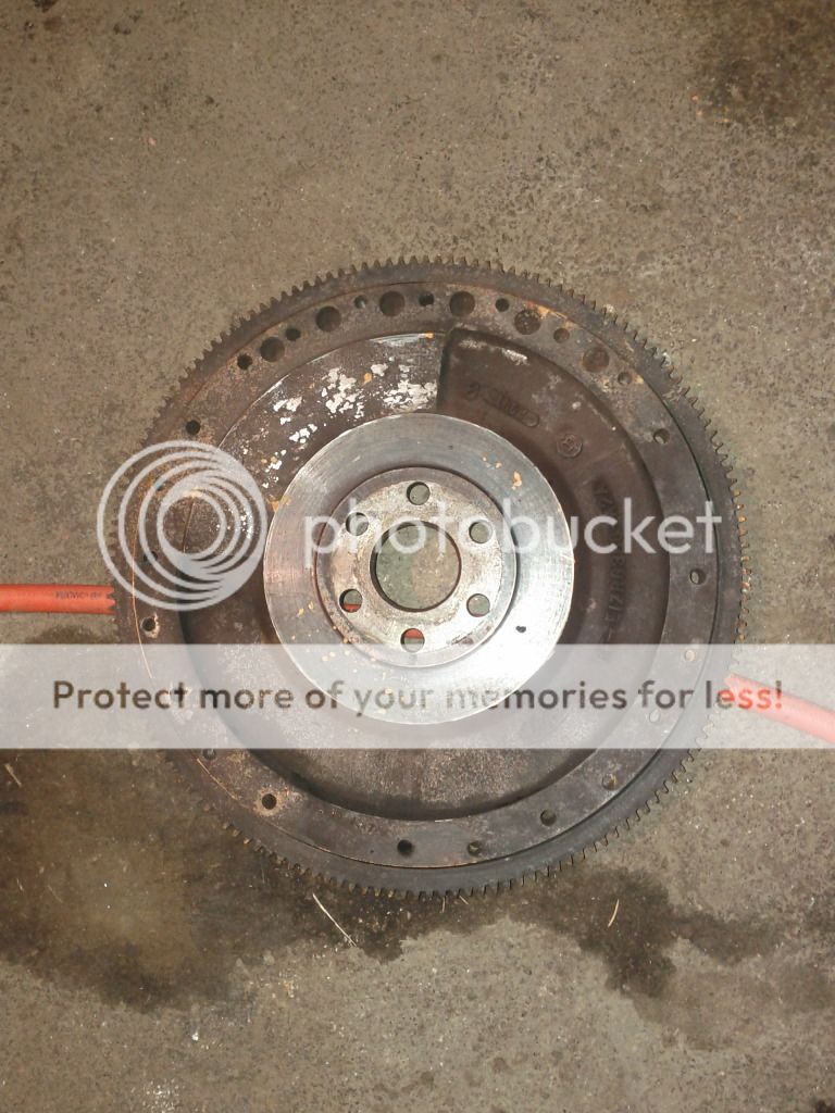

I am going to pull the flywheel, if it has numbers on it and points towards a 50oz one, i am just going to get a flywheel for the year truck i got my tranny from.
WOOT! I passed 1k posts.
Well i pulled off the flywheel, it appears to be a 50 oz one. So i should be able to buy one for the year truck my transmission came off of.
Another thing, how do i tell if i have a reverse rotation water pump and timing cover? I need to replace the front seal and dont wanna get it all put back together and have it turn out i have the wrong cover.
If i follow fords casting number scheme, my engine is from 1980, the flywheel from 1981 and the balancer is from 1982 :icon_confused:
Here is the flywheel

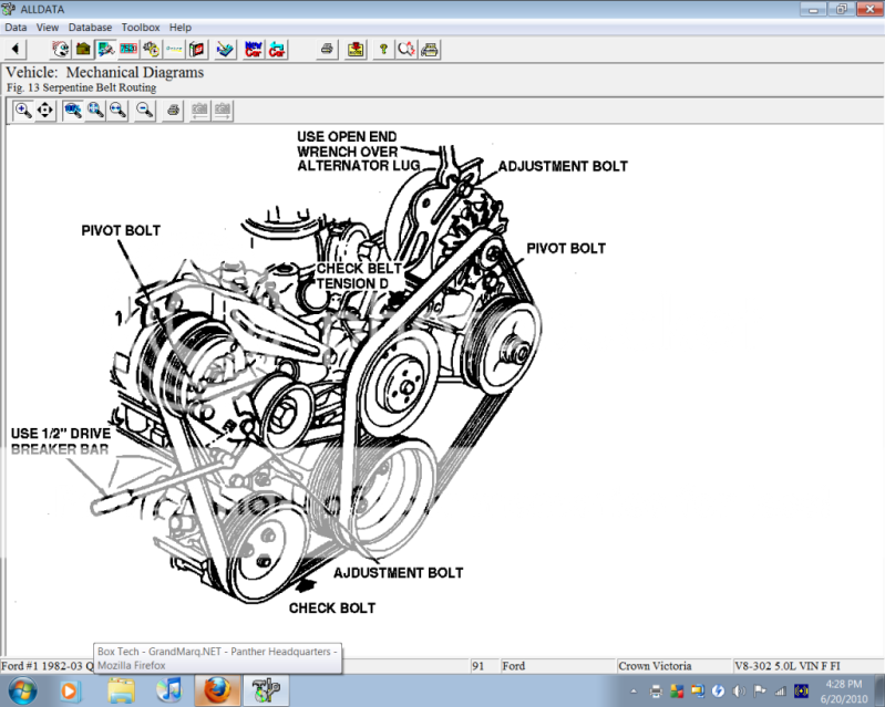

Standard rotation with the WP turning the same direction as the crankshaft, 1987 Crown Vic style FEAD my engine came with (and I ran for a year):

Reverse rotation with the WP turning opposite the crankshaft (Explorer FEAD minus the compressor in my truck)

Yours looks like a smooth belt that runs opposite from the crankshaft, reverse rotation. You might check it against Foxbody Mustang stuff to see if that is the FEAD it is.

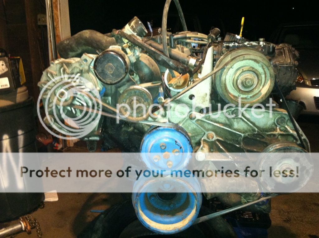

Heres a pic of the front with all the accessories on it still. When i bought it my friend said he swapped on an accessory drive from an 84 or 85 mustang.
So is there a problem with running a reverse rotation wp? I want a simple FEAD, all i need is alt and p/s.

Nothing at all wrong with a reverse rotation.
I wonder if you could just yank the compressor and get a shorter belt, might check into what a 84-85 non-AC Mustang had for a setup to see if it is similar to what you have just minus the compressor or if it is a completely different thing. Shane96Ranger is a big Foxbody nut, you might drop him a line and see if he has heard anything about how to do it.
The late 80's CV setup (also used in a bunch of other big boring cars) in the first pic of my last post is about as simple as simple can get for the basics. One short micro V belt (more traction than just a V belt) runs on four pulleys, crankshaft, WP, PS pump and alternator. All you need is a water pump, pulleys, and one bracket... no tensioners or idlers. You can reuse the stock PS pump and alternator (although a pump with the return out the back instead of diagonally out the bottom fits better)
All you would be giving up though if you could just delete the compressor on yours is the tensioner... and a tensioner isn't really a bad thing to have vs guessing how tight the belt is as you crank on the alt with one hand and try to tighten the lockdown bolt with the other, and repeating that process a couple times until you get it right (at least that is how I did it)
